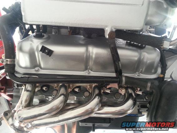

My set up does
At least the noisy part, not too much on monster horsepower gains.

JBA short headers,
With a Flowmaster 40 series with dual pipes dumping right out of the muffler.
I am planning to switch to a different muffler brand soon.

Yes cat still on, but a tight fit.
