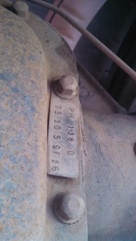

I checked the tags on the differential itself:
I'm assuming it's a 3.73 because of the 73... But it's missing the first digit and the identifier that says if it's a Limited Slip or not.

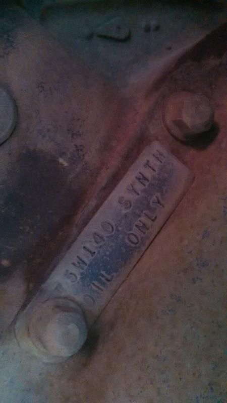

Okay... 75W140 Synthetic. Do I need Limited Slip additive or not?

I think the D on the first tag means it is an open axle. Do you plan on upgrading to the newer aluminum Super Duty cover? Tousley and Horizon ford have them for around $50. Just pick up the hardware at a local hardware store since you will need longer bolts and the ones from Ford are super expensive.
