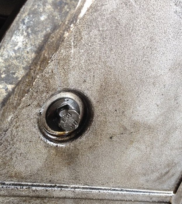

I've got my motor pulled and am trying to remove the rear engine cover so I can attache the stand.
Got all but one damn bolt out (10mm) and it not only broke my socket but is stripped. I've tried to hammer on small sockets and tried a torch with heat on it - nothing is working!!! What the hell did Ford do to this bolt? The others don't seem to have any blue Loctite on them so I don't know what to do to get this thing out - Any ideas?

Blow the head off of the bolt with the fire wrench, remove the cover and use a pipe wrench on the remaining shank. It will be sticking up the thickness of the cover. Plenty enough to get a good grip on.

I like the pipe wrench idea, if the bolt head is still there enough for the pipe wrench to bite it may do the trick.

Striped bolt socket. You can find a 3/8 6pt and hammer that on it may work or it may get more round

If you remove the top. before you go try to pop it off heat it up and them
spray if well with Kroil or PB Blaster while it's still hot so that you see
some smoke (Not Fire). Then let it sit for a few hours to do the work.

ok - got PB blaster working on it all night. I will try to heat it up again tomorrow and throw more PB at it. I tried hammering on a 6-pt 3/8 socket but it just rounded a little more. If none of that works, I'll cut it off and use the pipe wrench idea.. I hate dealing with these issues as it sucks up so much time.

ok - still no luck on this bolt. Any ideas how to cut the head off? It's recessed so I'm not sure how to get at it..

Drill through the center of the bolt head with a drill bit the slightly larger than the bolt shank, take the drill bit and mark it with electrical tape to the depth you want to go so you don't drill too deep ( get the depth by looking at the bolt head thickness on one of the other bolts ) you will have to go slightly deeper than the head of the bolt to separate the head from the shank.

And maybe use a Dremel/Rotozip or similiar tool to trim the outside edge of bolt head if needed.

That'd make me nervous doing that unless you had a surgeons hand, unless you don't mind knicking the sides of where its recessed... If you go for drilling it out, take your time and make sure you stop and spray it with PB every so often to lube it up. Should back out fine once the cover is off

you could also use a set of left hand drill bits, they seem to take the bolts out very well, like an easy out without having to drill the hole first.

Thanks guys for all the knowledge - I did manage to get it out without cutting - Used a Lisle bolt extractor set - worked great!! Next question, I believe this part (red arrow) is the rear main seal and has to be removed so I can pull cover. Manual says to drill holes on each side and pull it out with some sort of special tool - ideas on this one??
