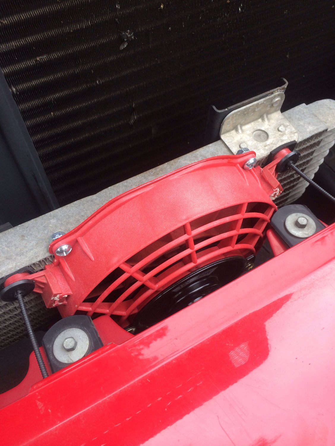

This is the fan I bought.
Amazon.com: Universal 7 Amazon.com: Universal 7" SLIM Red PULL/PUSH Reversible Electric Radiator Engine Bay Cooling Fan: Automotive
ref=pd_sim_sbs_auto_35?ie=UTF8&refRID=1G7R9HHSSS0M R8MD2B7T
Just ran wires to a switch in the cab. Turn it on and off when I want.

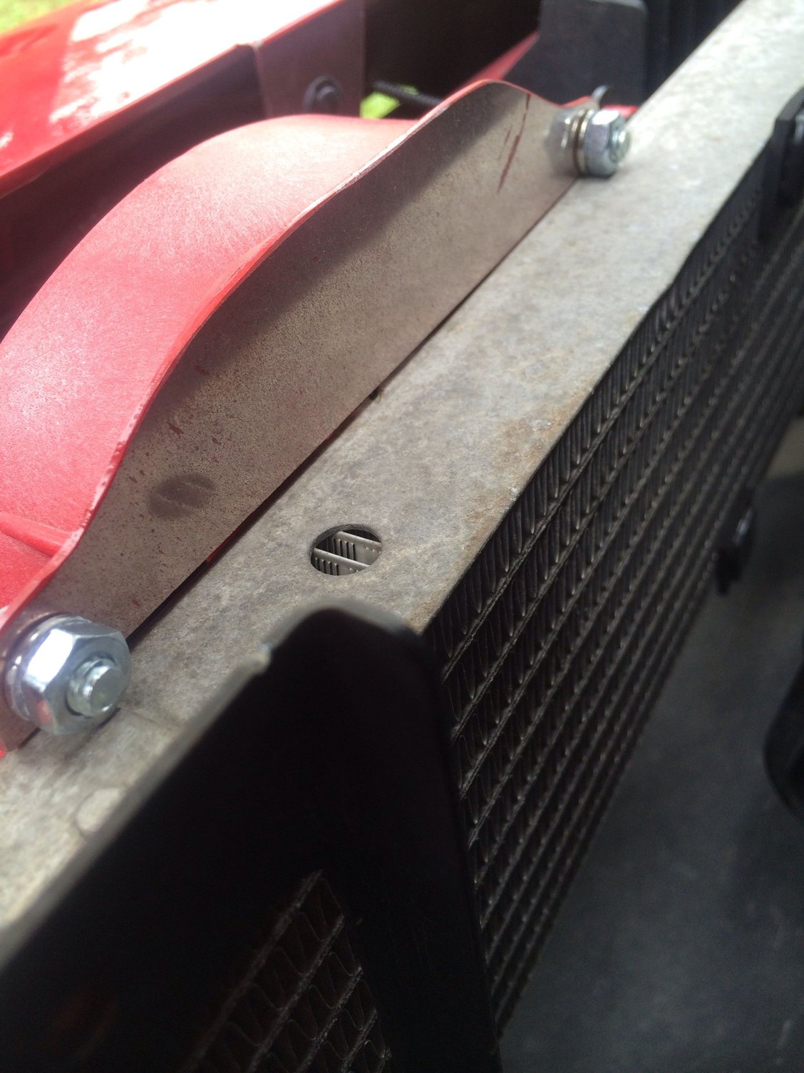

Tranny fan
Blocked off the 1 1/2" gap so air would be forced through cooler and not bypass.
Looking from front

@CaptFX4, My setup is exactly the same. What material did you use to block the openings where the fan goes past the end of the cooler. I've been trying to think of something to use. The fan does a good job with it open, I image it will be better when I close it off.
I used a piece of aircraft aluminum. Anything like that will work. Set the piece behind the fan, traced the outline with a marker and then cut. Did that for top and bottom. Definitely can tell a difference with more air being pushed through the cooler.
