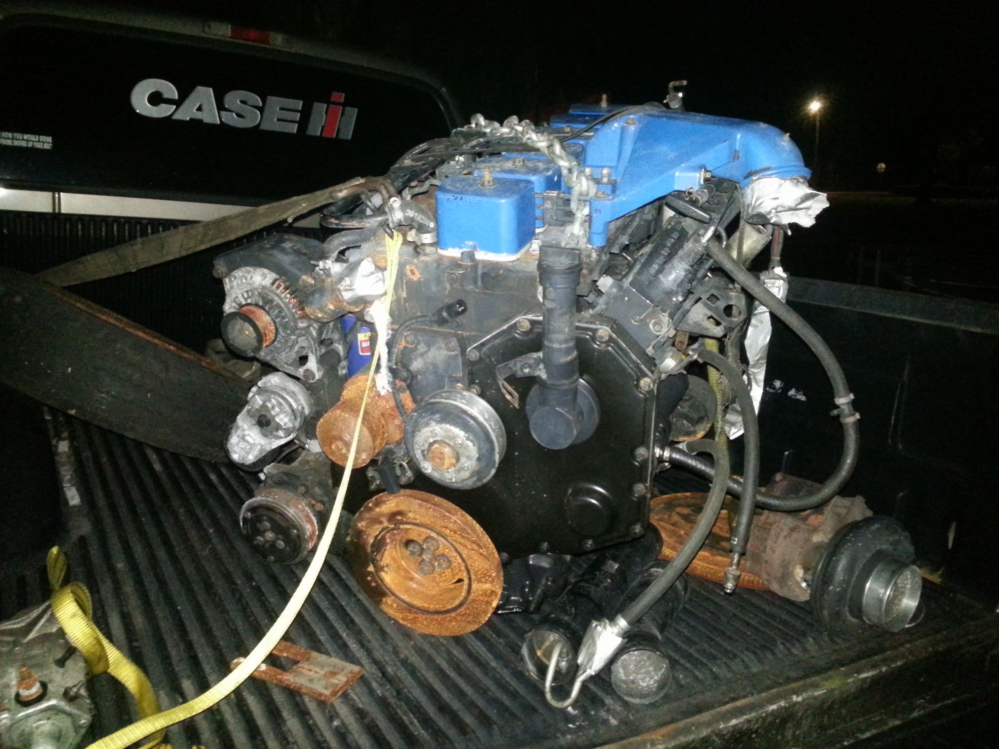

located the new heart, and purchased it for $1,500, it has 160,000 miles on it, it runs good, and has a new oil pan, harmonic balancer. installed by the previose owner for his fummins project that he decided against going through with.

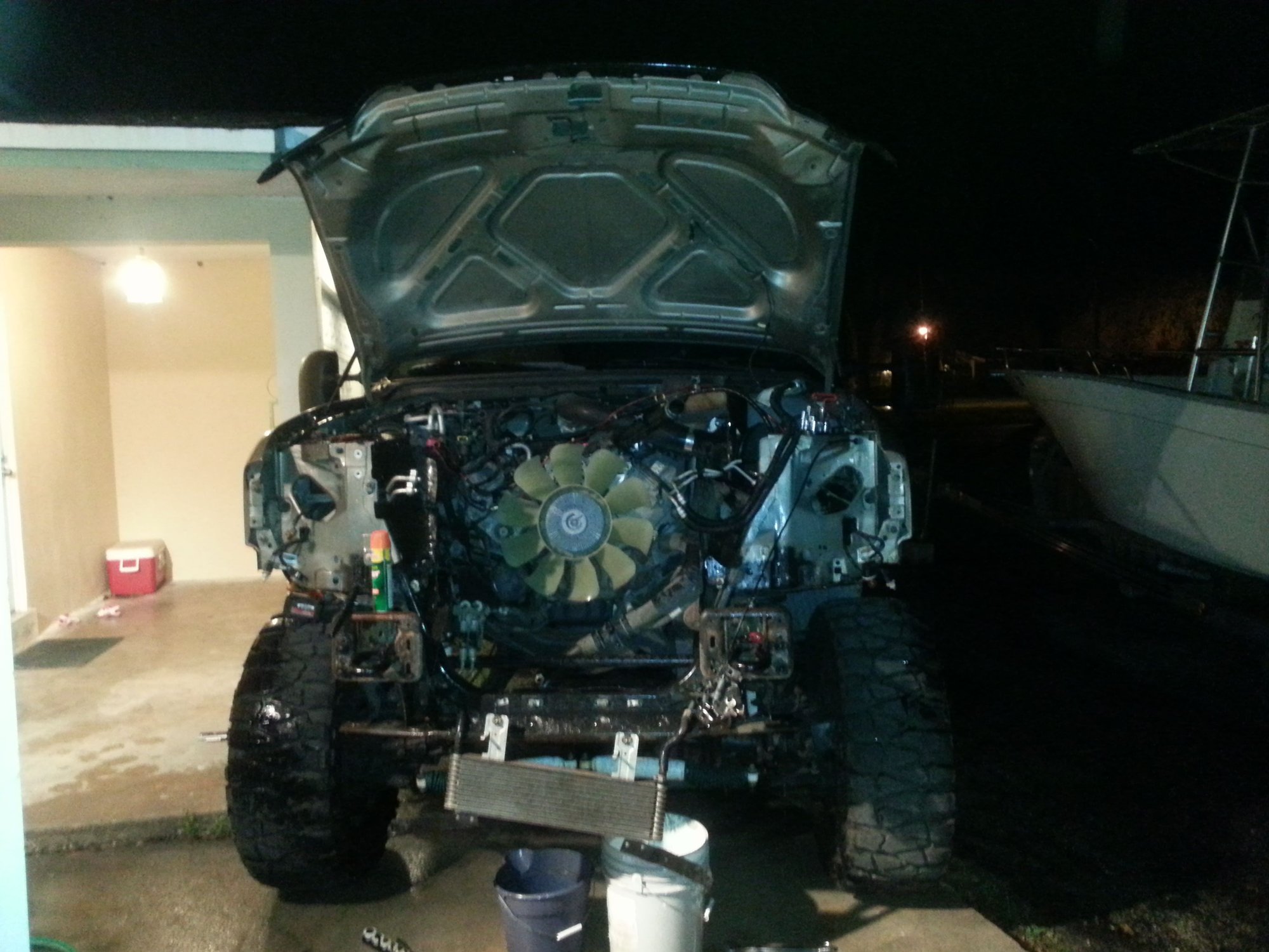

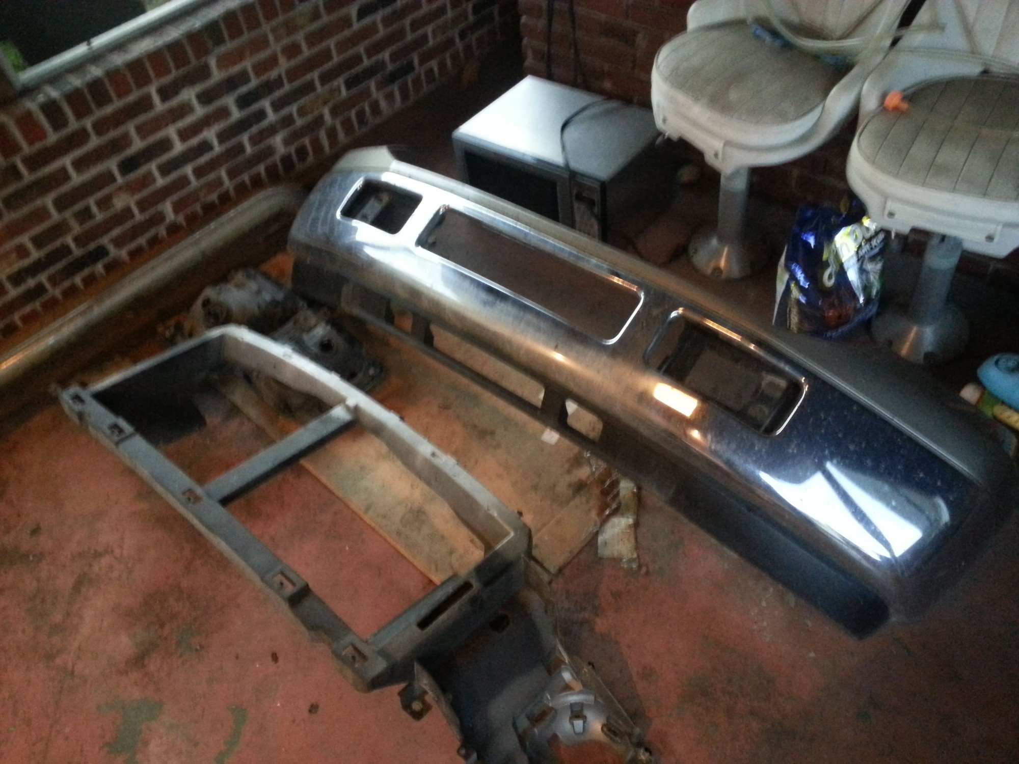

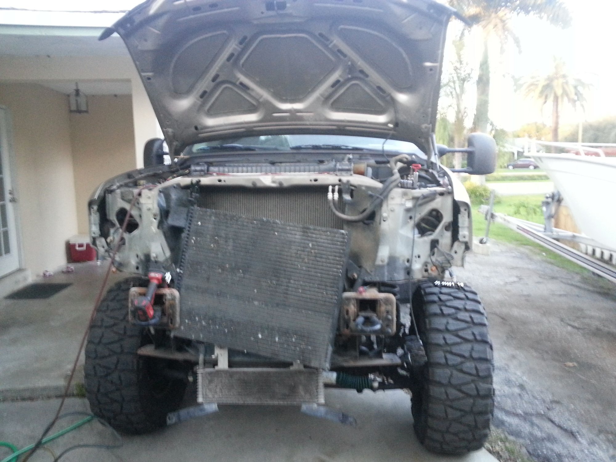

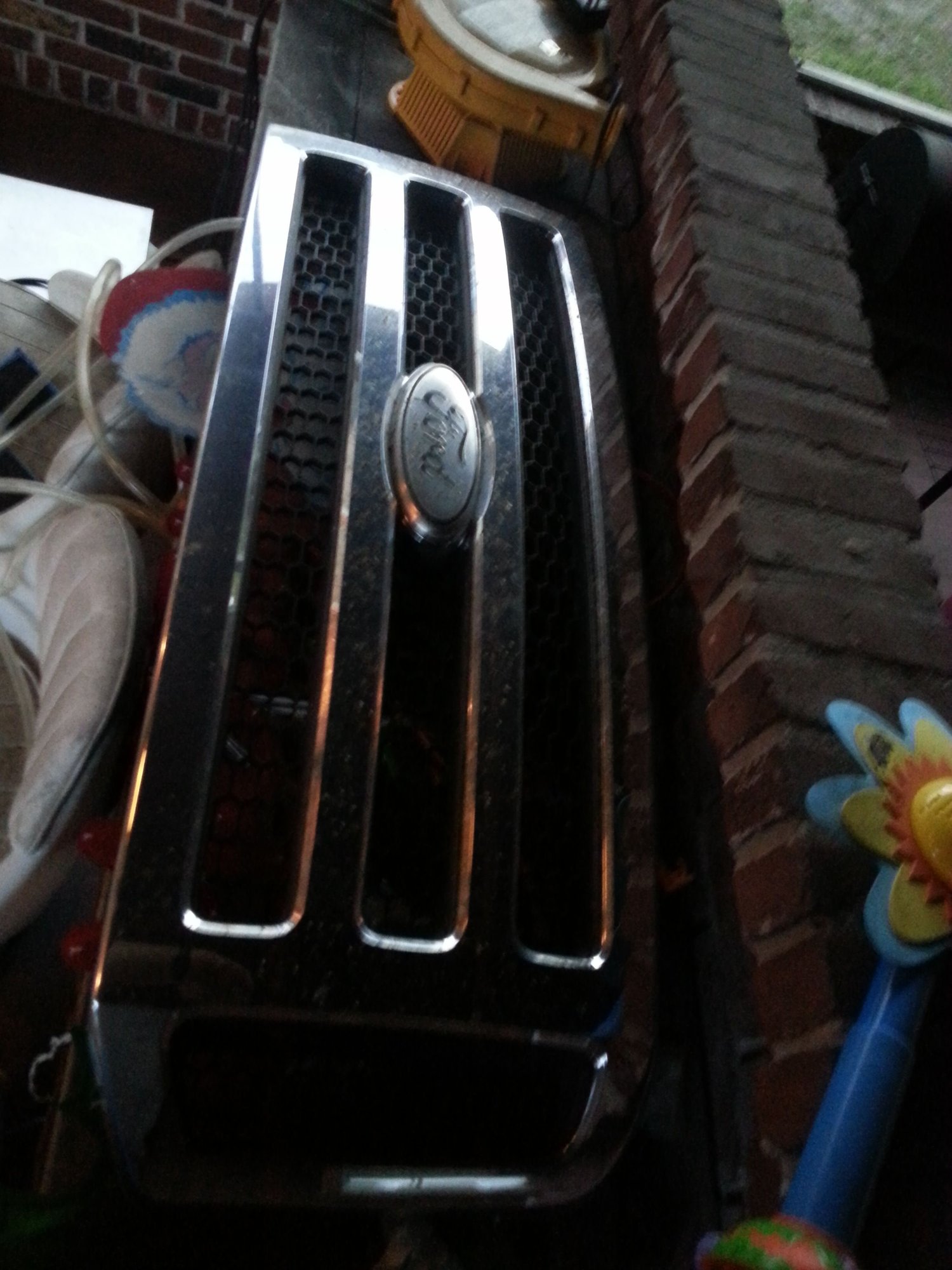

removed the headlights, grill, bumper, condensor, trans cooler, and radiator.
recruited the help of a good friend to pull the gas engine out.

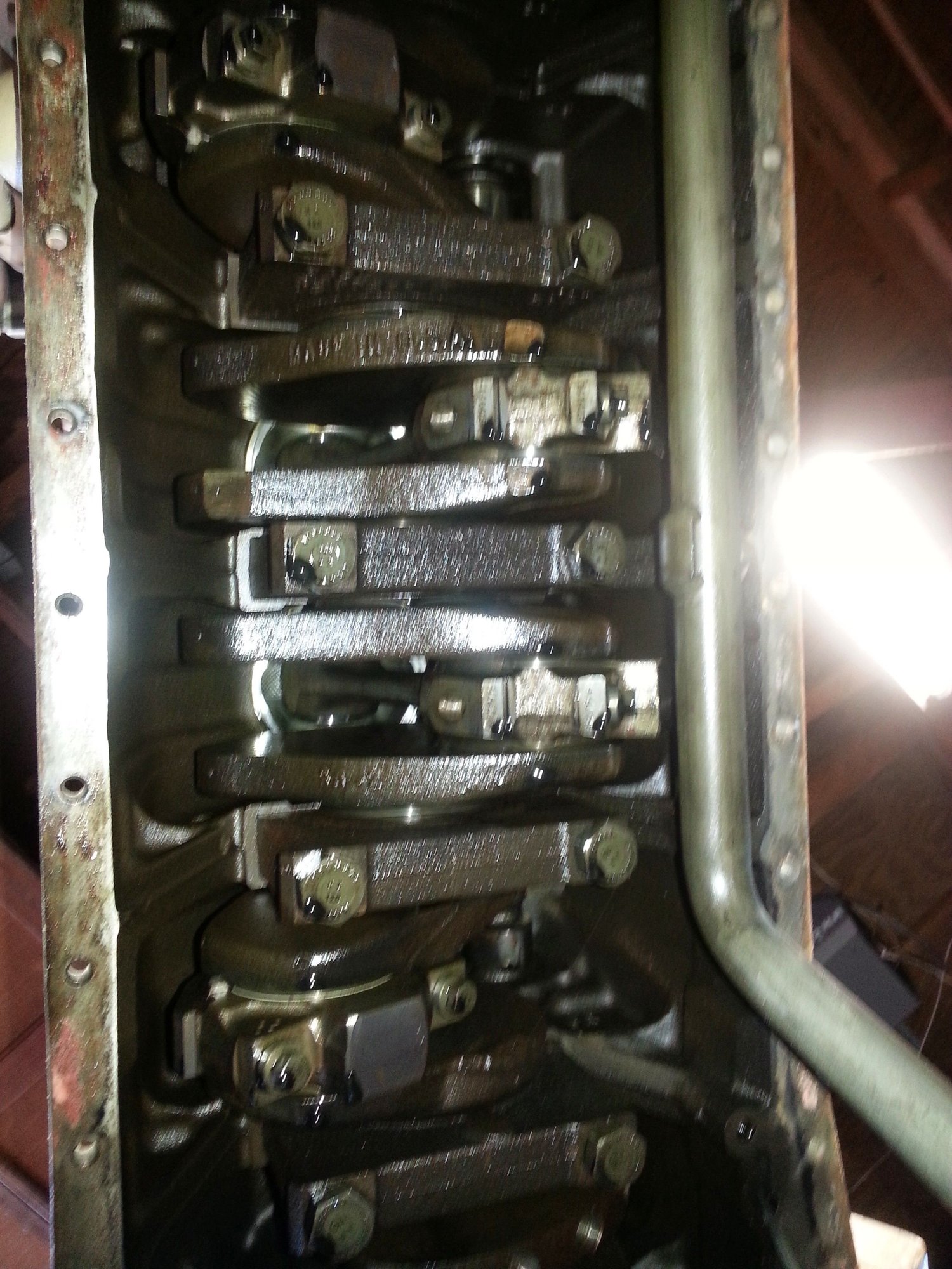

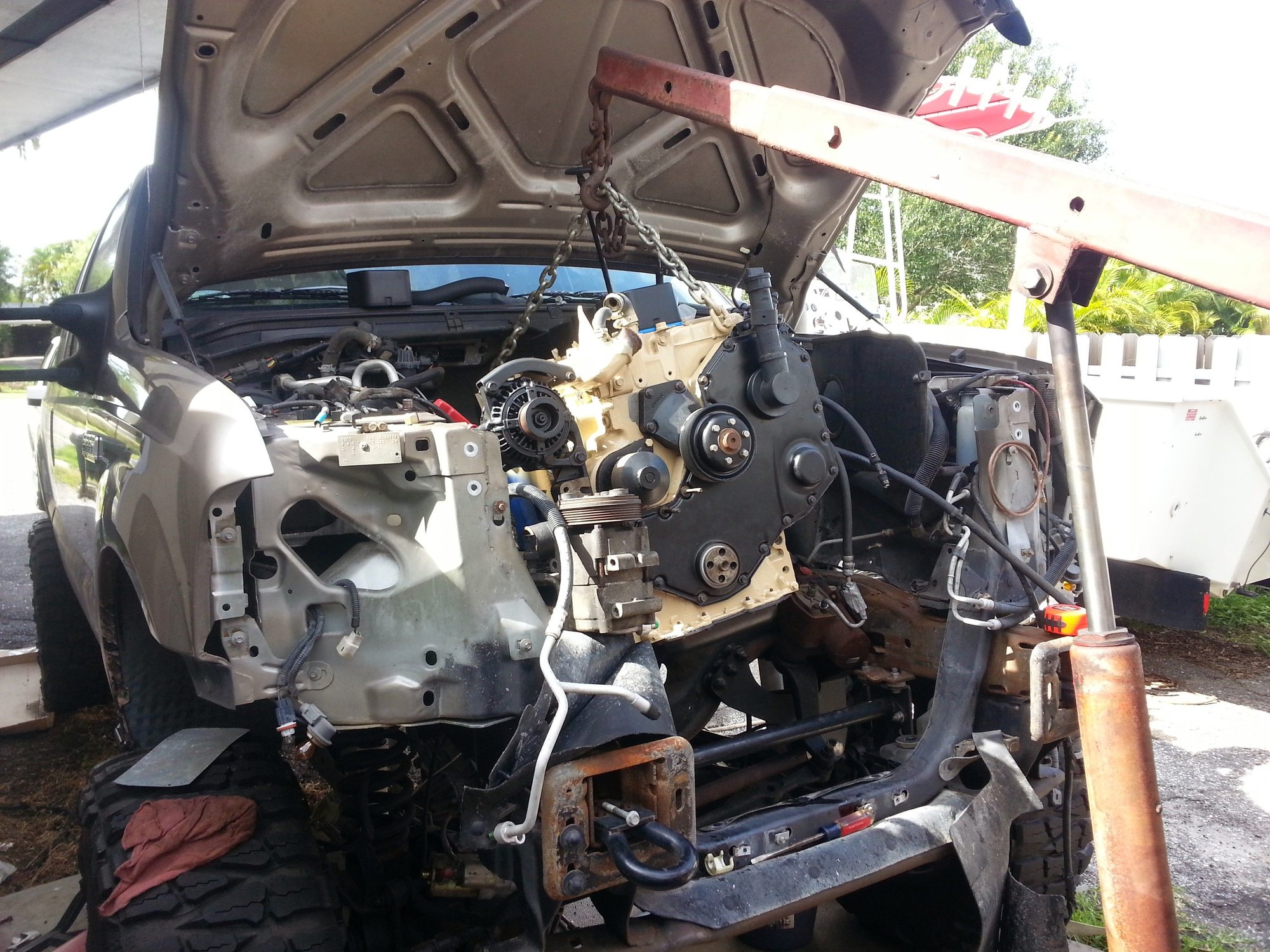

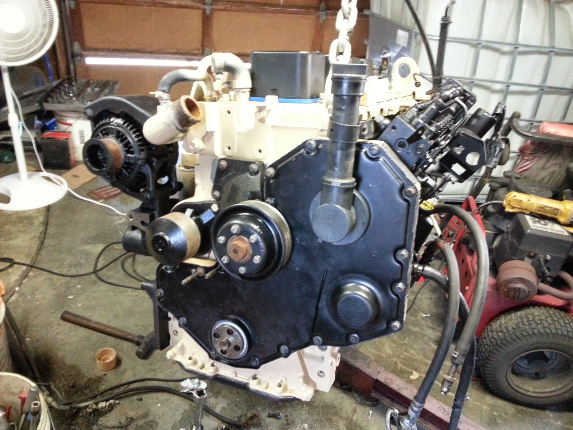

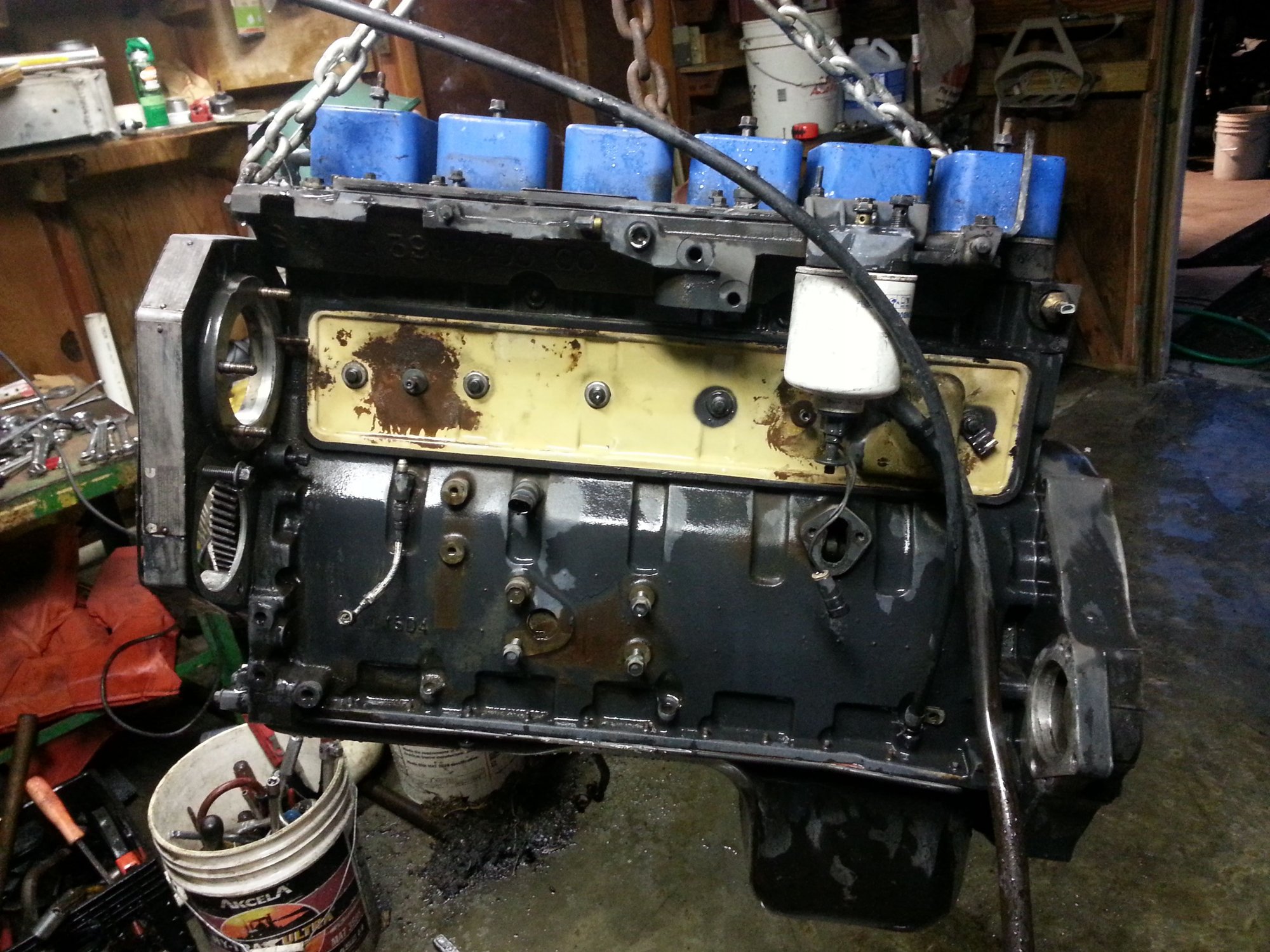

Unloaded and started cleaning the new engine.
Snatched the oil pan off, and look inside, i was very happy with how everything looked inside.

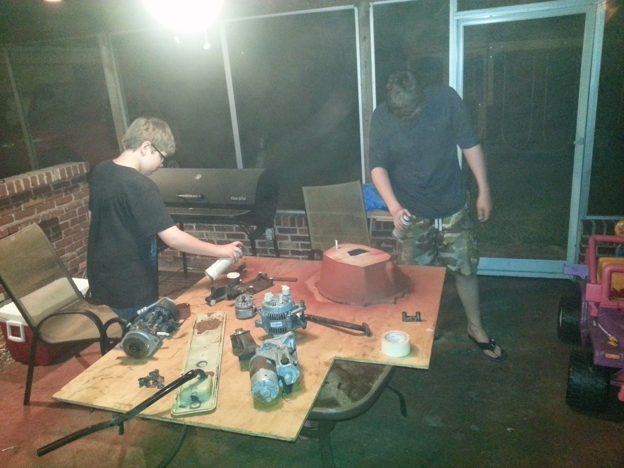

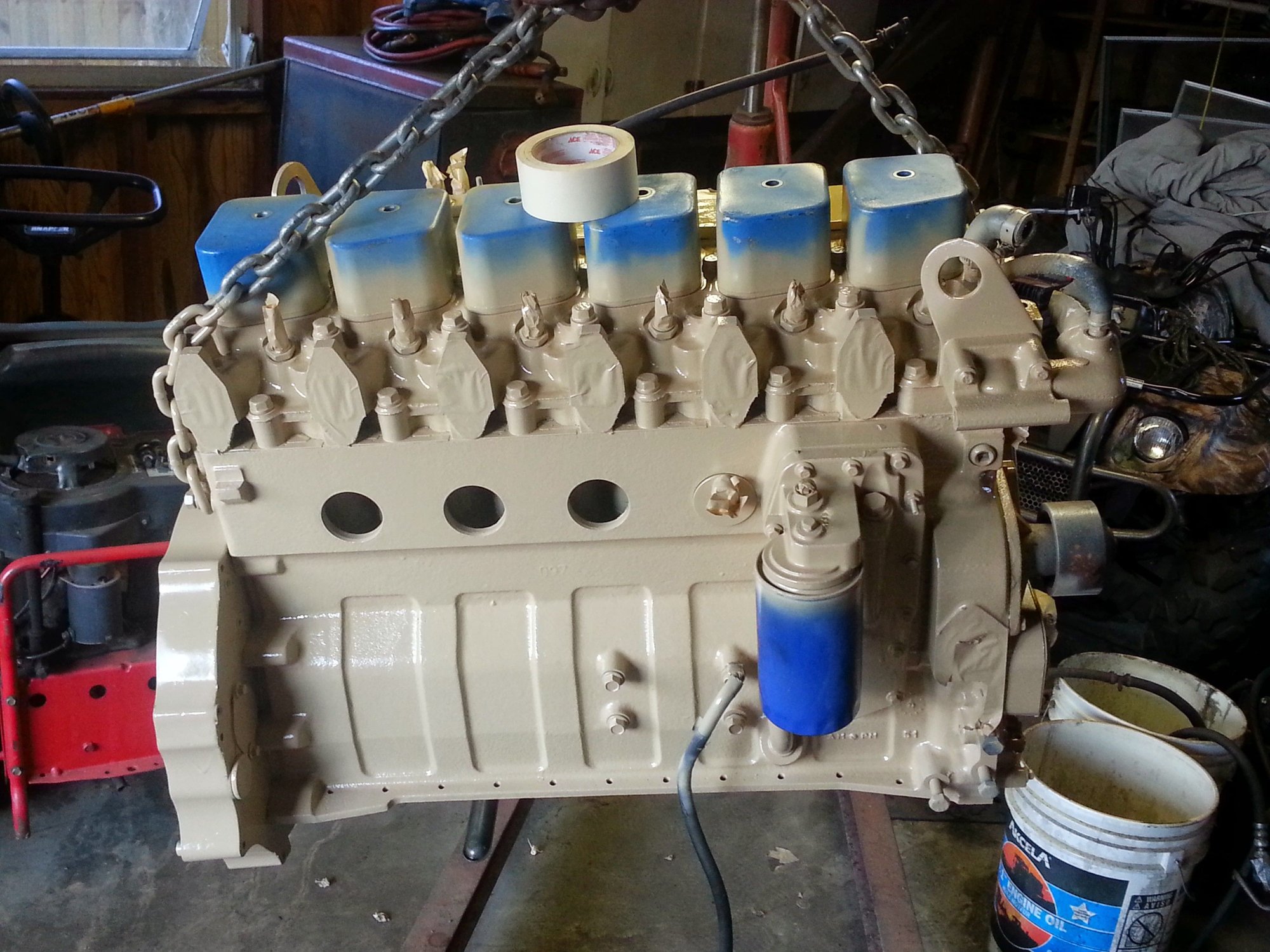

removed all accessories, cleaned/degreased them (with the help of my little bro's), replaced all seals, and gaskets, re installed oil pan, fixed the killer dowel pin, degreased and prepped the blocked, masked it all of and painted everything with primer, then paint.
re installed all accessories

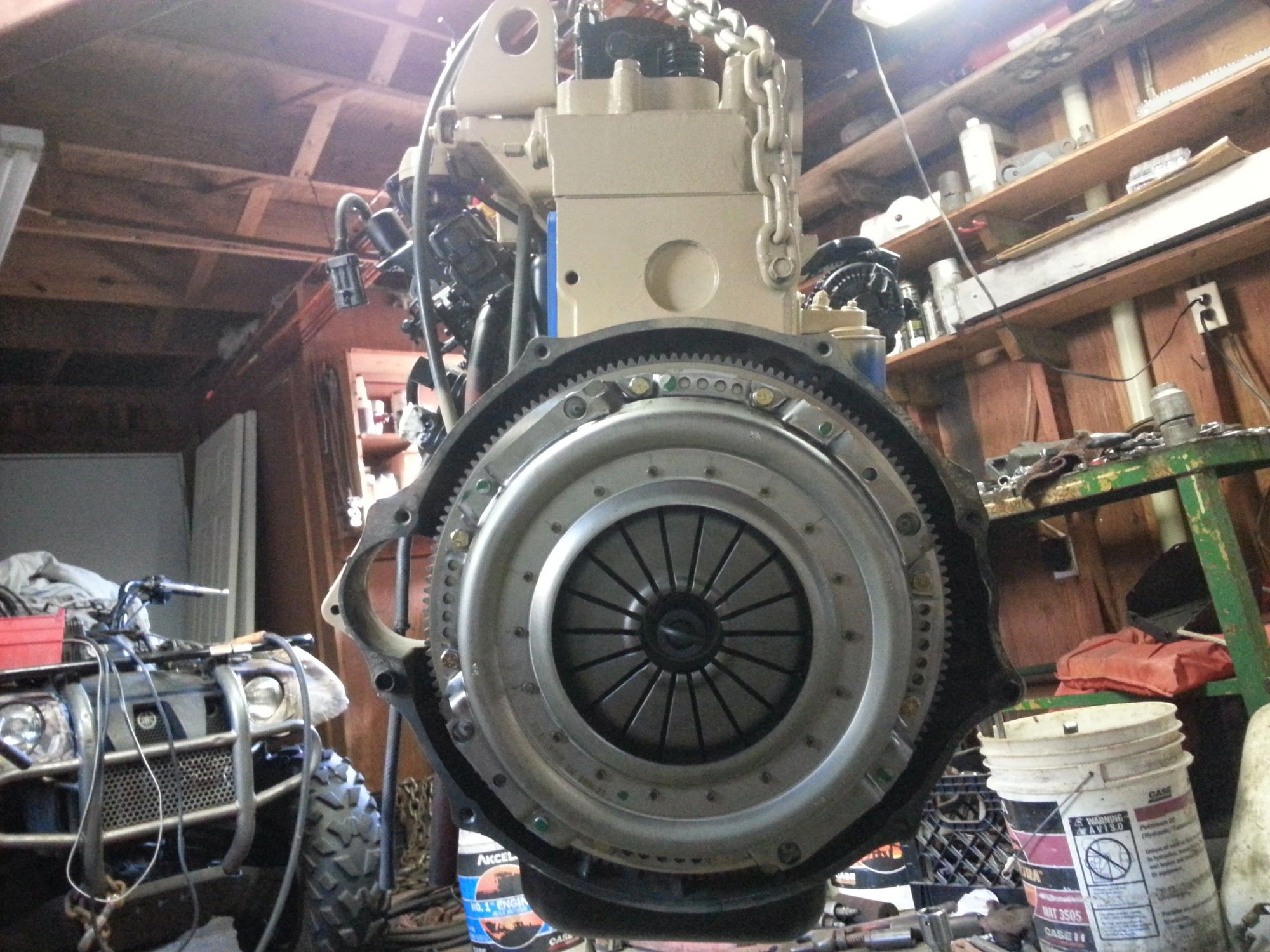

had the fly wheel resurfaced, and re installed it with a new clutch and pressure plate kit.

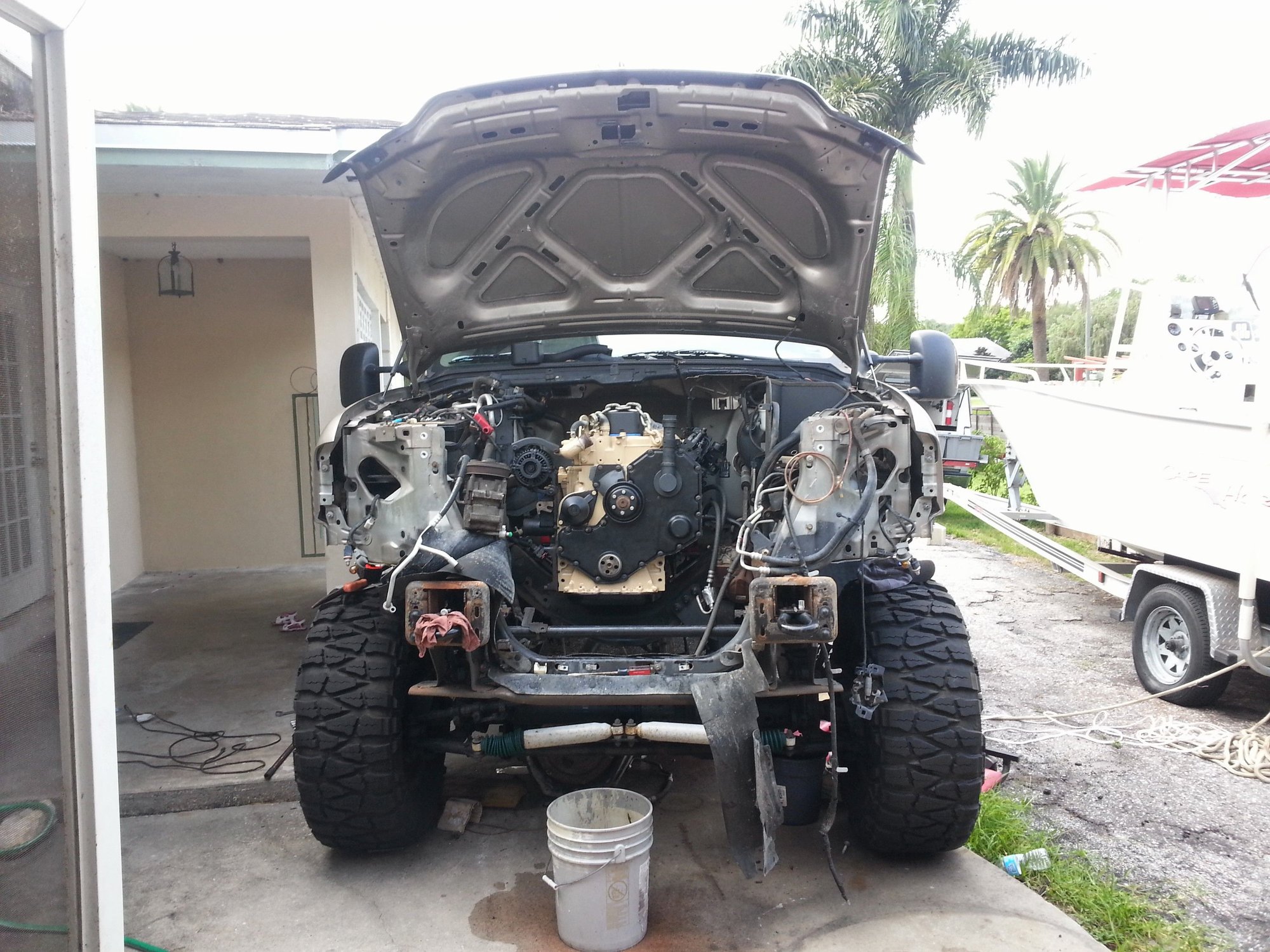

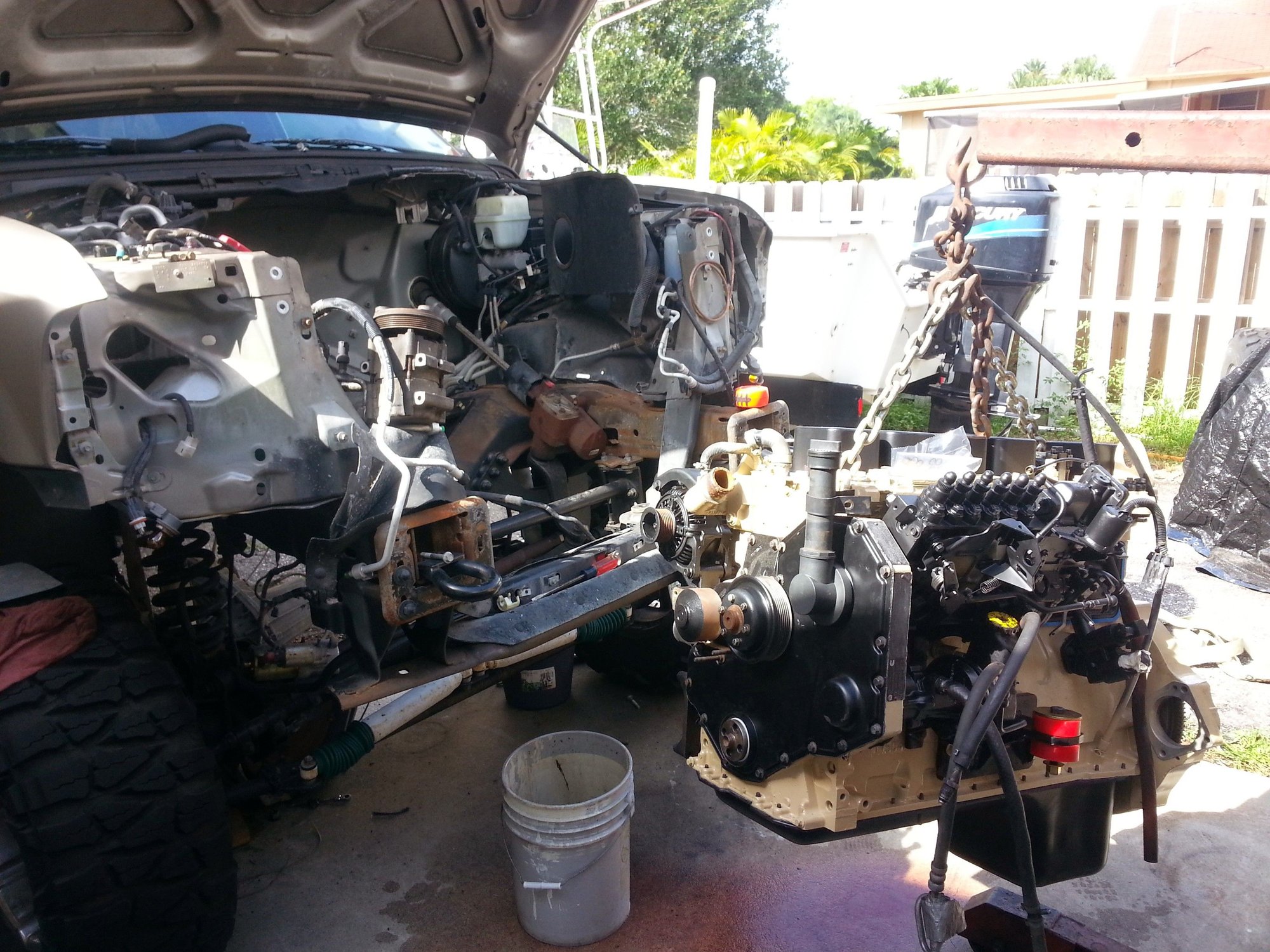

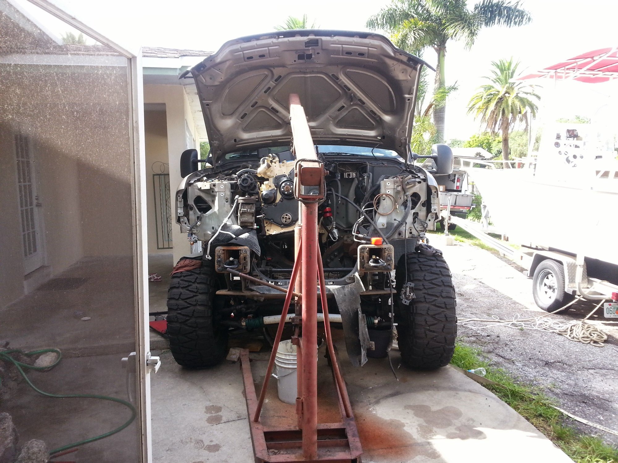

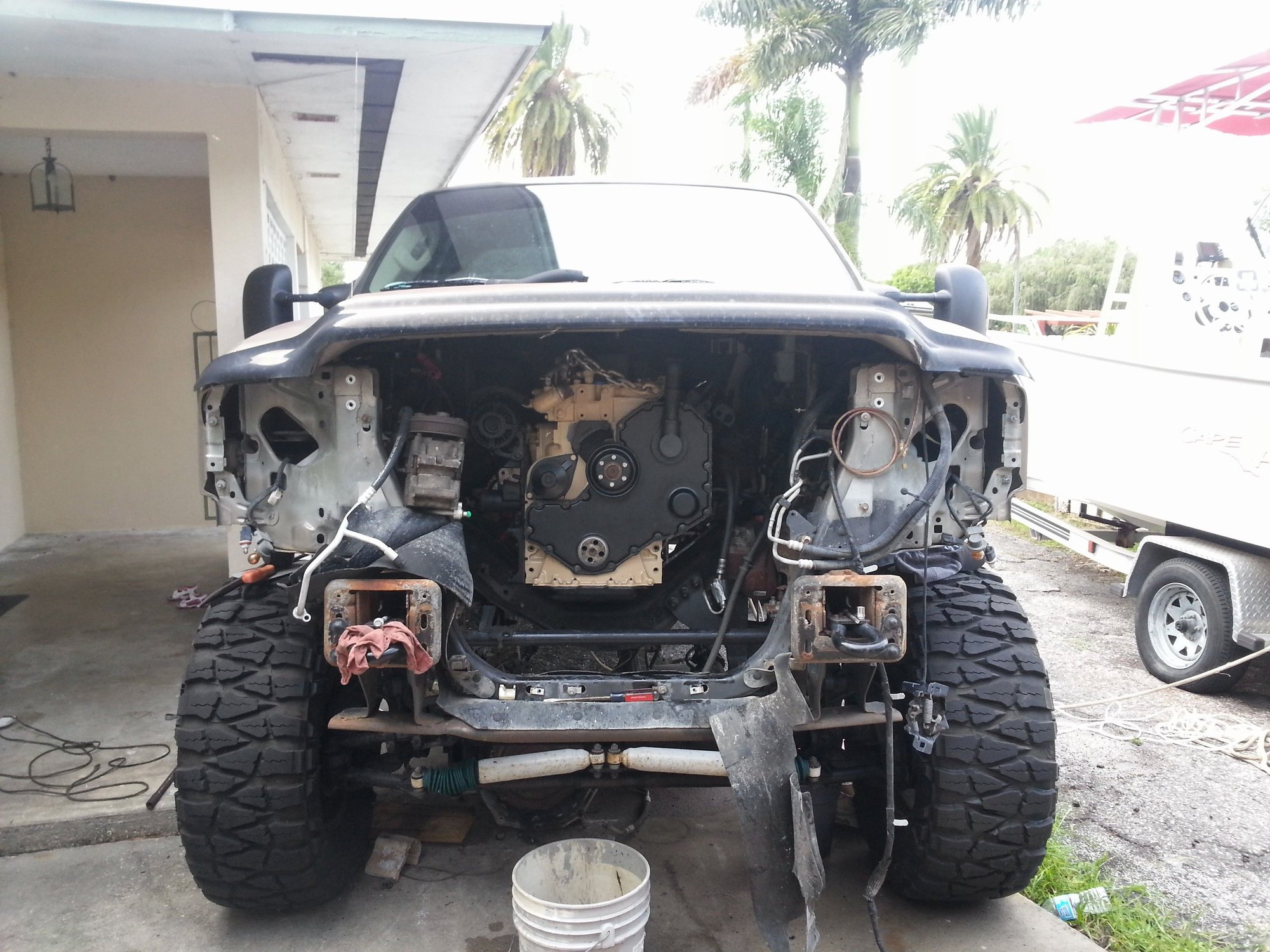

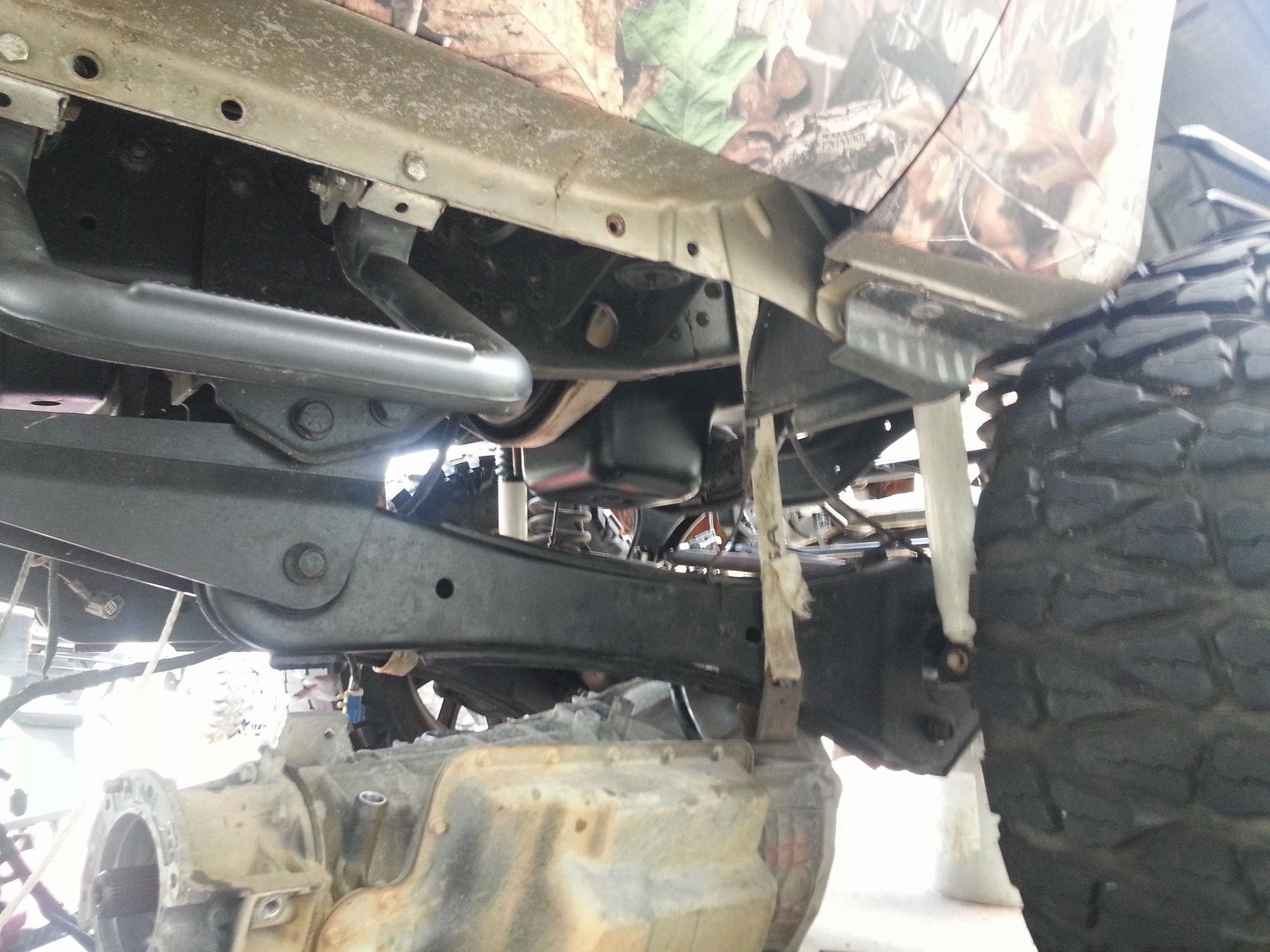

Dropped the trans and t-case down (i didnt have a trans jack, but i figured out a neat way to do it with ropes lol)
Installed my new diesel conversion specialist motor mounts (nice mounts / not nice people and i will never do business with them again), and installed the motor
and this is where i am now, i have started working on my nv4500 getting it prepped to install, and i split the t-case, and removed the input shaft, prepped it for the new input shaft. waiting on the ups guy to bring me some parts, i will get some pics of the trans and t-case and post an update soon.
