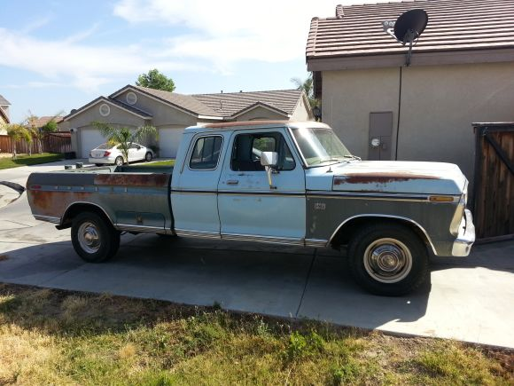

I've had newer trucks before, I figured I have this one and for what the exact same model and options would cost new I can fully restore this truck a few times over and have a cooler truck. It has factory ac and it's a supercab so I won't miss out on comfort
