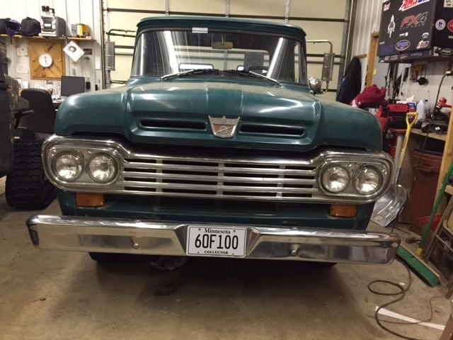

Heres a 70 f100 front bumper shortened 5.5" and made some brackets to get it 1/2" gap. It looks like I'm going to try a 70 c10 rear bumper obviously shortened..
Did you have to trim the frame horns to get it tucked back?

Posts: 63
The frame horns were cut flush prior to adding the bumper back on. I had some older style truck brackets laying around that really fit well in those cutouts. I'll get some pics when I ull it apart for plating.
