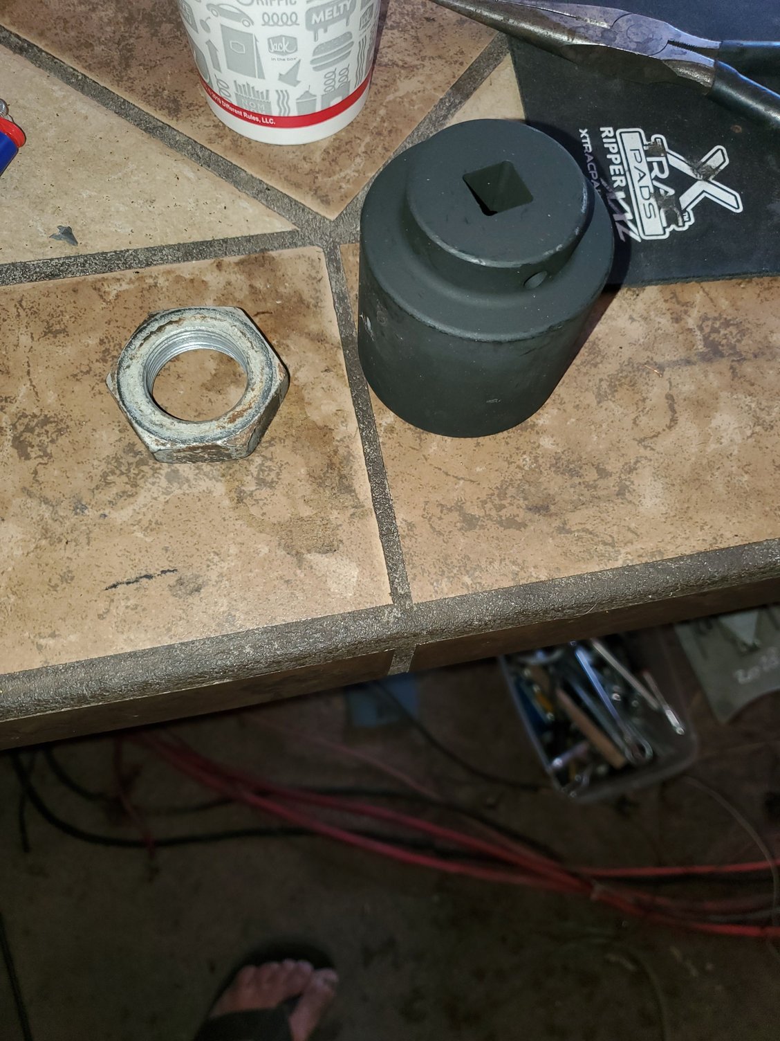

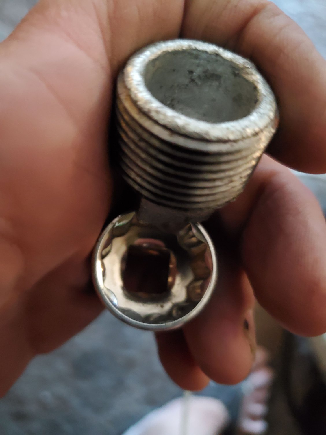

Nothing to major done today just some cooling sensor adapters for the block I pulled the block heater and was just going to block it off but then I thought I could put my ford coolant temp with an adapter in place of the block heater. Then im trying to figure out how to run my cooling hoses I know Scott the one on the top rear of the head. But im confused on the other one up front there's a port behind the alternator, and then another 2 ports behind the sc compressor and it's been so long I forgot the routing. Does anyone have any info on coolant flow charts or know where I hookup heater
houses

On the block heater, I'm not sure I'd delete that, depending on where you live. The Cummins motors run pretty cool to begin with and the block heater is a nice way to get that temperature up where it needs to be in cold weather. You don't need one, but it's a nice to have. Even in cold weather, it'll start just like it's warm out, but heat can be a problem. I've had cases where I didn't plug mine in on cold (0-20 degree days) where it didn't get to operating temperature by the time I finished my commute. My morning commute is approximately 25 miles, 2/3 of which is highway and the rest is 35-40MPH streets. Food for thought.
