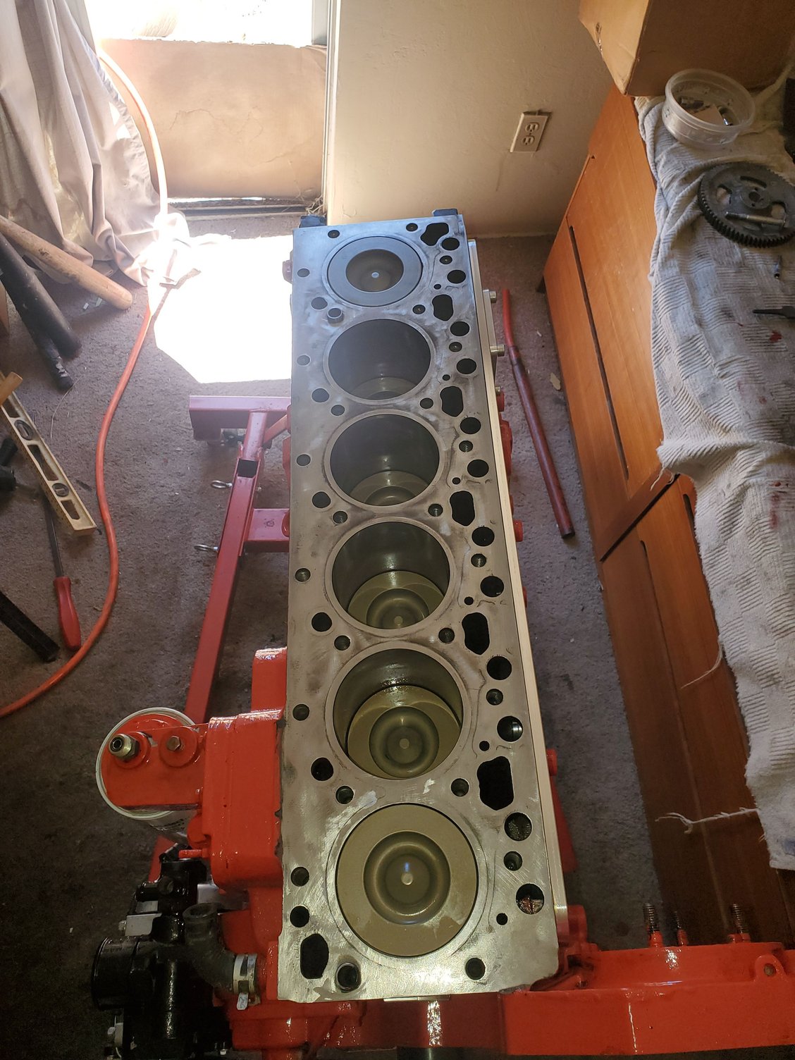

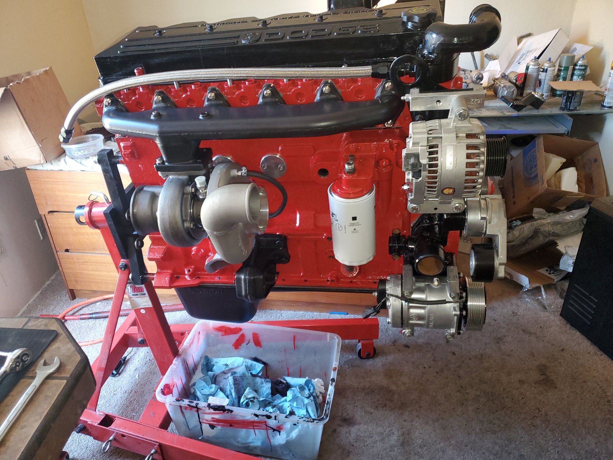

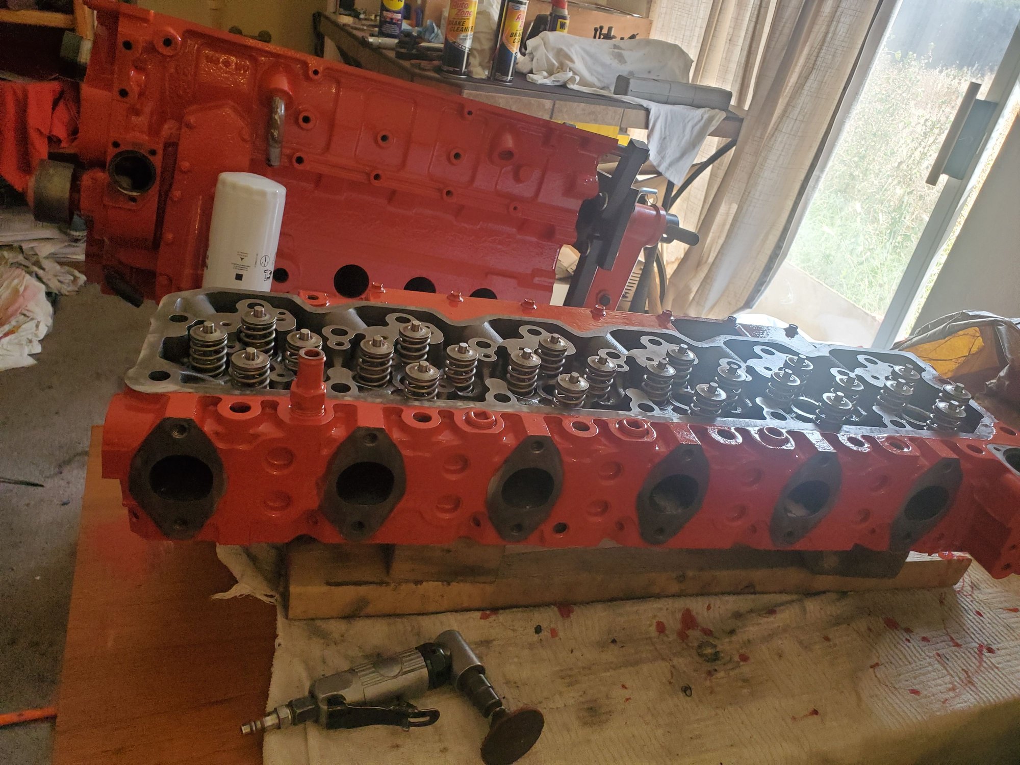

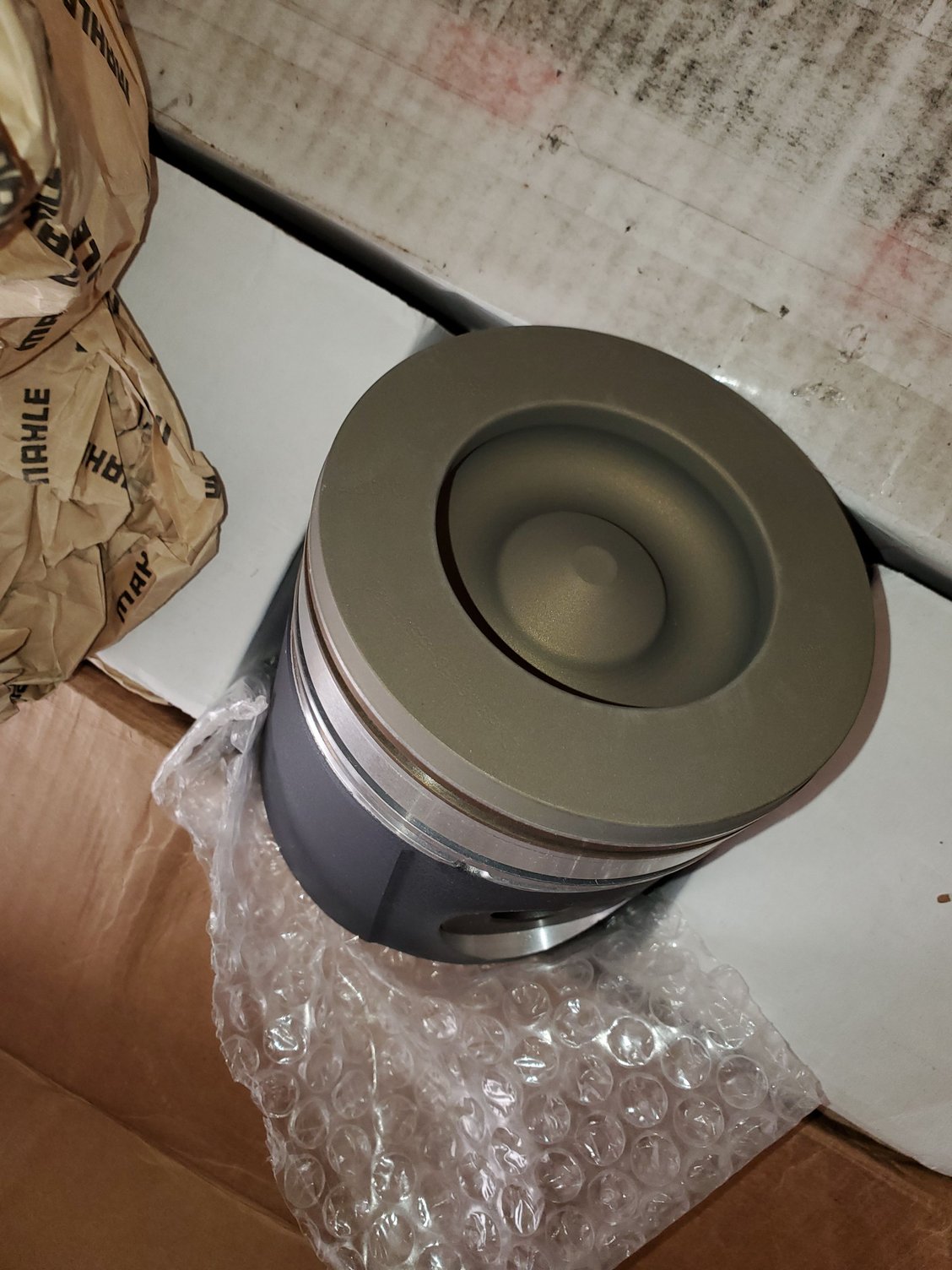

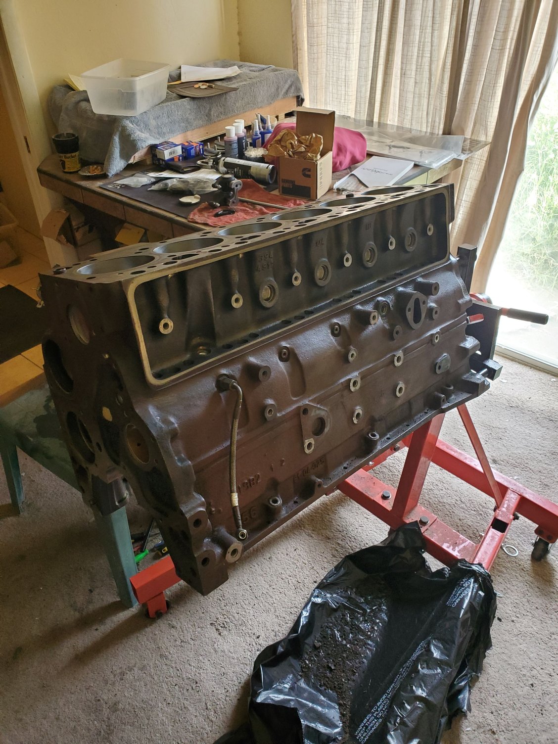

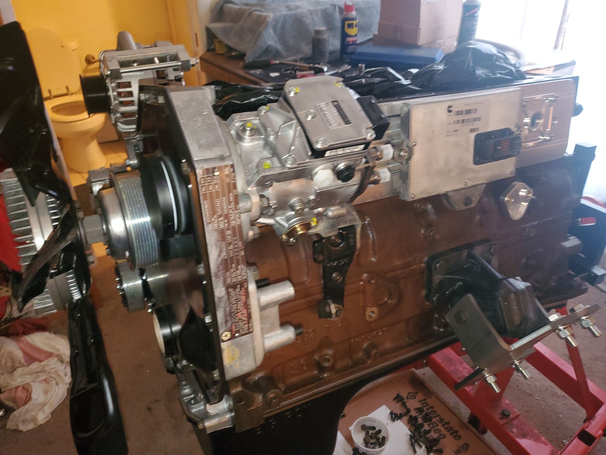

Well it's been a long time a coming but I finally have gathered enough parts to start this project when I bought her it was 2002 ford excursion 2we auto with the 5.4 liter. So over the years I been buying and buying and stacking parts to convert this to my dream rig. I always wanted to do cummins swap in a Ford. So I purchased a used engine on the Cummins forum from a member. Now I needed to rebuild the engine it had over 200k it and the rear cylinder look like it melted or was damaged so I sent it to the machine shop bored it 20 over and checked all the measurements and everything else was within spec. Now I was going to recondition the cylinder head but I ended up selling it and just decided to but a fresh new all decked and new valve guides seal was all ready to go, I switched out the stock valve springs for hamil tom. So I bought all new everything st that point below is a list of doing im doing. Then I was like I need to lift it and run 37s
Engine 2002 5.9 cummins 200k plus
Sent to machine ship bored 20 over
Bought master rebuild kit
Mahle 20 over pistons sent off to be coated
New piston rod and main bearings sent off to beer coated
New cylinder head new valves , seals, guides
Hamilton 103 valve springs
hamilton upgraded pushrod
Hamilton tappers
Hamilton cam forget specs better than stock
Hamilton cam plate and bolt
Hamilton brass cam retainer
Cummins oem new oil cooler
dap 150 injectors
steed speed common rail t3 manifold
Industrial injection rebuilt injection pump
Fass 150 lift pump fuel system
Billet tappet cover Keaton
Billet block lift pump cover
Sxe turbo 62 68 12 with billet wheel
New cummins timing cover
New alternator
New ac compressor
New pcs power steering pump
Fleece coolant bypass
Arp 625 head studs
OEM cummins 20 over headgasket
Quad zilla programmer
New coolong fan blade
new cooling fan clutch
Timbos new apps sensor
All electrical engine sensors are brand new
New map sensor
New oil pressure sensor
New coolant sensor
New air temp sen sensor
new Ford oil pressure and coolant sensor
No tone wheel swap helpers tach box
Fluid damper crank pulley
Destroked 4r100 adapter
Destroked 4r100 flexplate
New starter
stage 8 locking manifold and turbo bolt kits
destroked engine conversion mount kit
Destroked aluminum fan shroud
All aluminum radiator new
All aluminum intercooler new
upgraded 6.0 transmission cooler
new ac condenser
Pcs steering ran assist rod
Pmf front diff cover with ram assist brackets
Red head heat box

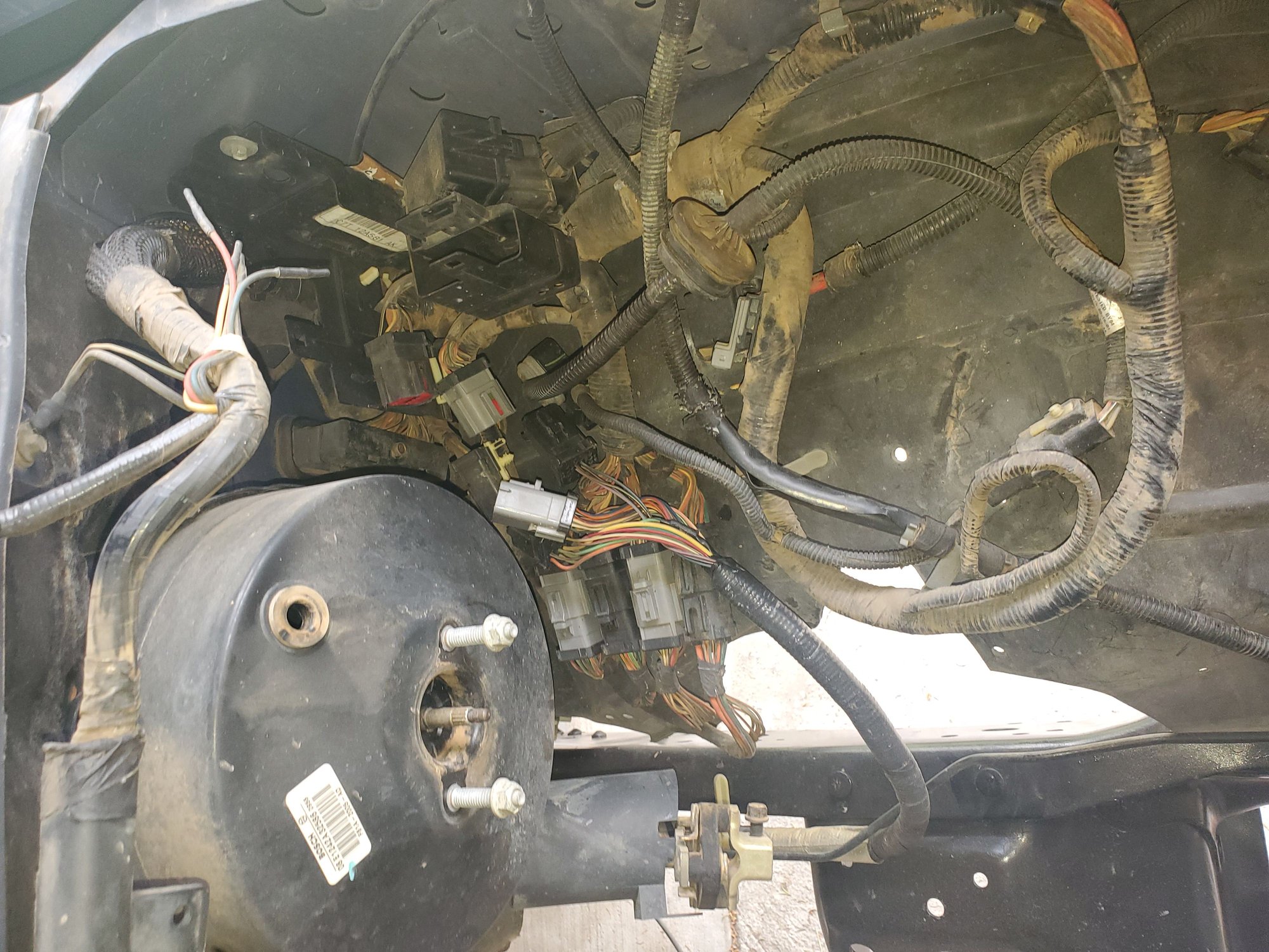

Converted to hydro boost
New hydro boost unit and master cylinder
4r100 build by John wood for the Cummins with triple disc converter
tcm 2000 transmission controller and wiring harness for 4r100
np271 manual transfer case still need to rebuild
suspension
Carli 2005 f250 4 inch lift kit
Pine top kit with king 2.5 shocks
Full leaf spring 2008 f250 carli suspension
Carli front radious arms
Carbon poly body mounts
Eaton true track front and rear diffs with 4.56 ring and pinion front and rear with master rebuild bearing and seal kits
New rear outer wheel bearings timkon with seals
front dyna track freespin hub kit
daynatrack front upper and lower upgraded balljoints
Moog outer tie rods ends and track bar ends
brand new rotors high carbon front and rear
Brand new pads high end front and rear
New rear brake shoes
New brake dust shields front and rear

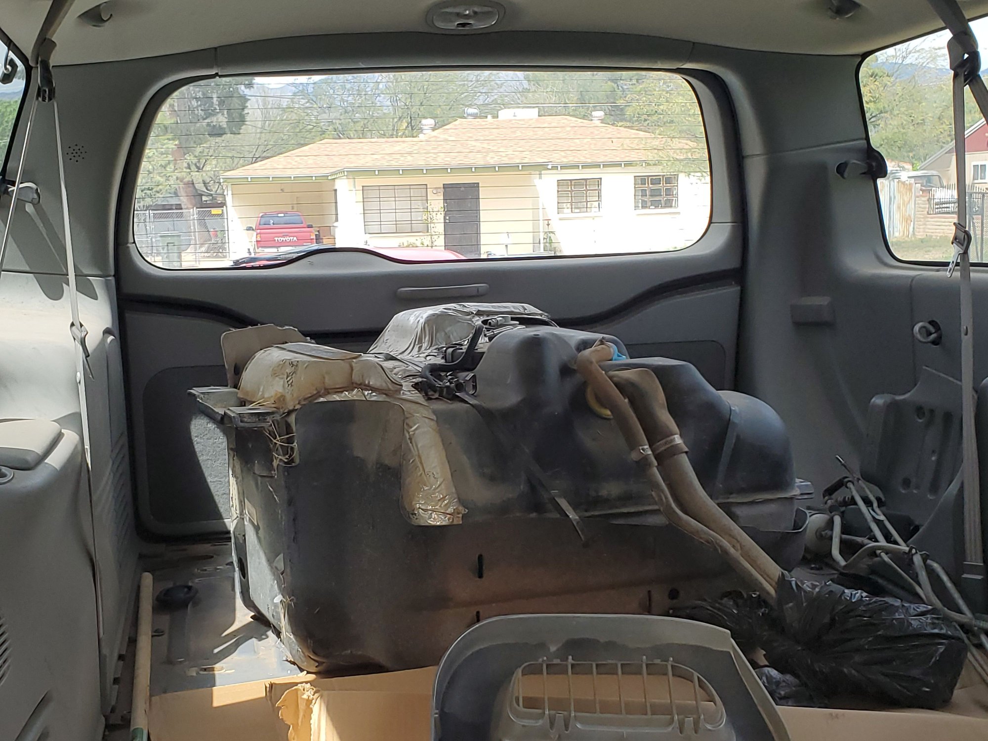

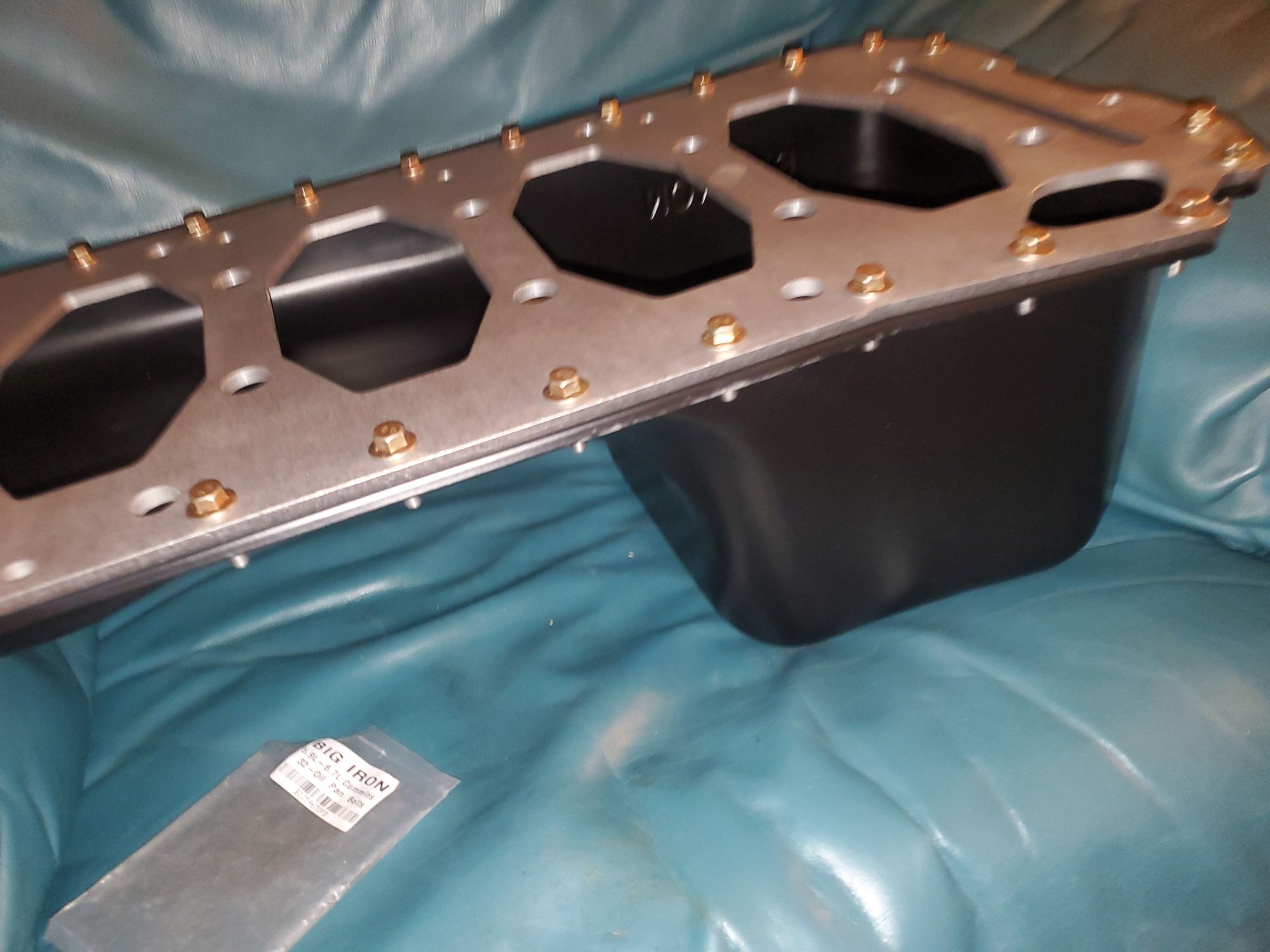

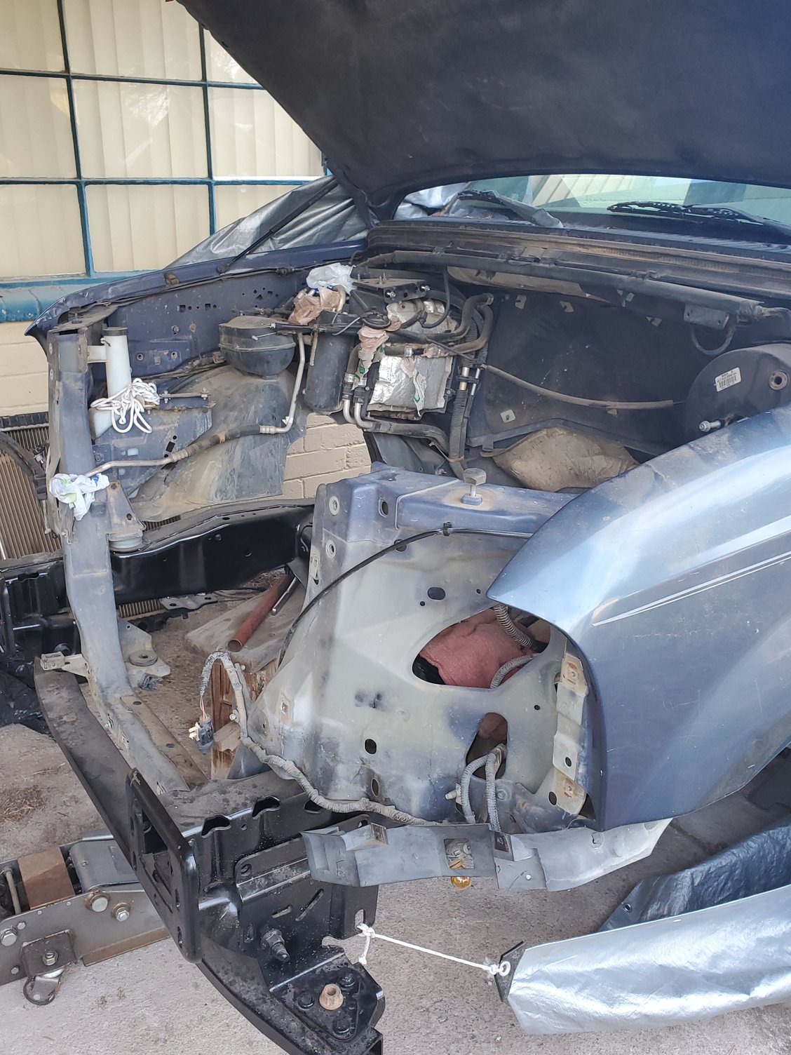

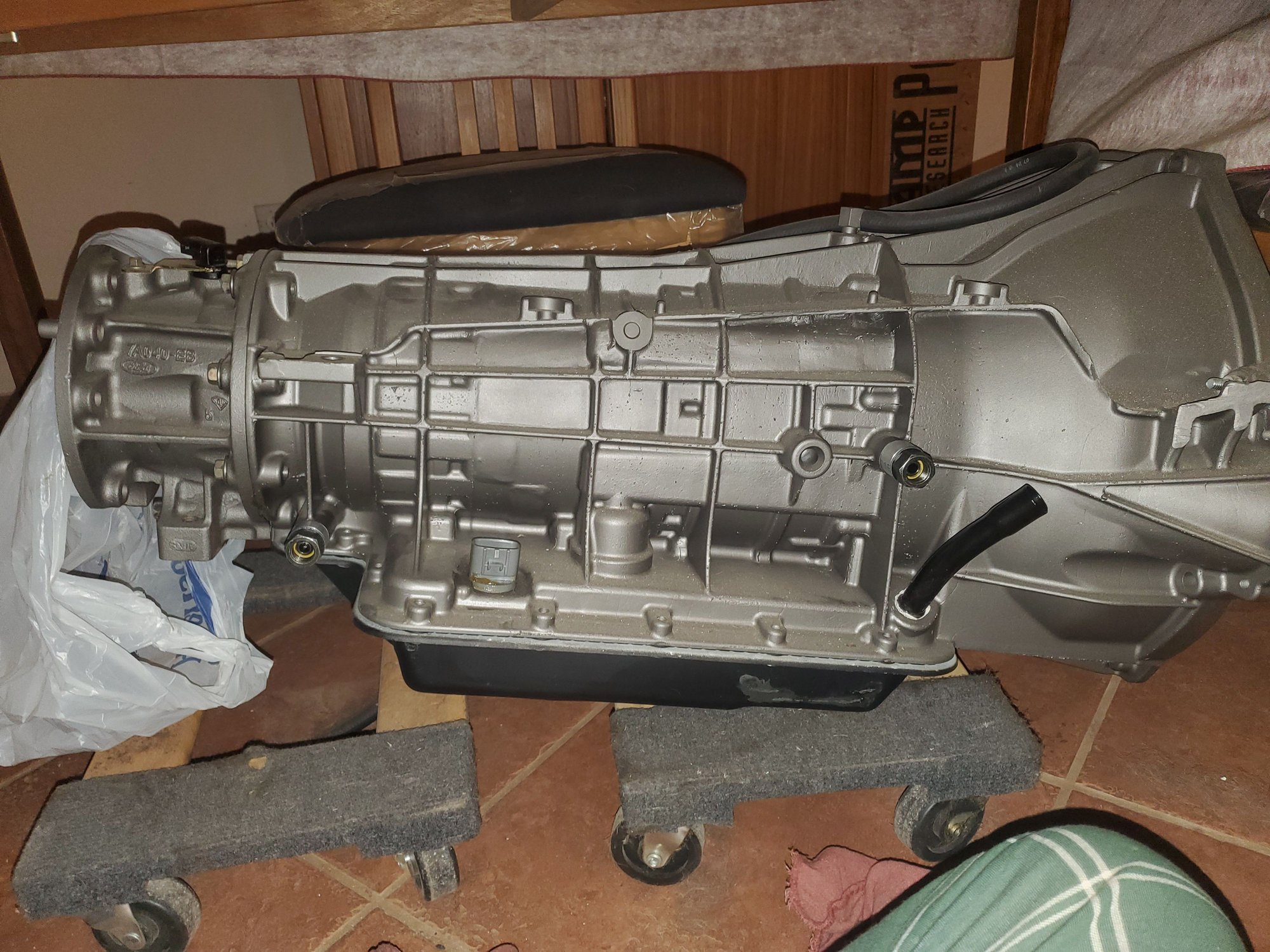

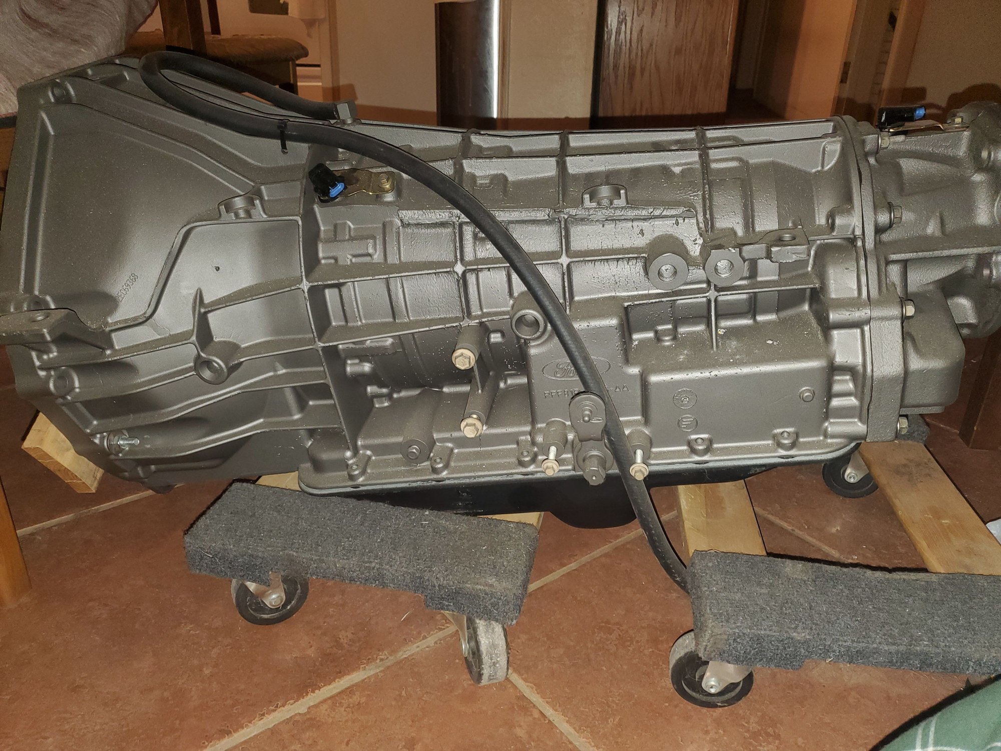

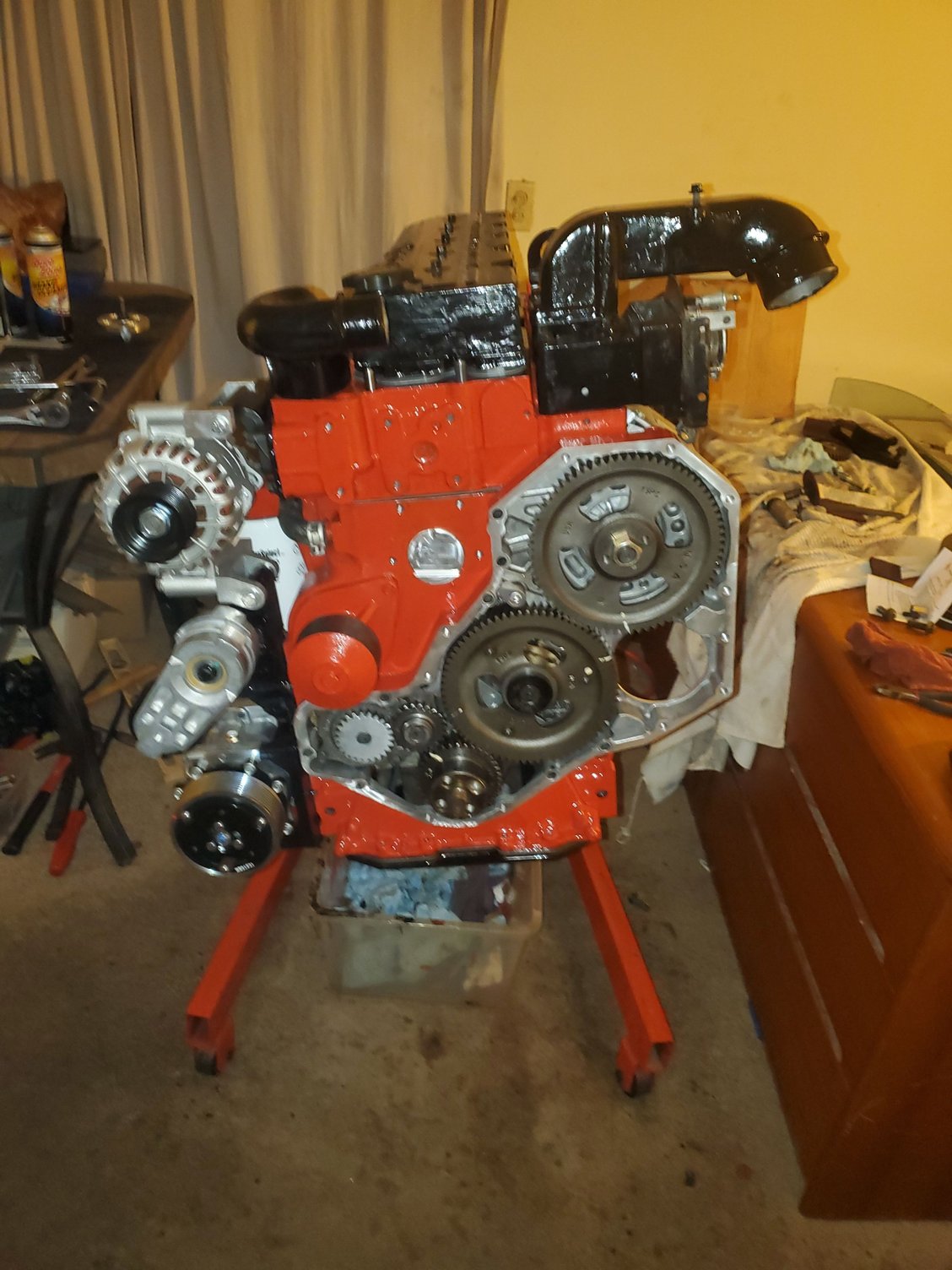

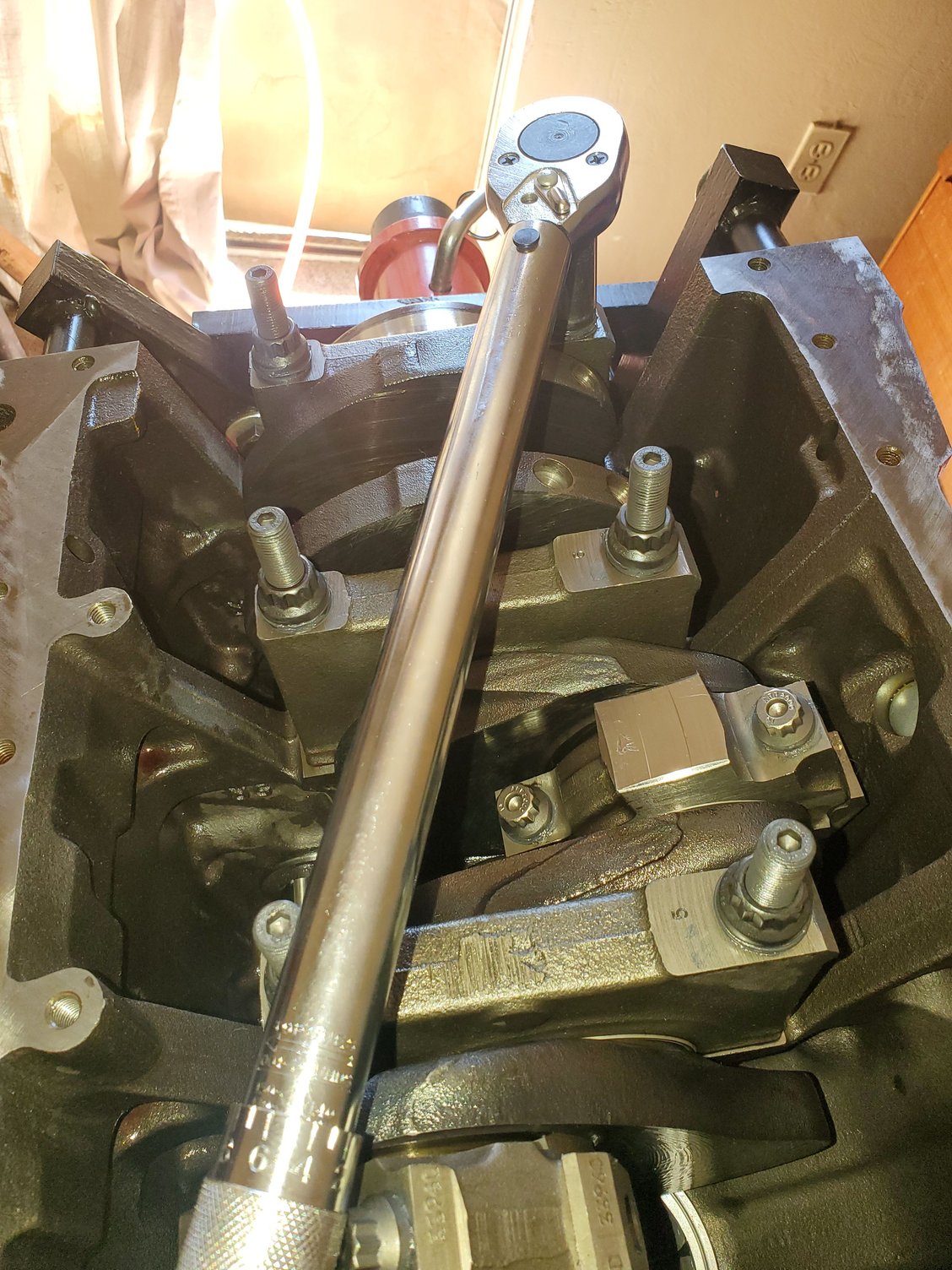

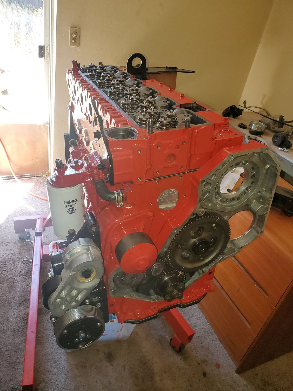

That's what I have so far and I've pulled the gas engine out painted frame had the transmission rebuilt buy John wood and I and almost done rebuilding the Cummins engine. Have a lot left to do still need to rebuild front and rear axles and install engine and trans in truck and install axles and suspension.
I'll upload all the images in the next few days

Old Apr 30, 2020 | 05:43 AM

That is truly badass brother! We need more!!! Great work.

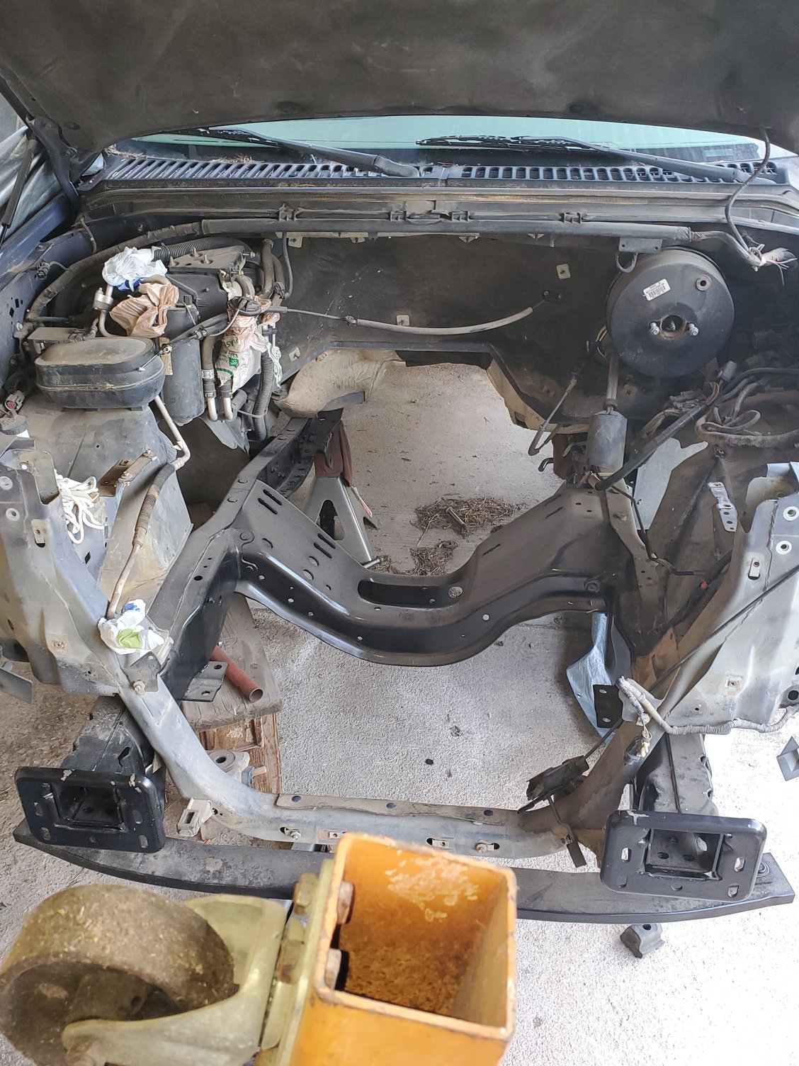

Niiiiicccceeee!!!! Look at how CLEAN the frame on that X is! Shew! Well done!!

Yeah we pulled the body off to be able to paint the frame properly
