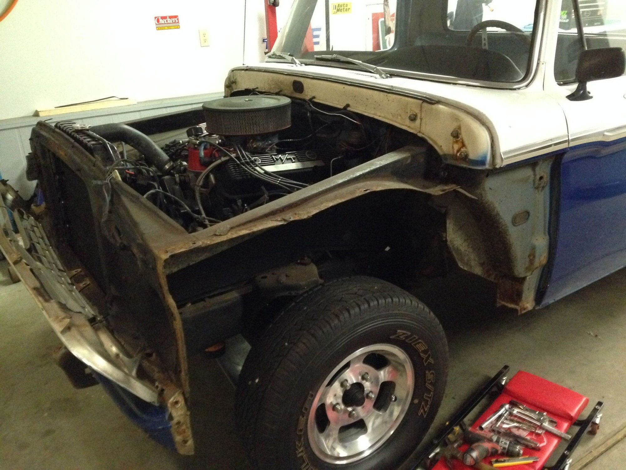

66 F100 continued
Tear down begins
These bolts have been in place for 47 years.... They're tough, thank god for pb blaster <br/>

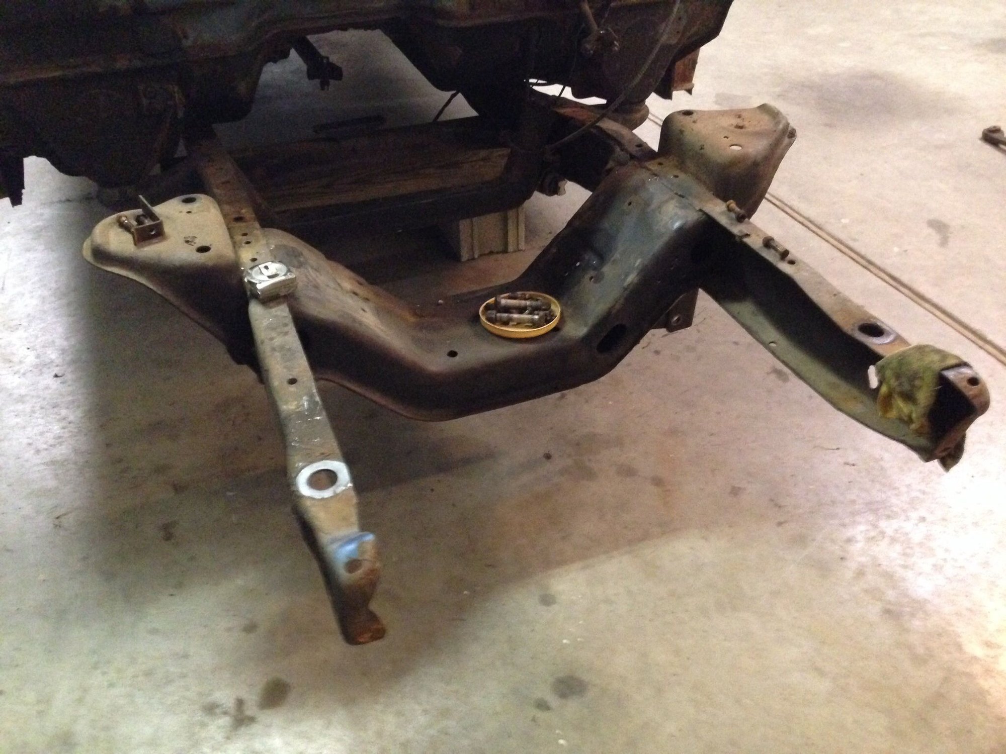

F 100 Continued

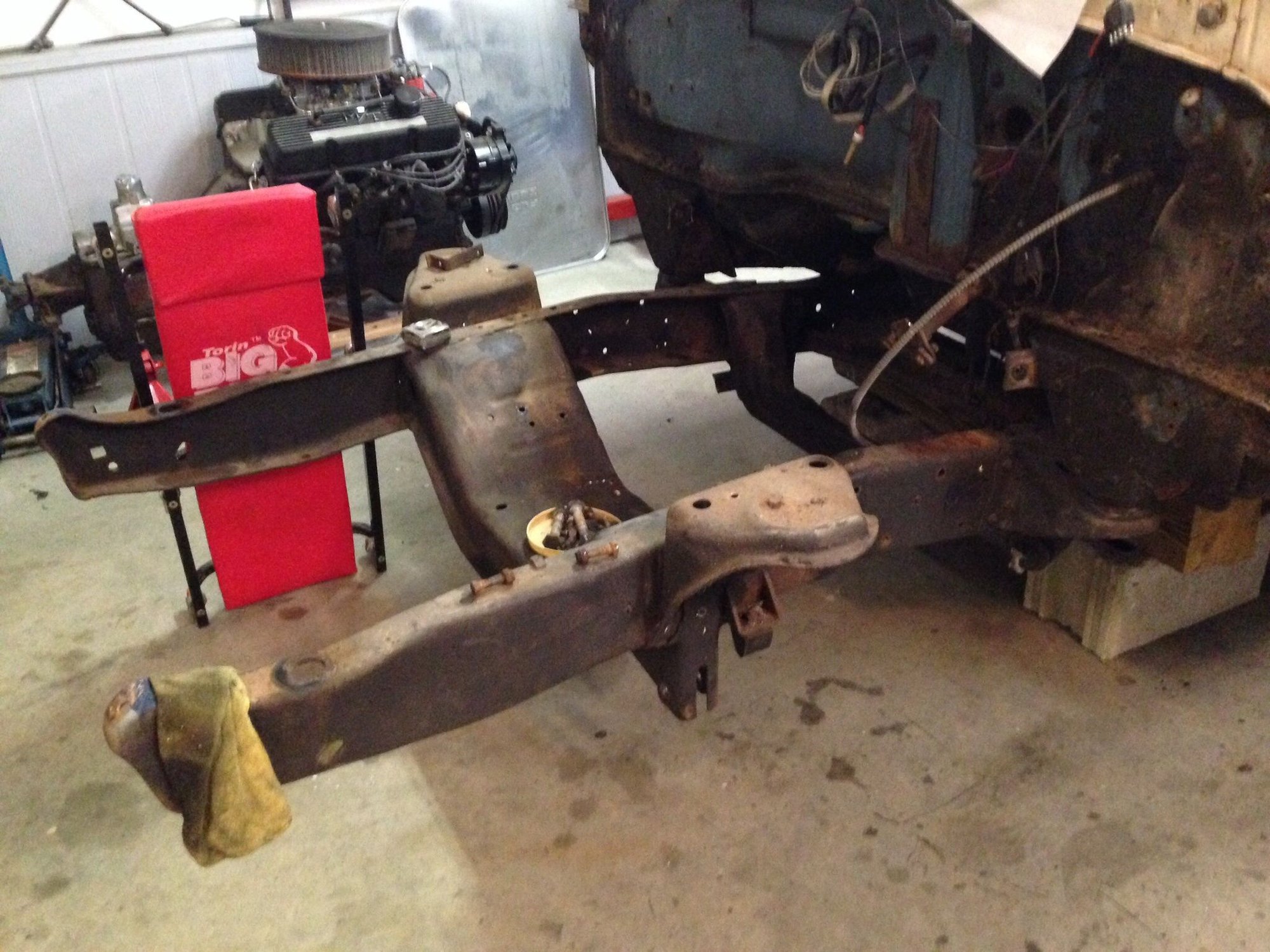

Fenders off, engine out and time to remove the front crossmember and prep for a crown vic front suspension
The crossmember is gonna be a challenge.

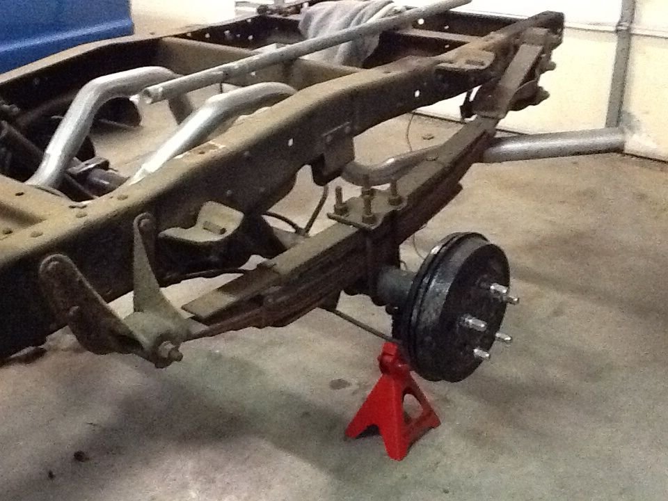

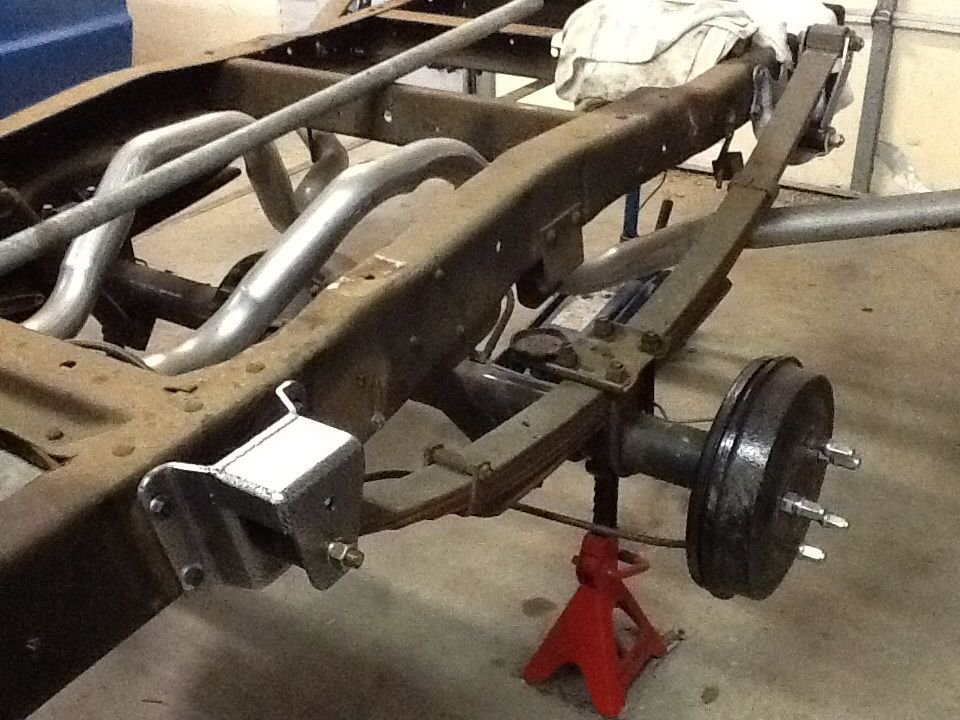

Rear end drop by removing the old and adding some parts from JDM Suspensions
This gives it a 4 inch drop to try and maintain the same rake when the CV is installed
I am doing this after a lot of research and several phone calls to my brother who is a fabricator in NC. Thank god for his talents he keeps me advised along the way, it's like ask a nurse for cars.

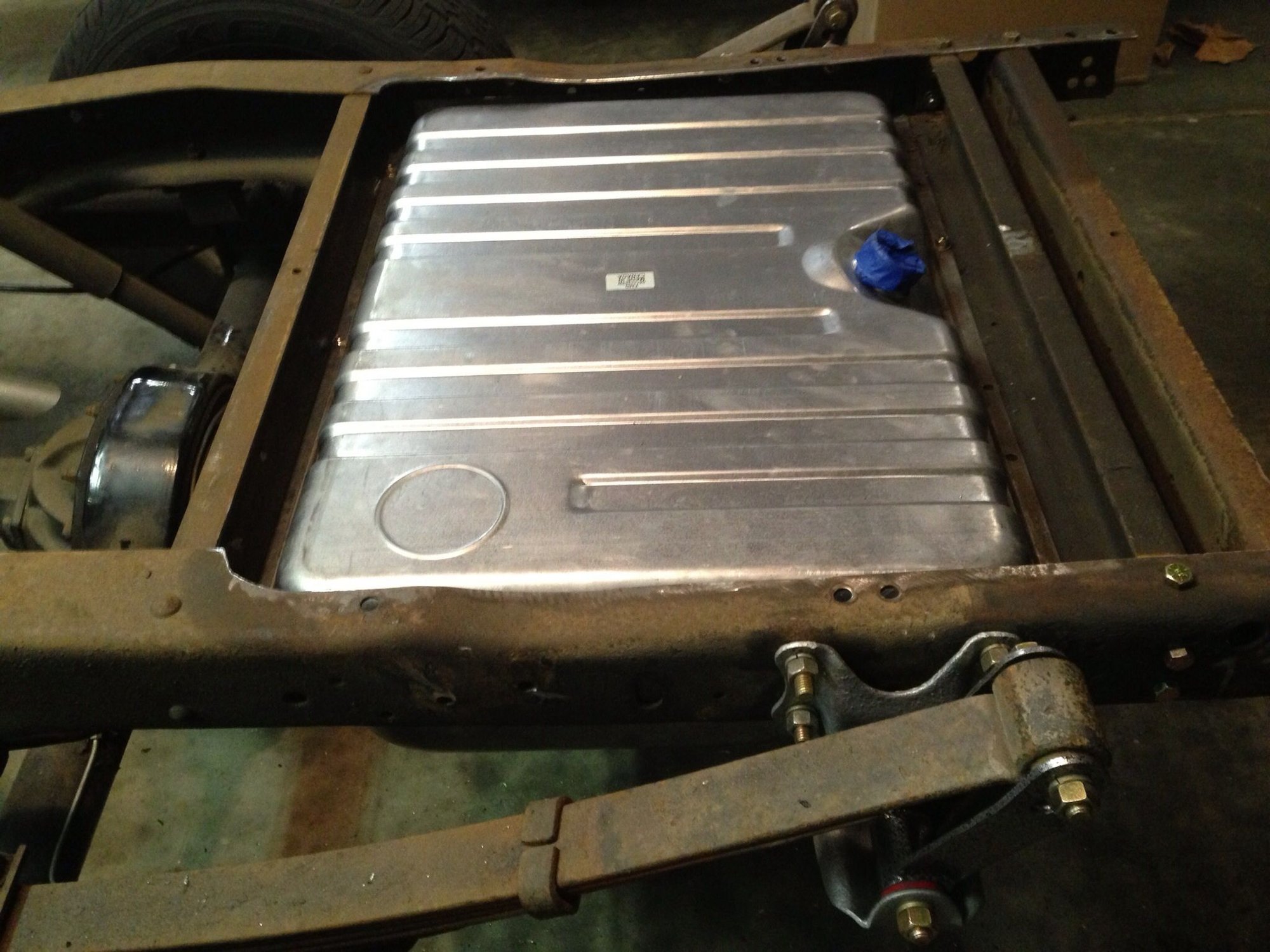

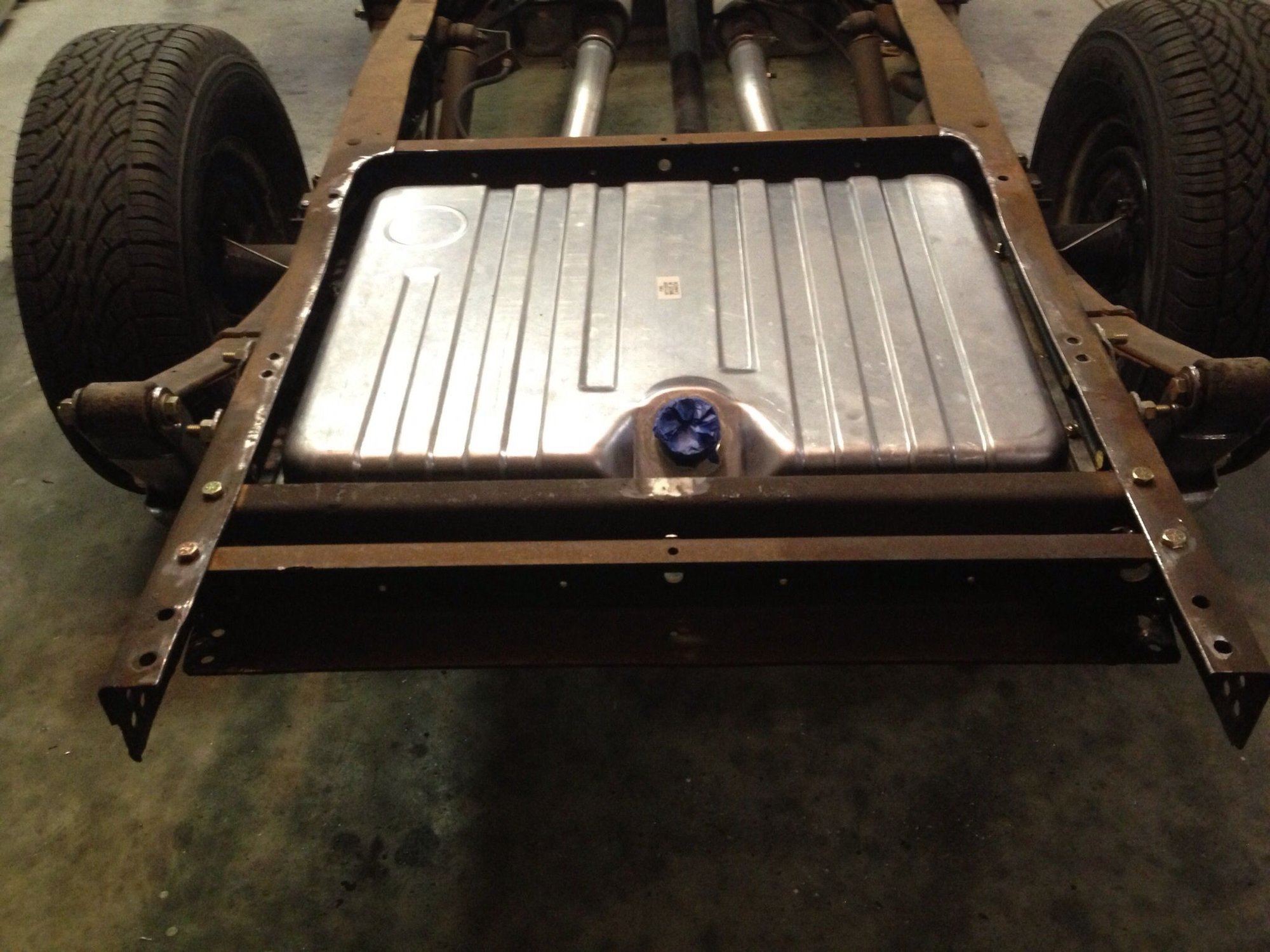

While the bed is off we decided to move the tank, a mustang tank fit between the rails after removing/relocating cross members and trimming the frame it fit

How do you plan on filling the tank ? In the bed or pull down plate like 1980's GM's

Through the bed, a flip up lid right in the bed itself....

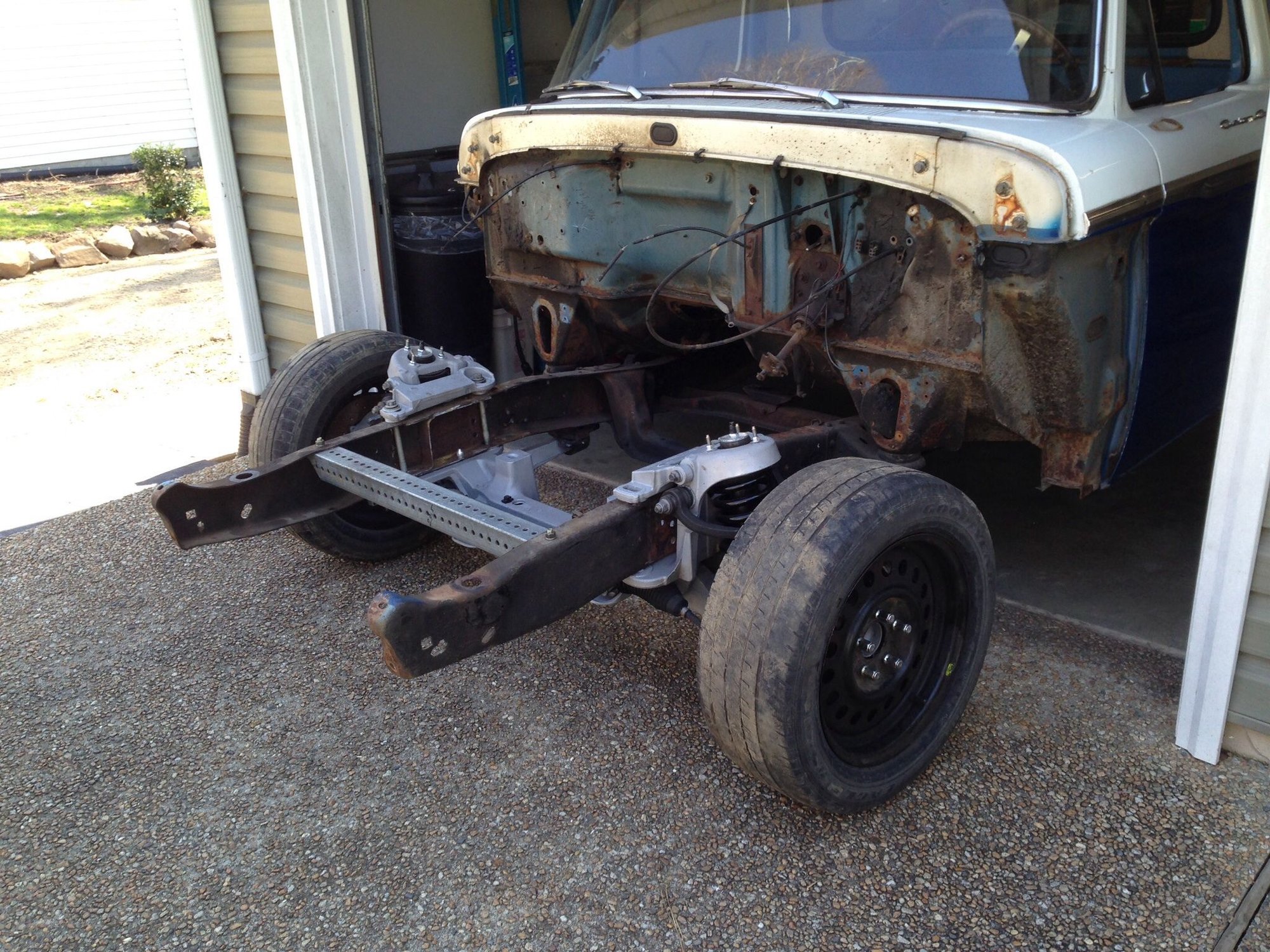

66F100
Crossmembers out a lot of cutting wheels on the grinder and some words that aren't normally spoken

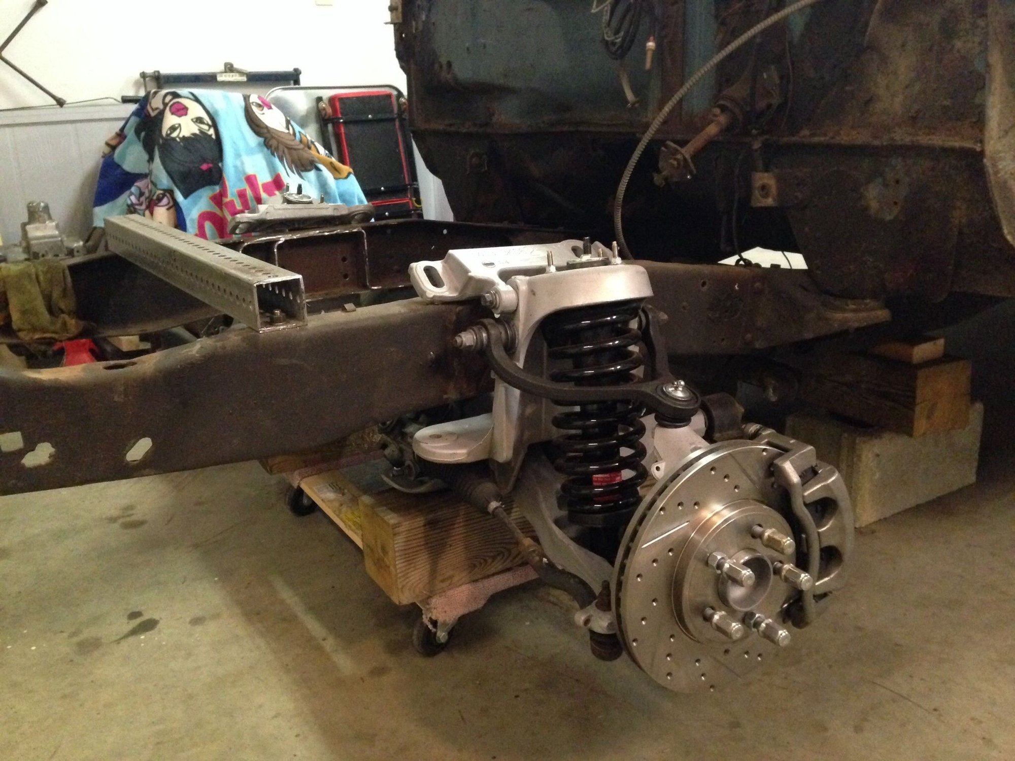

After several measurements, double triple and quadruple checks in various positions the CV is roughly installed
Old Blue rolls out of the garage with a new front suspension.......

The crown vic front end was purchased from a local scrapyard, cleaned up and some updated parts.
Here is a good shot of what's coming out and the replacement, everywhere I read says that the difference is unbelievable. Rack and pinion, disc breaks, better handling.

What did you use to mount the trailing arms? I gotta tell ya, I'm struggling with doing this swap. I REALLY want to lower it as low as the CV front end will take it. My problem is with not being able to put Cragar S/S rims on it once the front end is installed so that I can keep it with the 70's look.
