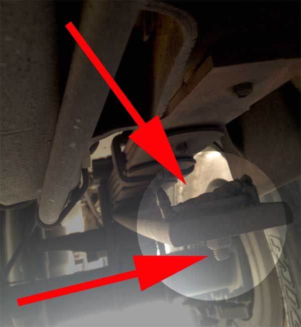

I pulled out of the driveway and saw that my 2001 4WD 7.3L Excursion had left me a gift in the road. It looks like it came from this location below as everything else looks fine. The one on the other side rotted off already.
What part is this, and where can I find a replacement. Its not a "bump-end" as that would go right above the axle, as opposed to the [auxilliary??] leaf.
What is this part? It is on the part of the leaf spring that hangs down. This is a view of the excursion from underneath the left passenger door, looking back

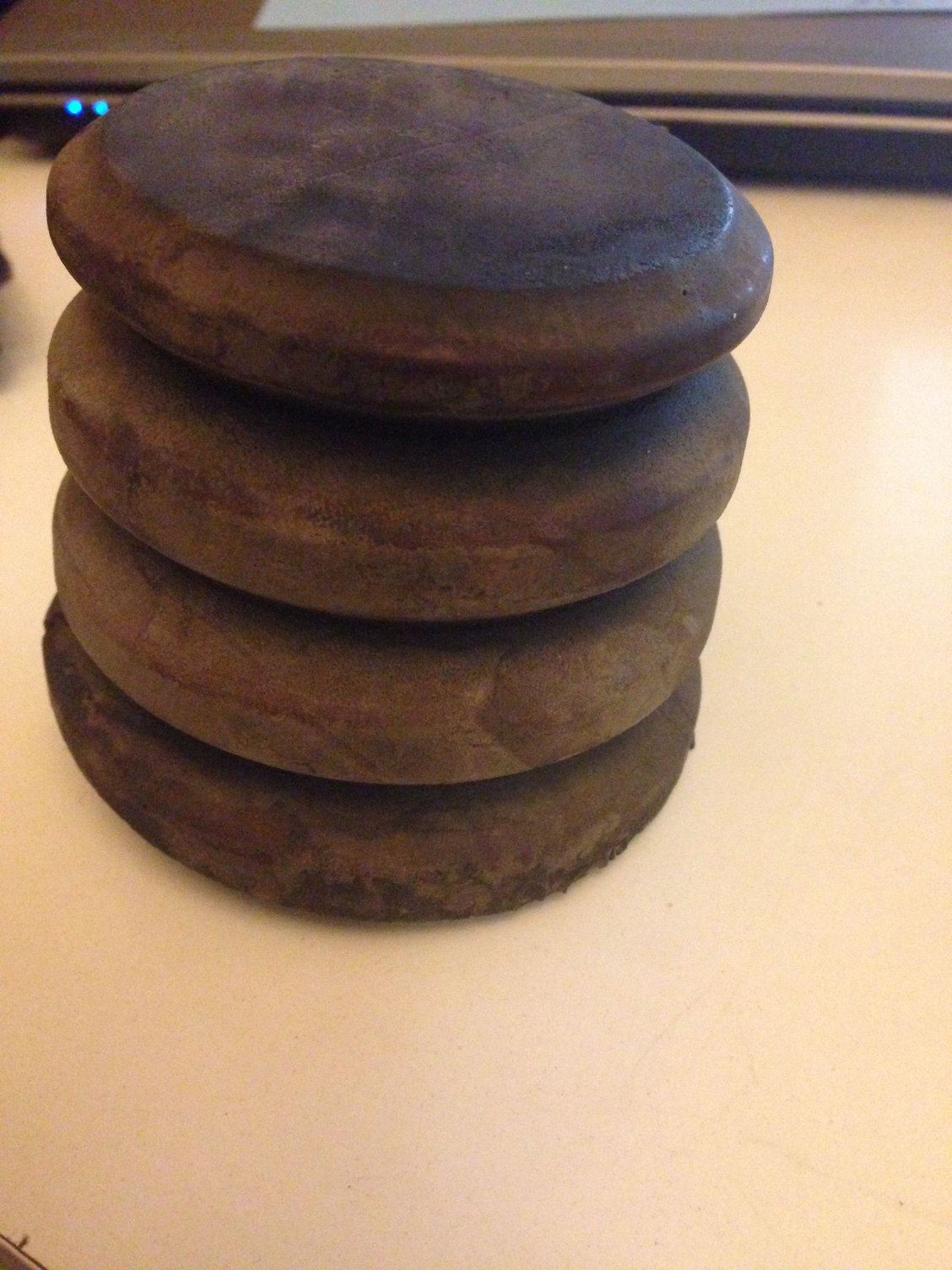

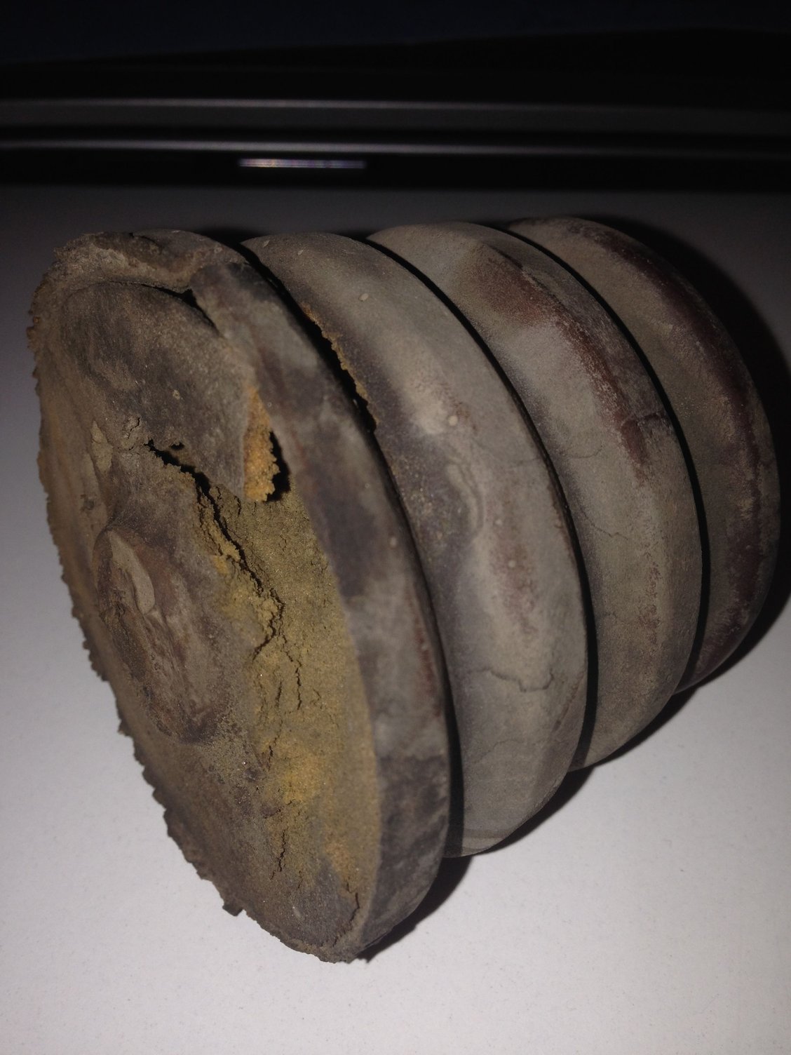

This is what the part looks like that I found in the road.
Is this the correct part I should get?

Looks like a leaf spring bumper but all the ones I have seen are rather pyramid shaped and not round. maybe these:

That one in your link goes over the axle. It is a different part. This one is at the end of the leaf, and I could not find it in the diagram.

I noticed that the one you have sits on the first leaf, I have never seen one placed there. I will go out and check my service manual. Not sure that is OEM as I have never seen one mounted at that location but I also don't own an EX but I will check

its rotted on the inside and is falling apart.

What you have there sir is whats left of a TIMBREN bump stop from their overload spring set up. By the look of it it is there old style. They say they have lifetime warranty, but whos lifetime is the $1,000,000 question.

Ah, very helpful. That is probably why the Ford parts guy gave me the blank stare when I brought it in. I will try calling them tomorrow.

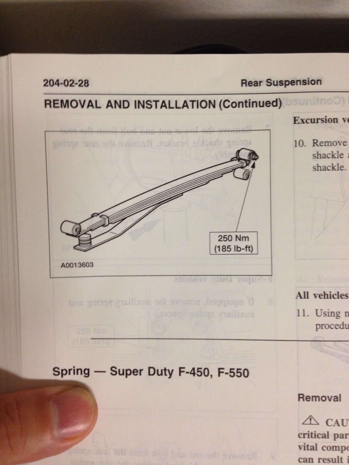

Here is a pic of what I think you are looking at:

Nice Dan. Someone must have swapped those rear springs from the F450-550 series prior to you owning it Kap.

I have that on my Excursion. The 2001 service manual shows excursions as having it. 204-02-29
