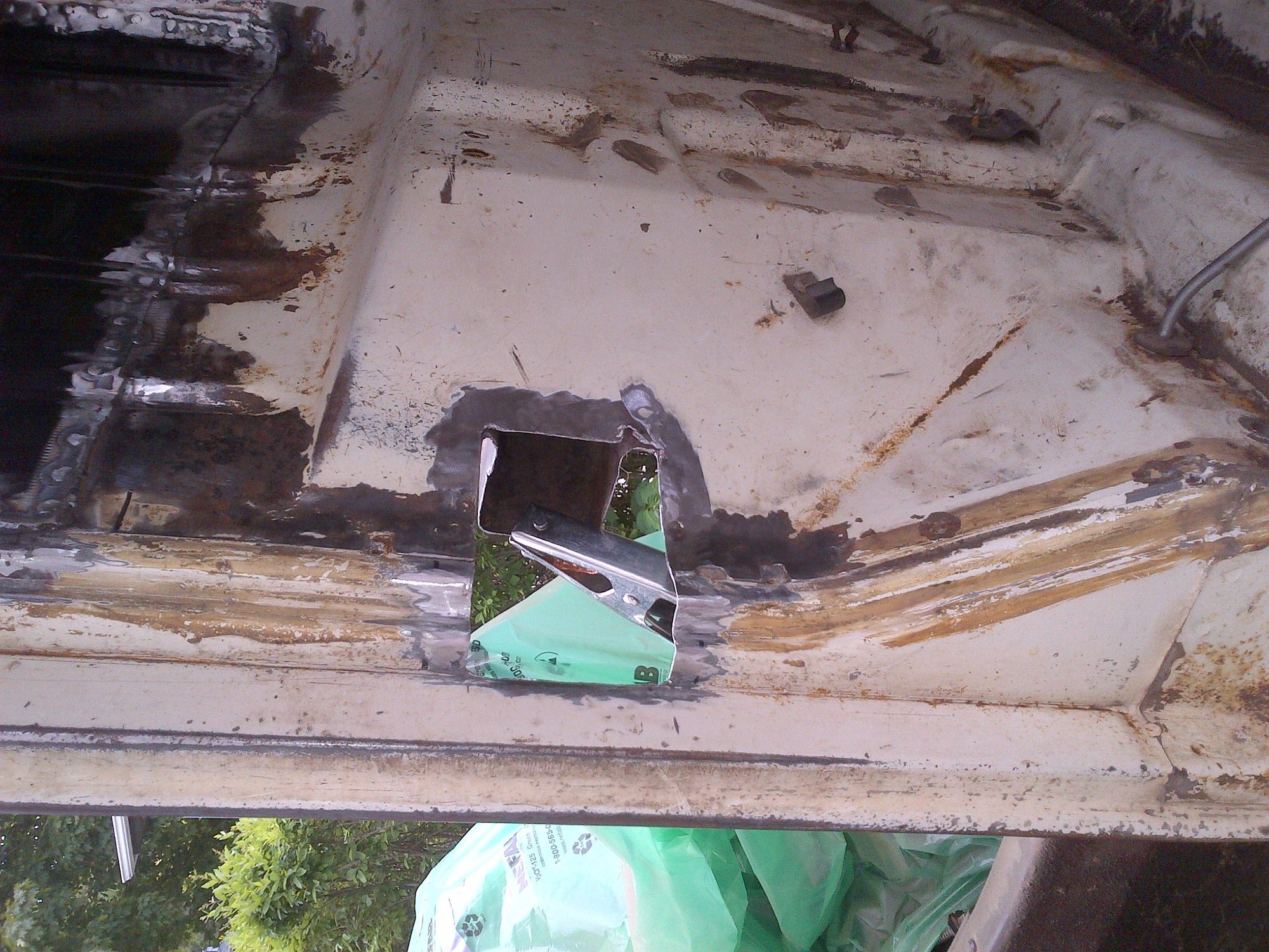

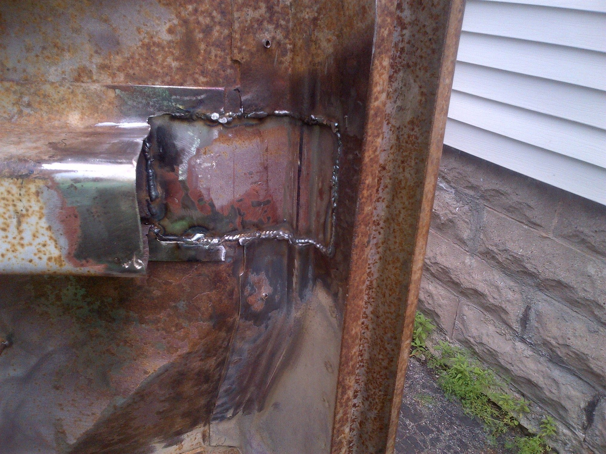

The last couple of weeks, I have really been getting at the truck. My son's buddy gave me a crash course with welding and it's coming along nicely. Here's what has been done on the driver's side.
Replaced the kick panel
Added the flange for the floorboard
Floorboard

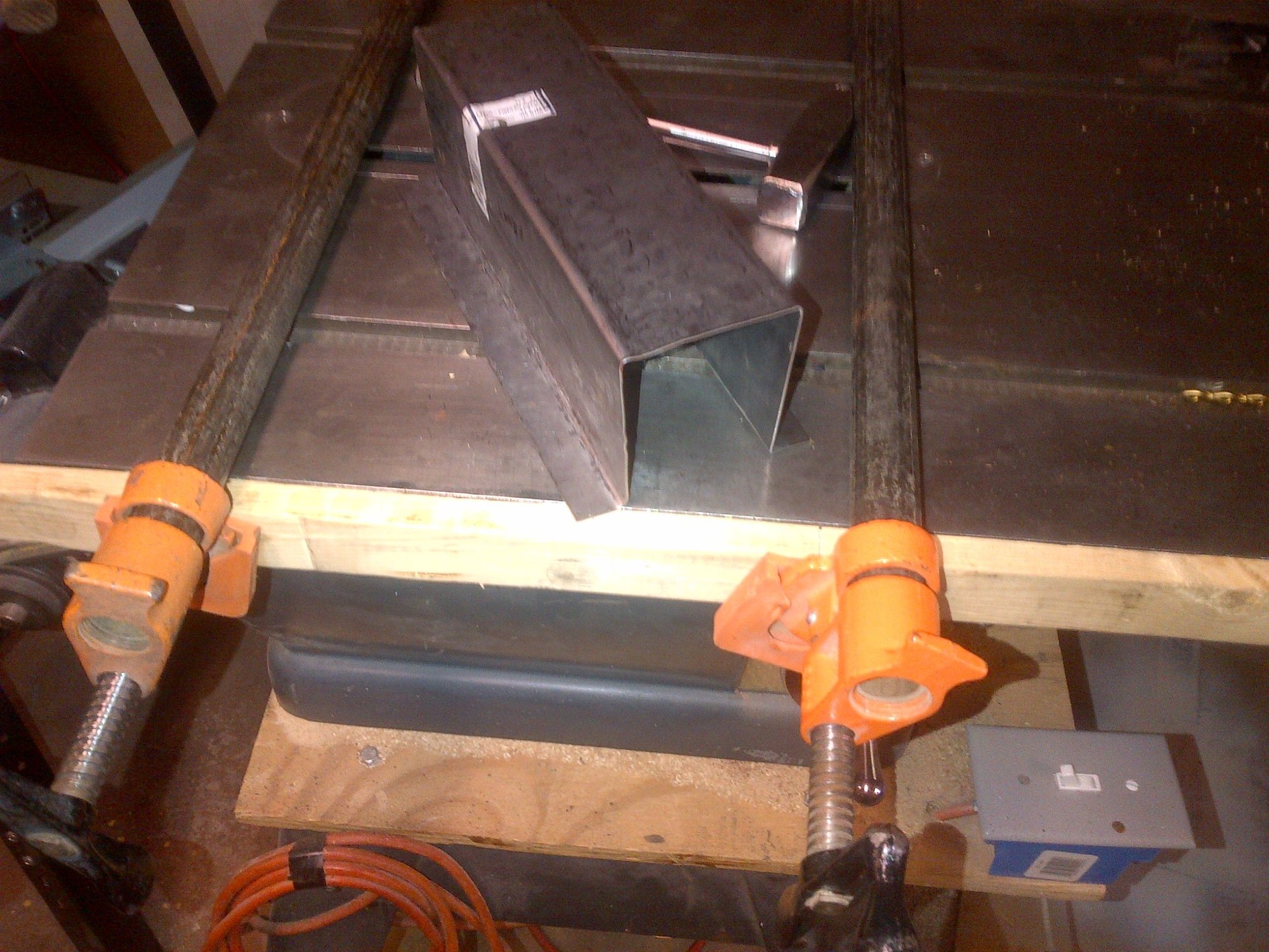

I figured while I was at it, I may as well replace the end of the support
Used some crude but effective methods to fab up the support.
Cab mount had POR 15 inside and out and then cleaned off the flanges. What do you think? Be honest, too many welds to hold it on? It will be getting POR 15 as soon as the passenger side is done. My fab skills need a lot of work, but as of right now, I only have to fab up about a 4" jamb piece on the passenger side. My hats off to you guys who can bend, shape and fit metal.

Kudos for picking up the welding gun.
And if ya aren't a good welder, be an awesome grinder!
For those lap joints and seams, I highly suggest: 3M 08656 Brushable Seam Sealer Gray

I think that cab mount looks fine! Remember, nobody ever had a part come off because of too many welds!
Welding is a skill that is learned by practice. I think you're doing just fine.

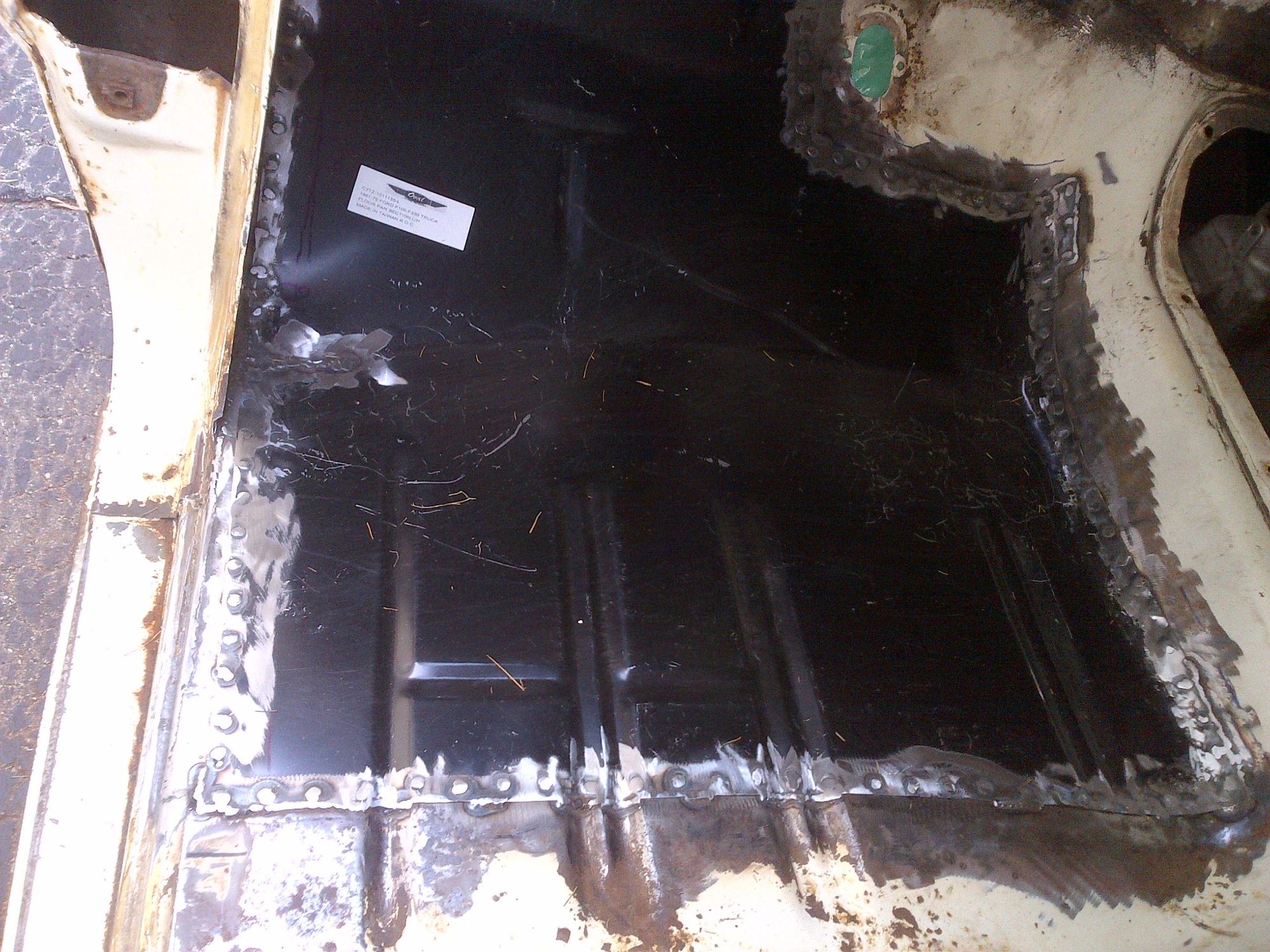

So I took a little more time cutting out the passenger side floorboard to give myself a more flat area to mount the new piece. I didn't want to short myself in places like I did on the driver side.
Rebuilt the rusted spot of the jamb seal area. This took longer than expected because I wasn't sure how to make the new piece. Ended up cutting 4 small pieces and welding them in 1 at a time. It came out better than I expected.
Also had to replace a piece of fire wall. Getting a little better at butt welds, but not confident enough in my fitting skills to butt weld the floorboard.
I will get some more pics tomorrow. I have the floorboard in, the cab mount on, and the underside wire wheeled and ready for rust proofing.

Nice work. you can also use like duraglass over your seams its some hard filler when dried so put on thin or get a nice cheese grader to ruff it in while semi hard.
