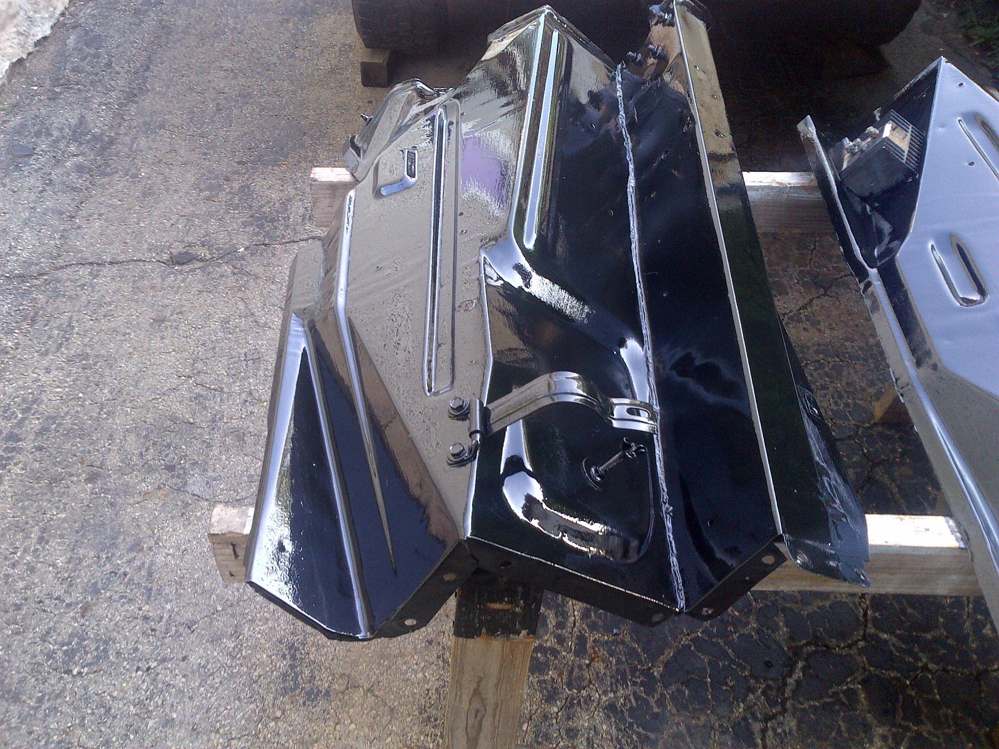

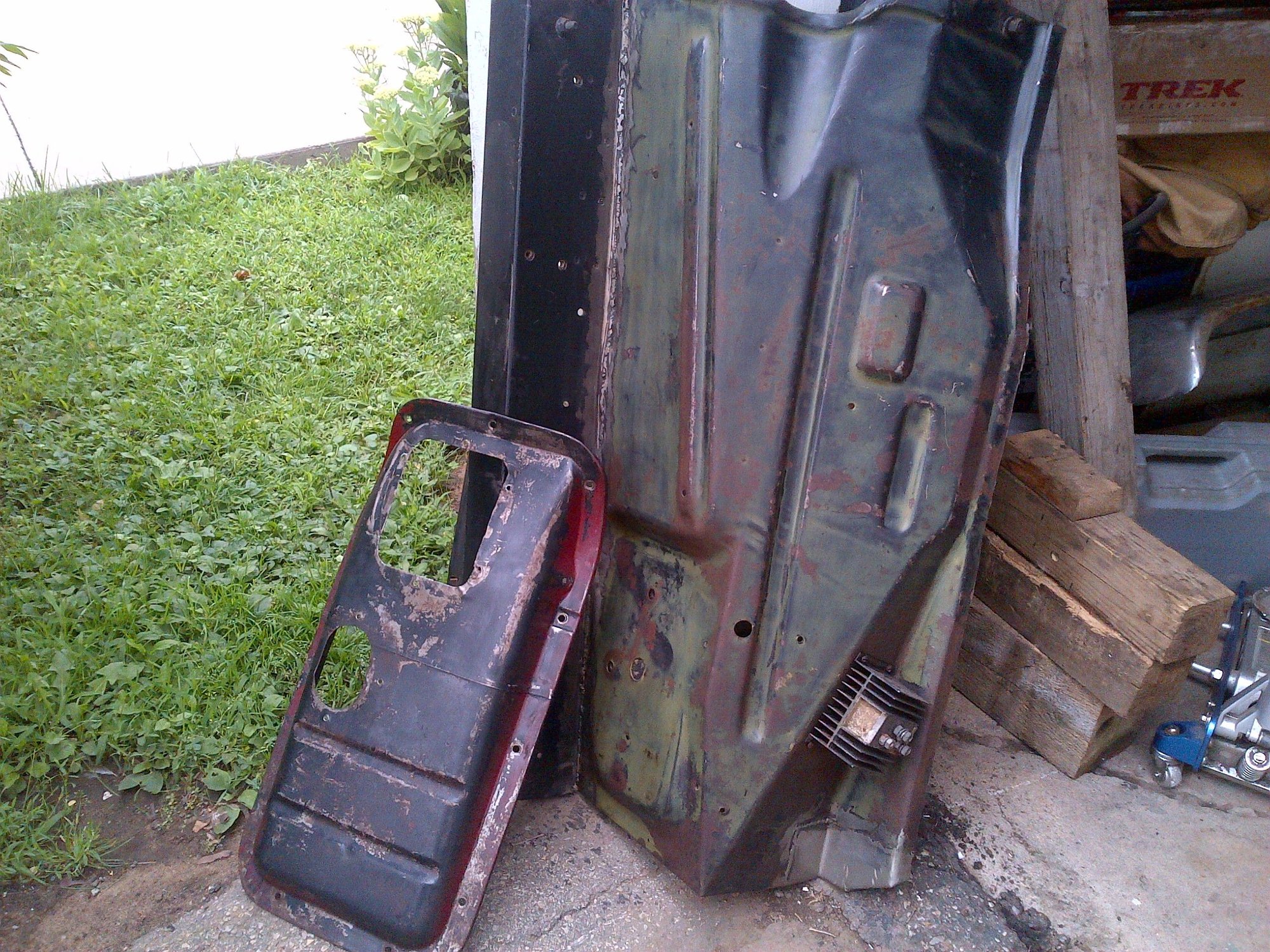

A couple of years back at a swap meet (before I really knew what I was looking for) I bought what I thought was a good set of inner fender supports. I dig them out of the back of the garage and it's only the top part of the support. Not the lower splash part. Look at the 4 inners that I have and I just can't use any of them. So I took the best 2 and cut the upper from the lower portion and welded on my swap meet "finds". What a pain. I kept blowing through for a few reasons.
1. The metal is thinner than 16 gauge and I just couldn't get the settings right.
2. I had to weld right on the 90 degree bend which meant the metal was even thinner.
3. I was trying to be very careful
After I did the first one, it was FUHGHLY. On the second one, I said screw it. Nothing a little grinding, seam sealer and por 15 can't cover up. I whipped that one out in short time and it turned out much better than the 1st.
It took me 1/2 the day just to clean them up for painting. 1 was nothing but dry surface rust that took hours with the wire wheel. The other was covered in cosmoline. Sure it may be a great rust preventer, but it is just nasty to clean up. De-greased, metal prep and por 15 on the inner fenders, tunnel cover, and inspection covers.
After clean up with patina. I kind of like the dark green patina look.
After rust proofing.

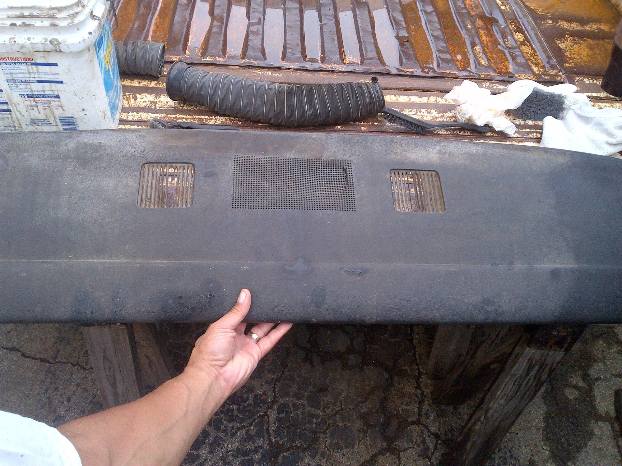

Dirty dash pad. I used a hard plastic brush, warm water and soap to get it clean. Armor All after it was dried and it looks almost like new.

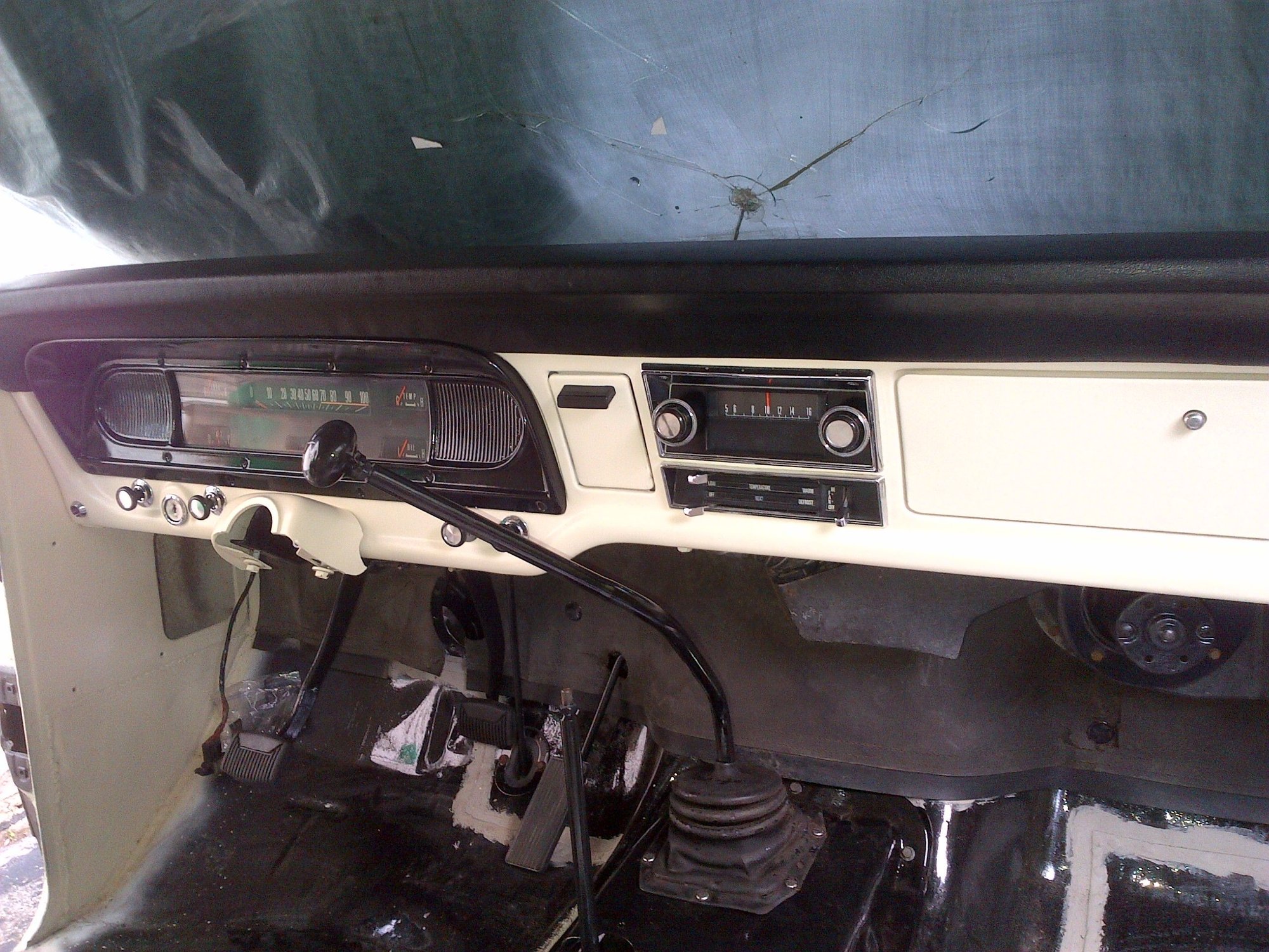

Does anyone know from the pictures below, what the bracket just behind the steering shaft is for?
The hole in the firewall in the center of the picture, I can't figure out if anything should be running through there.
