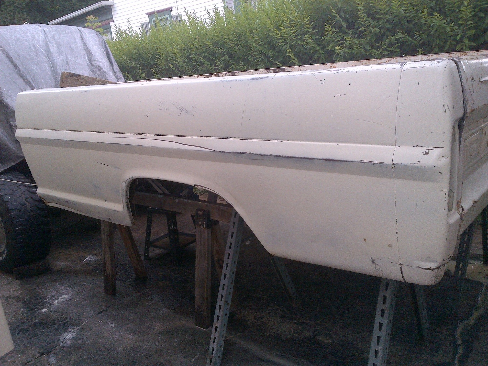

I bought 7/16 -14 x 3" bolts for the front and 7/16 -14 x 5" bolts for the rear and got that thing mounted. I did have to cut the front sleeves almost 1/2". According to my measurements, I am dead nuts on left to right. I feel that this alone is my shining moment on this truck mainly because of never having done any metal work before.
Other things done
-painted instrument panel (sanded with 320 and scotch brite pad. 3 coats of primer, 2 coats of black and clear coat) Mixed and matched the better bezel, plastic and gauges. I prefer the Oil and Alt gauges vs the idiot lights.
-buffed panel plastic (wet sanded with 1200 grit and used 6" buffing wheel on my drill to buff. I went too hard too fast in some spots which bubbled the plastic so I had to re-sand)
-painted stick shift (sanded with 320, 3 coats of primer 2 coats of black and clear coat)
-cleaned up cab and front of box with the abrasive powder
-mounted box (that is one heavy sumnabeotch) I told my son the last heavy lifting is when we mount the hood.
-went through the wiring harness (really good shape actually)
-rear wiring - there were so many cut and twisted spots that I decided to cut them all out and splice in one piece. All I have left to do on this is tap into the brown wire for the license plate lights.
-piled up pieces to be cleaned and painted (tunnel cover, cab mount covers, and 4x4 shifter)
