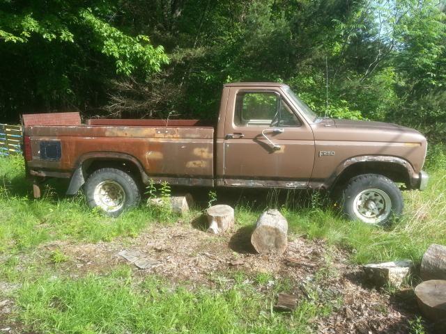

I found this 85 (again) f 250 4x4,300-6, 4 speed (I haven't taken time to notice which one).
most amazingly the dashpad is perfect !
im getting a better bed tomorrow from the previous owner, he wants the lift gate which I have to use for.
I also need tires dry rot wheel rusted been sitting in the woods since 2006.
anyone got ideas for exterior color?

Brown is a great color. Especially when paired with tan in a tu-tone configuration......

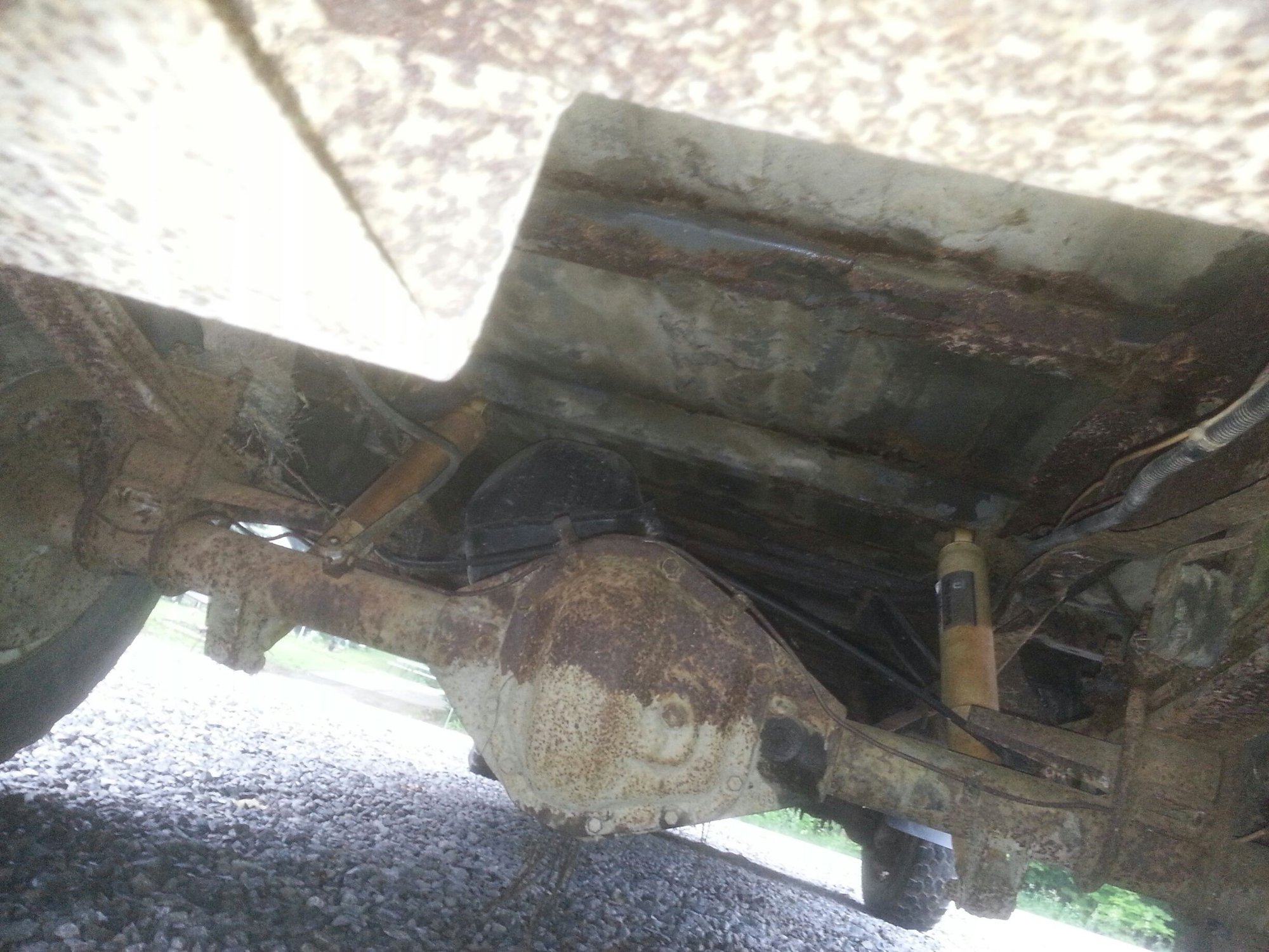

Is that a semi-floater rear axle?
Idk like I said I just got it today really hadn't had time to look at it too hard.the owner said it was a heavy three quarter ton confirmed by the DMV. He also said it was a full float rear axle....

It's very easy to see if it's a full floating axle, just look at the center of the rim at the back. Looking at the picture, it looks like a semi-float to me also. There is no large hub sticking out of the center.
The VIN may reflect that it's supposed to be a full-floating rear axle, but these trucks have 9 lives and during some them things are swapped.

d44 ?

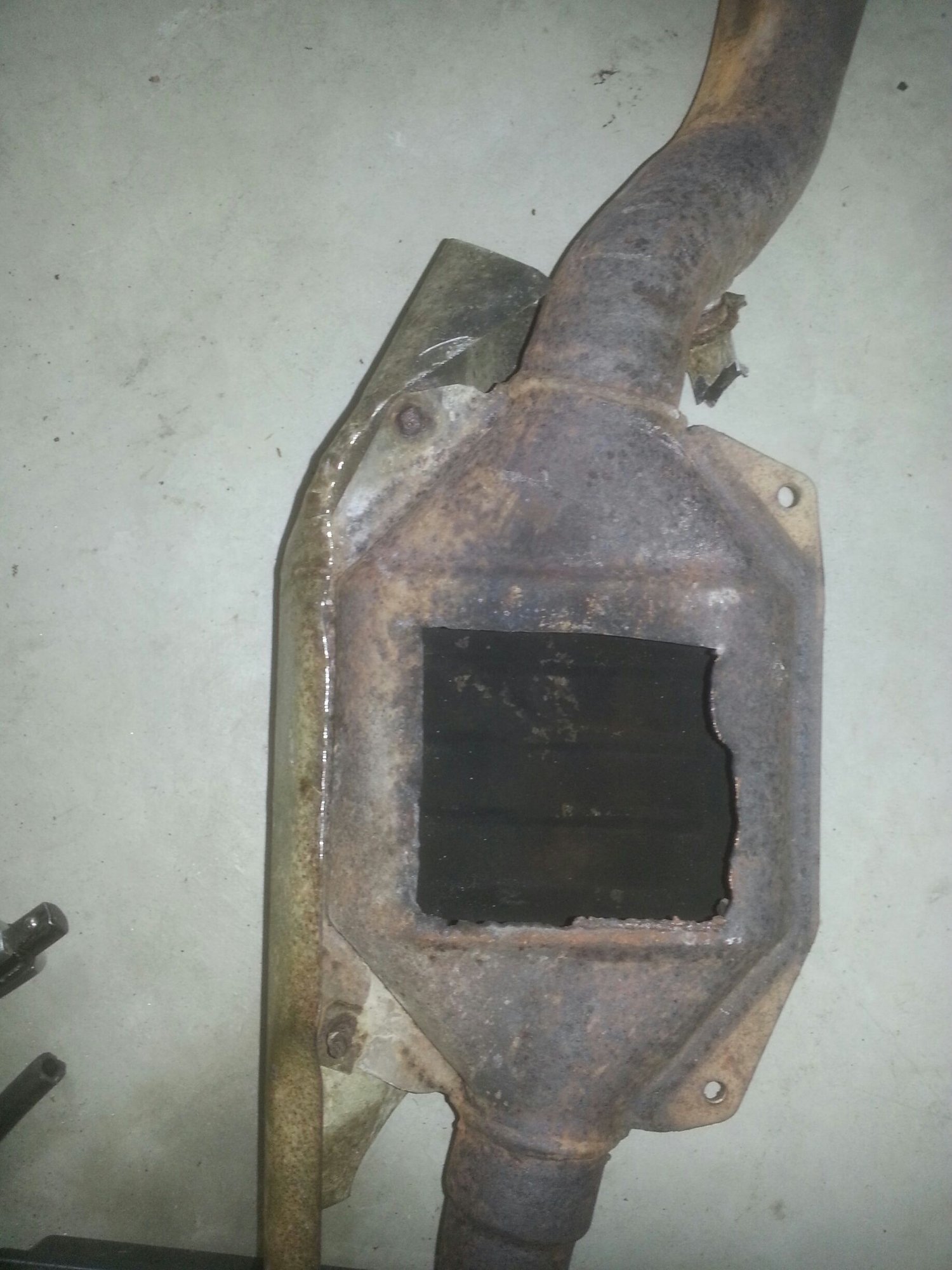

also prior to my taking possession somebody stole the guts from the converter...

Looks like a D60/61. D44 was used under some 1/2 tons for the rear, back in the 70's, but I don't think it was ever offered as an 8 lug rear axle. And, that ain't no D44 cover.
As for the convertor, don't need no stinkin' convertor.........

No need for that piece of communist honeycomb welded to the exhaust pipe, that makes the air cleaner. It'll run better without it anyways.

D60/61 huh ok thank you ! fordfe
and I agree but for inspection here in pa if it came with it has to have it.
visual insp only.
no sniffer testing tho...
