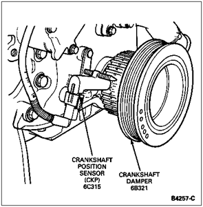

The P320 code is where I would start. That code may indicate there is a problem with your ignition system.
P0320 = Ignition Engine Speed Input Circuit Malfunction
"The ignition engine speed sensor input signal to PCM is continuously monitored. The test fails when the signal indicates that two successive erratic profile ignition pickup (PIP) pulses have occurred."
Note: The PIP signal is generated by the crankshaft position (CKP) sensor.
Possible causes:
- Loose wires/connectors in PIP circuit,
- Arcing or misconfigured secondary ignition components (coil, wires and plugs - see below),
- On board transmitter (2-way radio),
- Failing crankshaft position sensor
Double check the plug wire configuration. If it's a 3.0L or 4.0L, see Coil Pack Spark Plug Wire Diagram and Cylinder Identification
