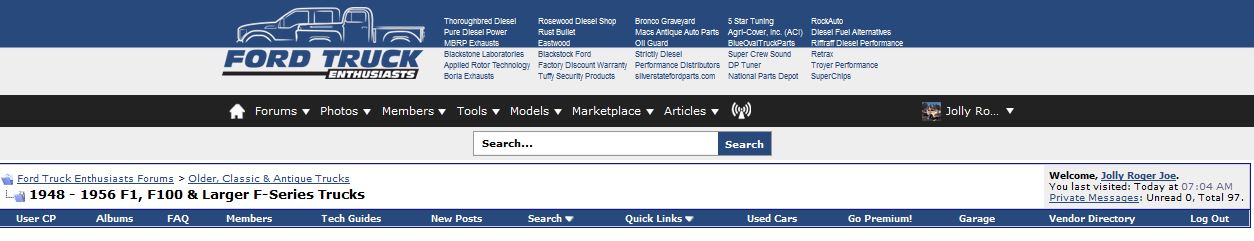

I think you need to have 5 posts on the site before you can use the search function. I know the seats topic has been thoroughly discussed on here, and lots of folks have made the switch to non-stock seats with several consoles.
When you can do a search, use the "Advanced" search function.
Go to the top of the forum page and select Search / Advanced Search / Seats / this forum. You'll have to read several posts, but it's also a learning experience. I find myself getting lost in subjects other than what I was searching for because of all the knowledge shared on this site.
Search is in the middle of this page.
