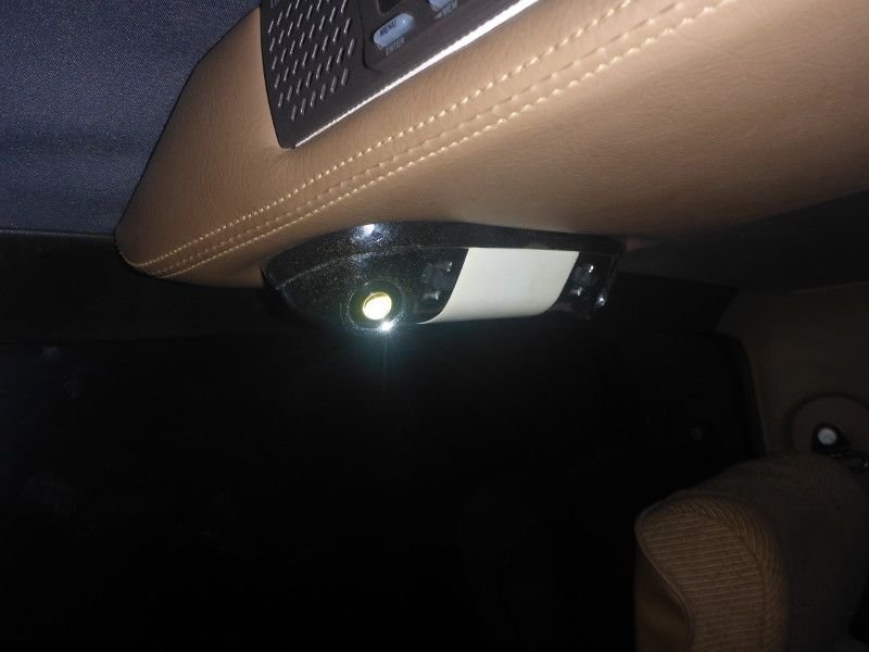

Light in fitting:
The light is not on in the above the sparkle is from the camera flash.
How much it lights up.
This was taken without flash and only the map light on. It is daylight in the shed so you can see all the background but the area the map light covers can be seen. It's the blueish area in the photo.
I'll try and get a night time shot tonight.

Looks good. Thanks!

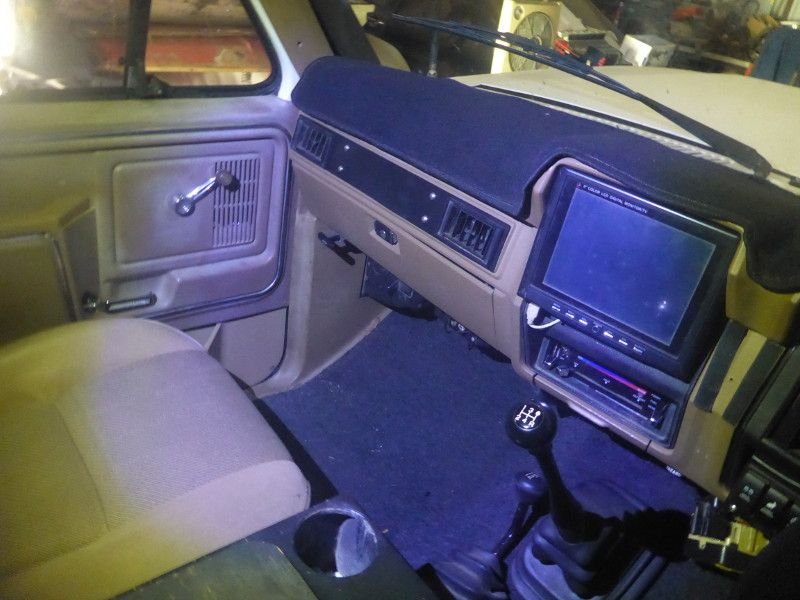

That's very interesting, thanks for sharing. I just looked up your Efii thread and enjoyed a very impressive build. You have a very unique truck. From the photos above it also looks like you have a custom center console and a custom overhead console. Do you have a thread on those?

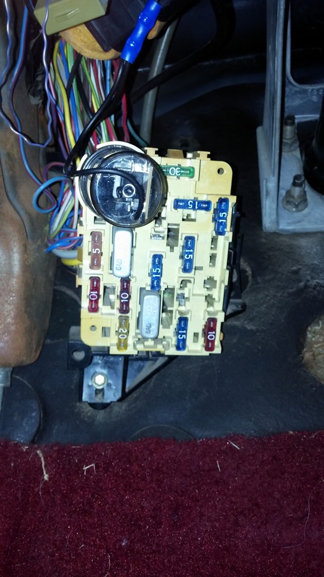

Followed your post to the "T" and it all worked out great! Thanks for all the work of posting in the detail you did! I now have all LED except headlights on the outside of the truck!
Oh Yeahhhh!!!!
New Relays in...
Fuze box lid cut to fit on securly

The console is custom made by
"Department of the Interior"
They are in Australia.
No build details for the centre console as it was done when we first bought the truck in 2007. Basically it's a wooden box with a hinged lid and cup/bottle holders. It's got 12v and usb charging sockets in it. I'm looking at shortly doing some changes to it so will post them when I do.
