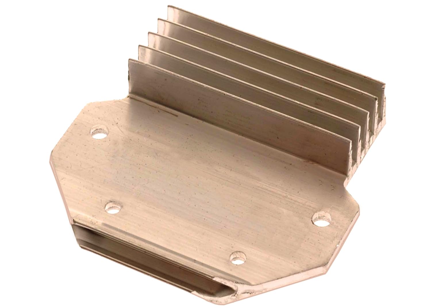

I originally made a heat sink from a piece of 1/8" aluminum flat stock I had. Just replaced it with this:
12 bucks from Amazon. I guess it's made for a stock GM module and it doesn't quite fit an aftermarket module, but it only took a couple minutes to drill some new holes.
Amazon.com: ACDelco 10474610 Ignition Module Heat Sink: Automotive
I have some old junk electronics I haven't tossed yet maybe I can find something similar inside.
