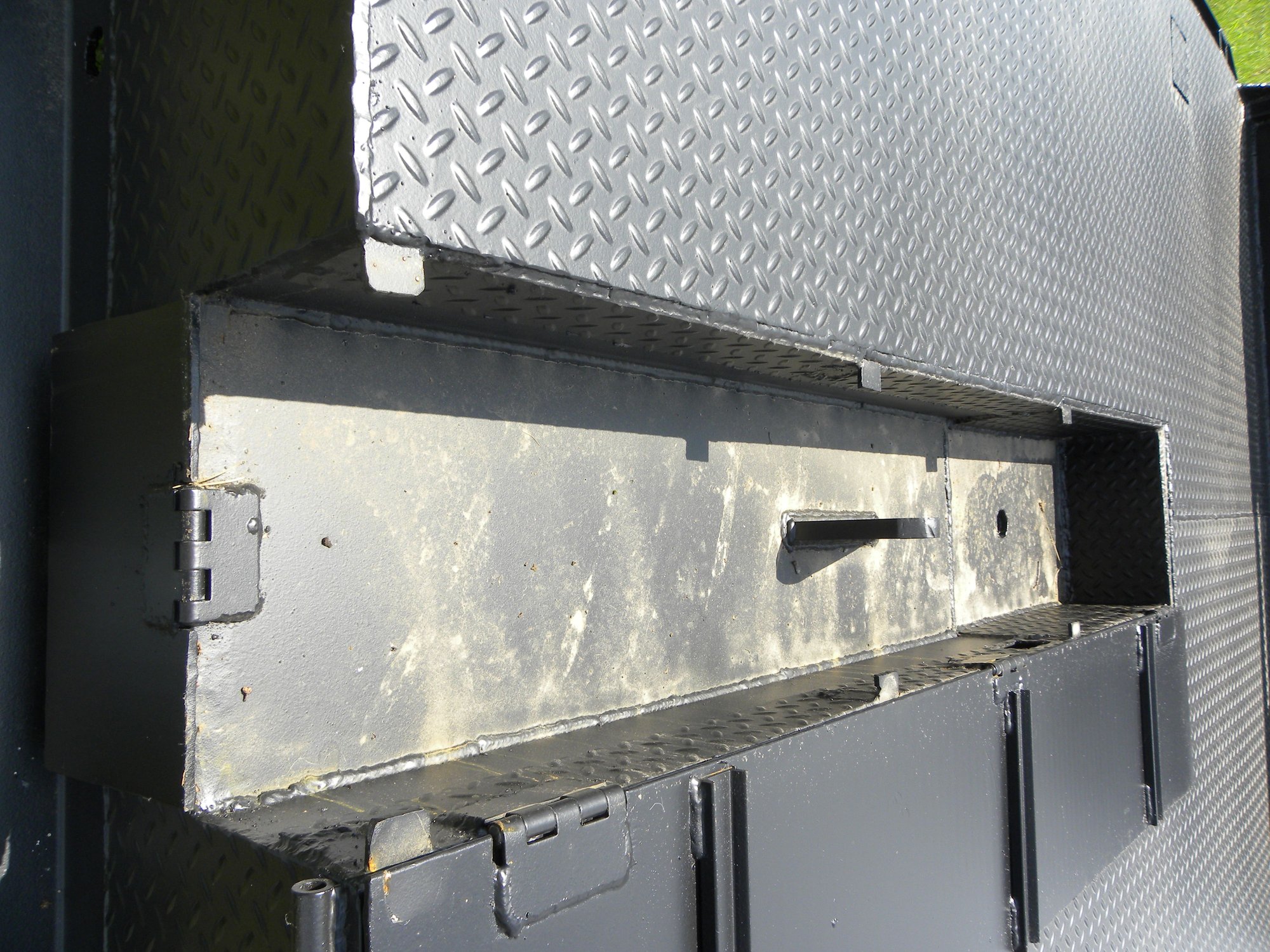

little flap to cover the back of hide away space

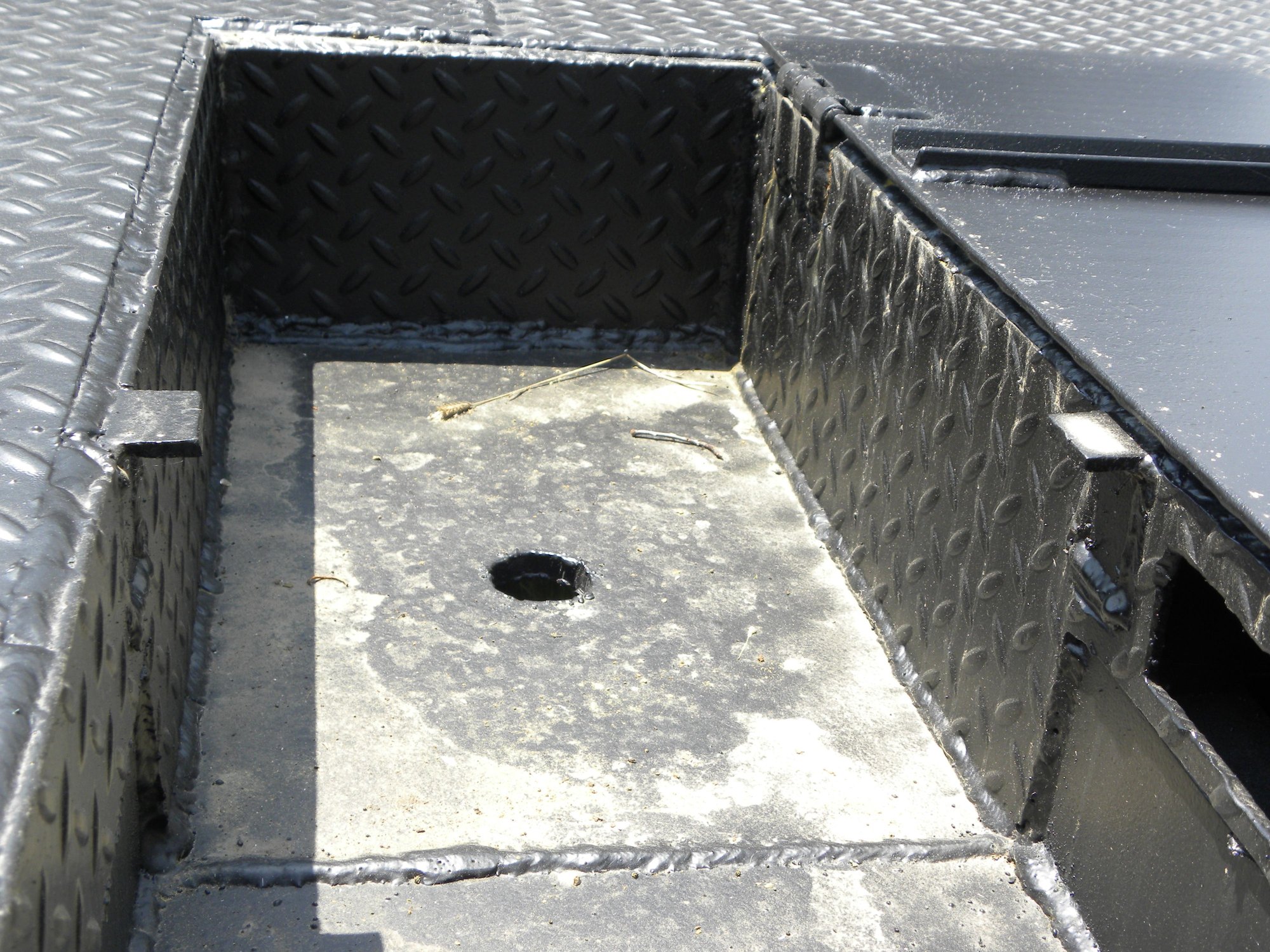

hide away space for the hydraulic cylinder and gooseneck hitch
Gooseneck ball hole and cut out for hydraulic hoses on the right

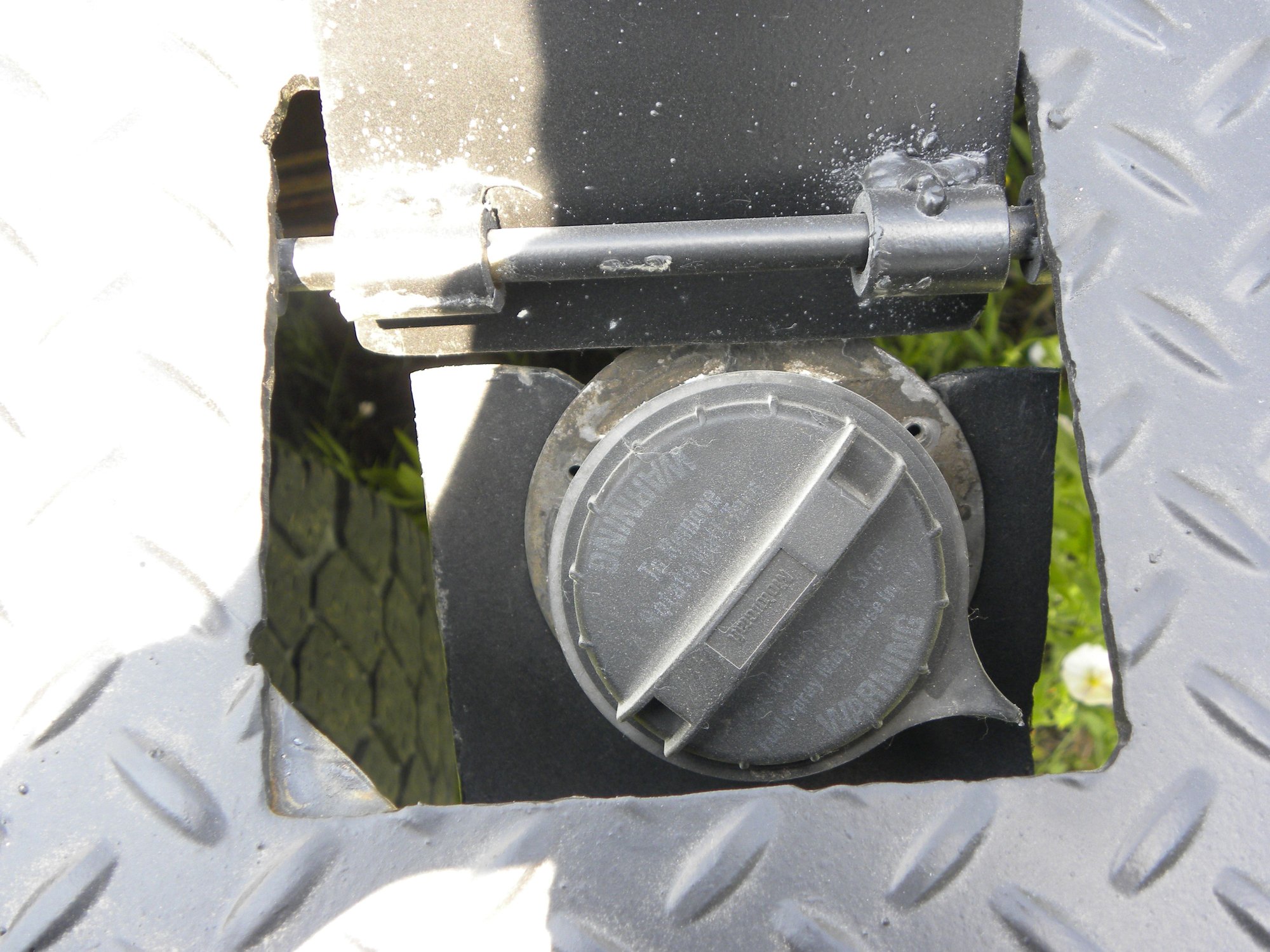

fuel filler set up, it's primitive but it works
fuel filler bottom view

That's a great job! That's the way we do all the filler necks on the farm trucks that have flat beds and it is the way that works the best. Anything else and you need to carry a block of wood to drive up on every time you get fuel. You need to go into business building those beds!

Nice work! That's the first time I've seen a cover for the gooseneck trough like that. Definitely a good trick. Keep us updated
