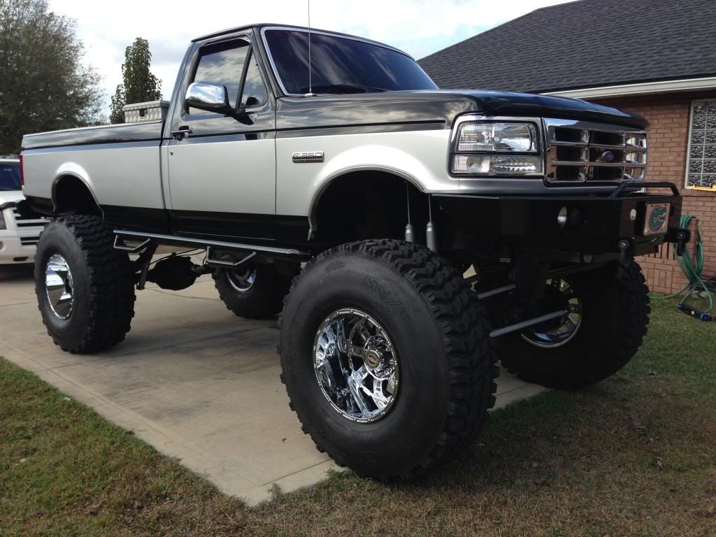

On my 1997 F350 with the MAF 460, I want to remove both my tanks and install 2 fuel cells in the bed. Main reason is I need the space to finish building a sub frame.
I am fairly mechanically inclined, however I have no real experience in doing this. The RCI cells I want to put in are 19 gallons with 0-90 ohm sending unit. Will this be compatible with the factory setup so as not to cause goofy stuff to happen? What all would I need to get it done (fuel lines, pump, etc.)
Any tips, advice, pointers etc. would be appreciated. Thanks.
