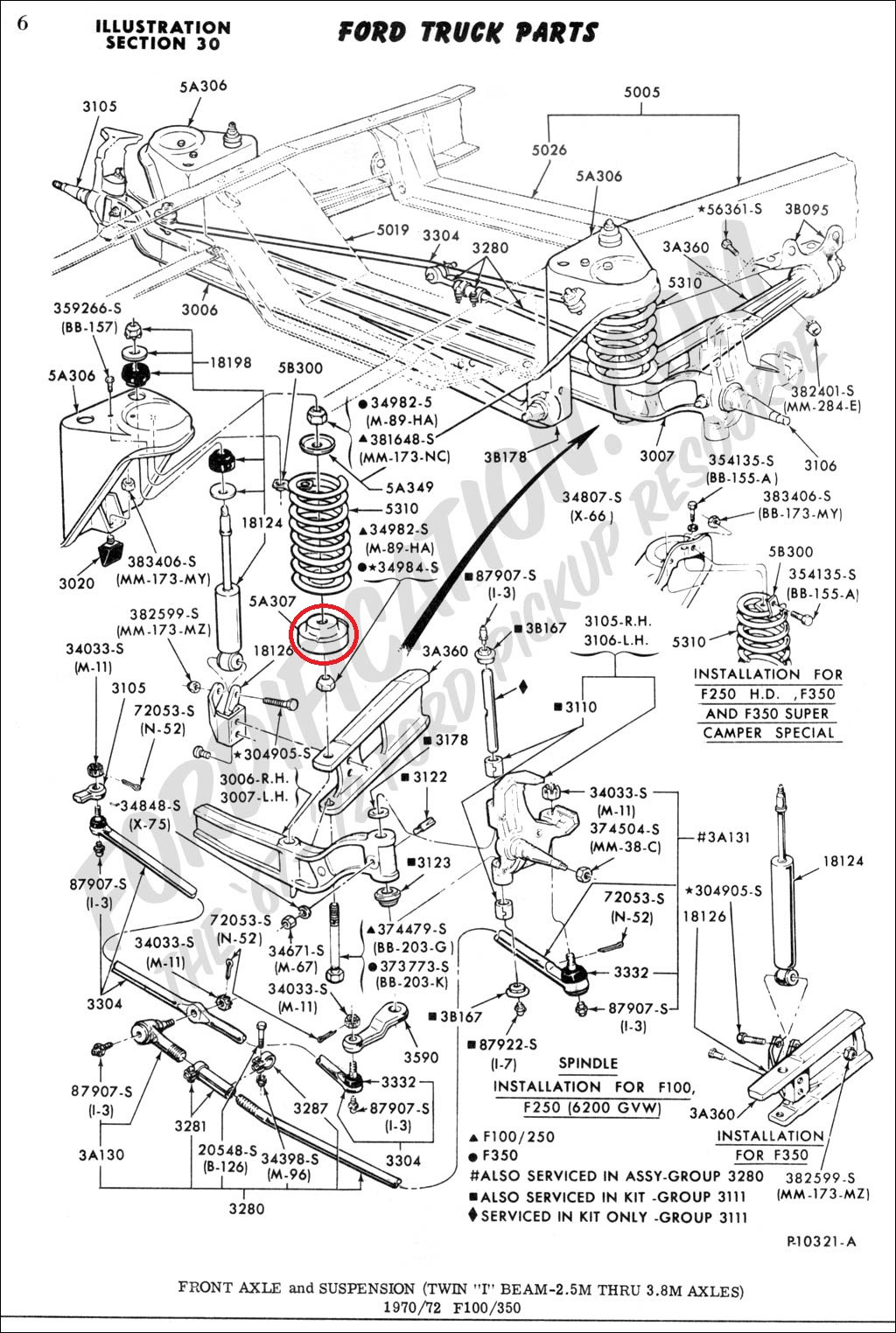

What is this rubber boot called?
Old Mar 15, 2014 | 11:16 AM
SoCalExile's Avatar
SoCalExile
Joined: Nov 2009
Posts: 125
From: TX
The circled one:
Trying to find a replacement.

That's not a boot and it's not made of rubber... at least on these Bumpsides. I refer to it as the coil spring seat. 5A309 is the coil spring retainer (a large metal washer)..
FYI.. later Econolines had a slightly different spring seat with a hard, nylon-like insulator to reduce vibration. They can be retrofitted to Bumps but you'll need both the seats and the insulators because they dimensionally mate to each other.

Originally Posted by SoCalExile
The circled one:
C5TZ-5A307-A .. Seat-Front Spring-Lower / Right/Left same / Obsolete
Applications: 1965/73 F100/250 2WD
MILLER OBSOLETE PARTS in Binghamton NY has 1 = 607-722-5371.
SOEBY MOTOR CO. in Walhalla ND has 1 = 701-549-3711.
BOWMAN SALES & SERVICE in Bowman ND has 1 = 701-523-3257.
GREEN SALES CO. in Cincinnati OH has 5 = 800-543-4959.
