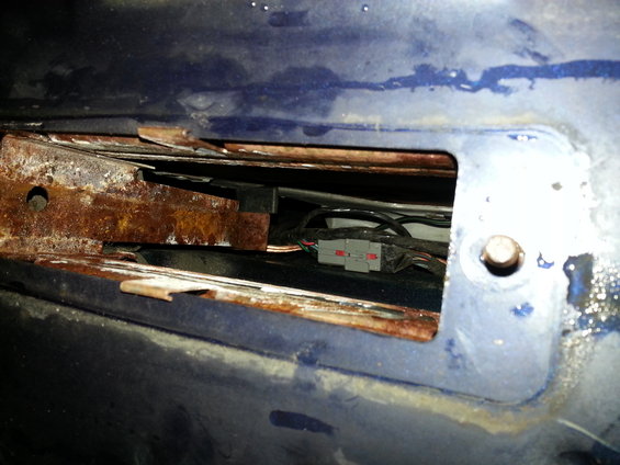

EEC slot - If yours is rusty like this, you need to find the water leak before it kills something important.
