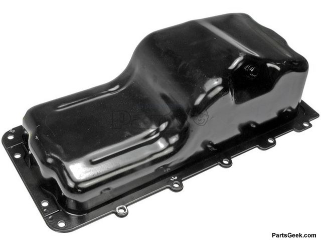

exhaust manifold gaskets .. 195* thermostat ... exhaust manifold studs and nuts.. ( they wanted $2 per stud and $1 per nut lolololol) serpentine belt ,, i ended up needing this http://www.summitracing.com/parts/flx-3967/overview/ cause i ****ed up the old one removing the old motor .. getting some energy suspension bushings for sway bar ...
also i noticed that the pully width is different between the truck motor and the van motor also the oil pan is different .. the van one is wide and not to deep .. the truck one is wide but is a little narrower then after the cross member it is a bit deeper..
here is the truck one
and the van one
but from what i can see it should still fit

Hmmm
Never been under an F-Series so can't really say for sure why the pans are different---assuming the cross member is in a different position relating to the engine?
This shouldn't affect the oil filter rail on the lower left should it?
