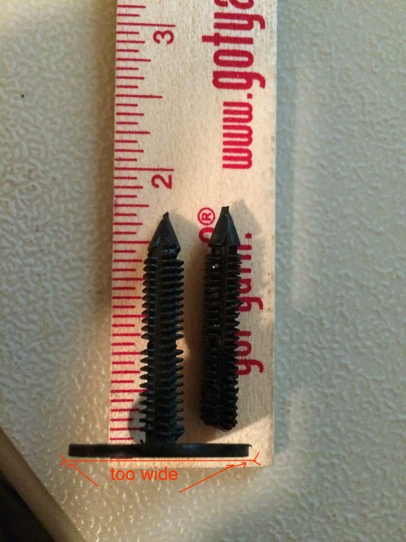

Here is broken one next to one I tried to match and buy locally. The
head is too wide to be able to push in all the way so the barbs have
something to grab onto. Thanks man, but yah, this new one has a 1in head..hmm
Yes, I have no batting either..

You need the black rounded head end and longer ones....
X-Mass Tree, Weatherstrip and Door Panel, Regular or Bulk Packaging
Actual metal ones..
TR 253 -Reg.Pak- 25pcs. / Wire Door Panel Ret. (OUTofSTOCK)
http://www.thefastenerwarehouse.com/...76/5445519.htm

ooo dude. thanks. yah maybe these!
Now I'm wondering who made my door panels.
http://www.thefastenerwarehouse.com/...976/236716.htm
I'll ask LMC if they have them.

WohhOOO!! Yep, this is them.
no, your auto parts store will NOT have these..
TR 197 - Reg.Pack / 25pcs. 5/16" Hole Size
now I have 50. muahahhahah. I can have no 2nd thought about taking off the panels to do stuff.
