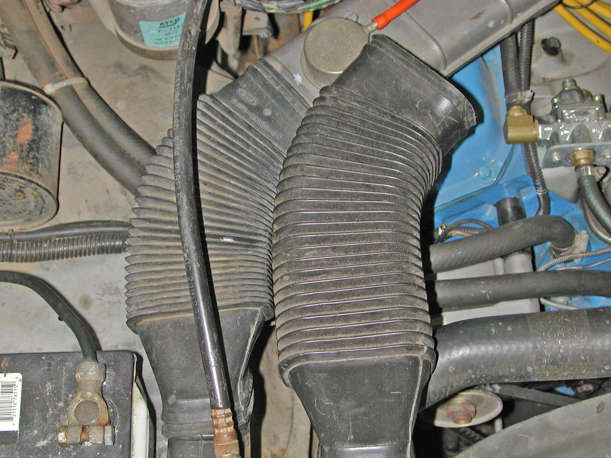

That is amazing. Amazing because I have a note somewhere that says "Explore cutting the adapter in half and flipping the outlet." That's because I would like some symmetry in the tubing, and having one going down and the other up isn't symmetrical.
If you cut and flip the adapter on the driver's side for symmetry, the little plastic accordion piece will not work on the driver's side because you can't bend it the other way.

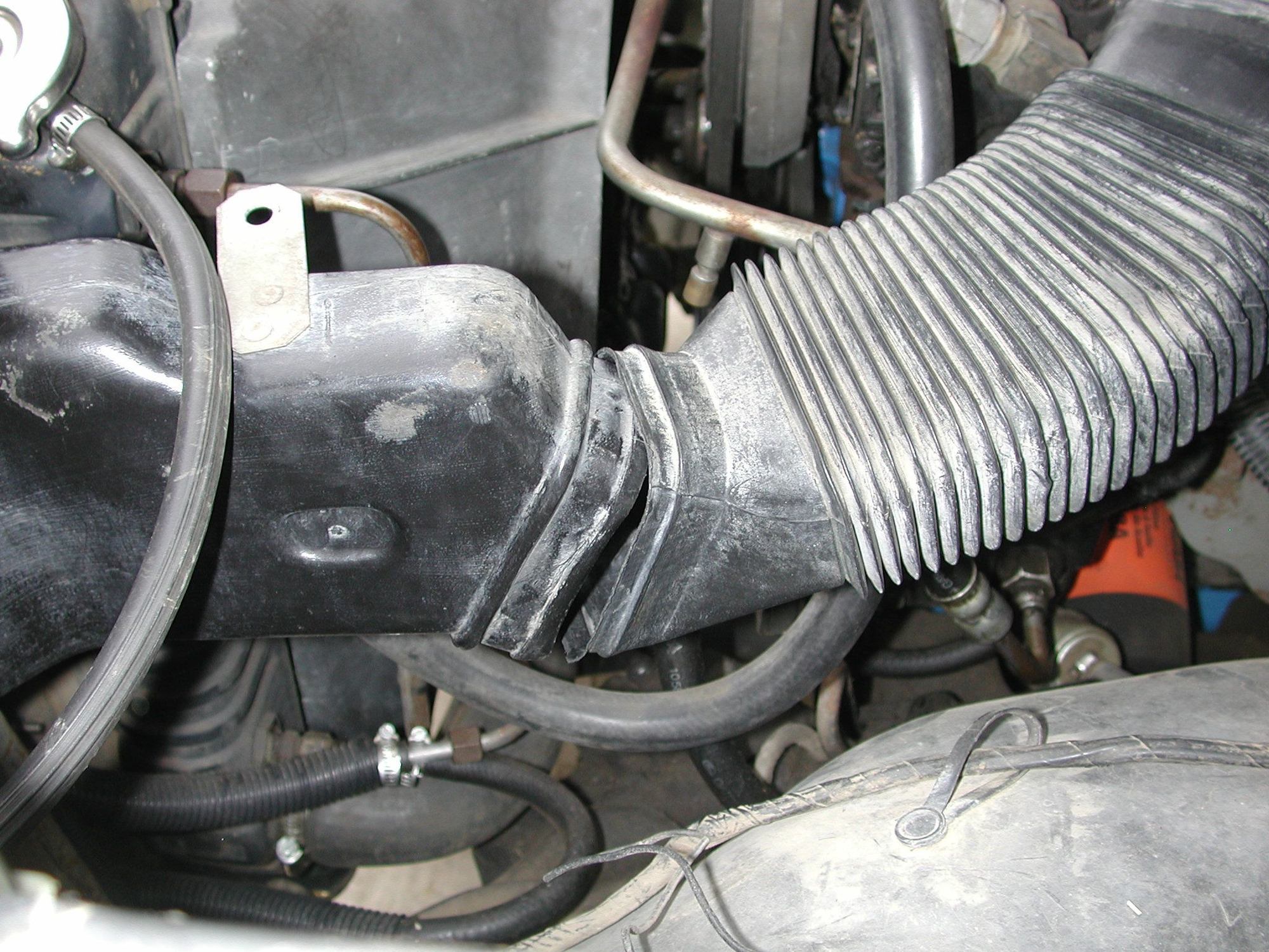

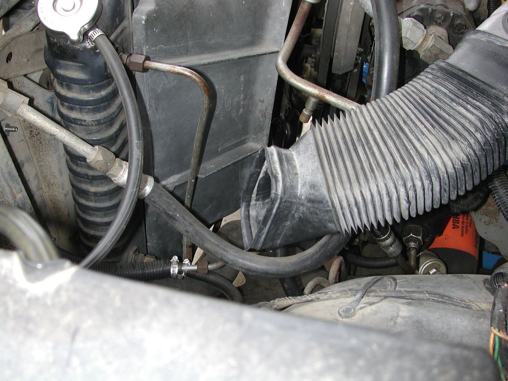

Well, the Fonz is right. On the driver's side the accordion piece has to go in flipped from the passenger's side orientation. And when you do its mouth opens up, and the only way to make the adapter match that is to use it as it is, but flipped from the passenger's side. IOW, flip both pieces and it works.
