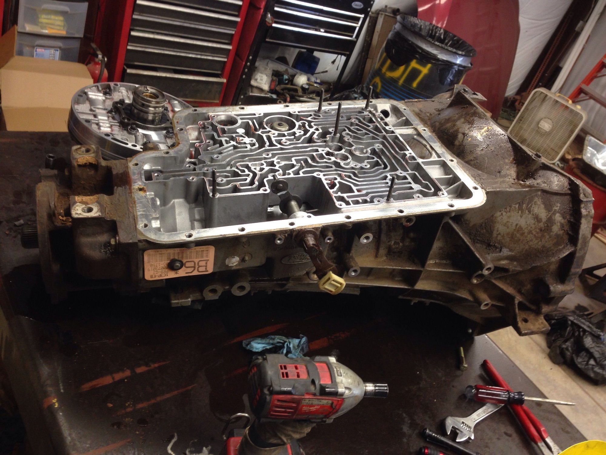

As for the Milwaukee Fuel - I've used a lot of cordless tools, but these are the real deal.

i love my milwaukee tools i use em daily 1/2 and 3/8 cordless about to get a set of fuels
