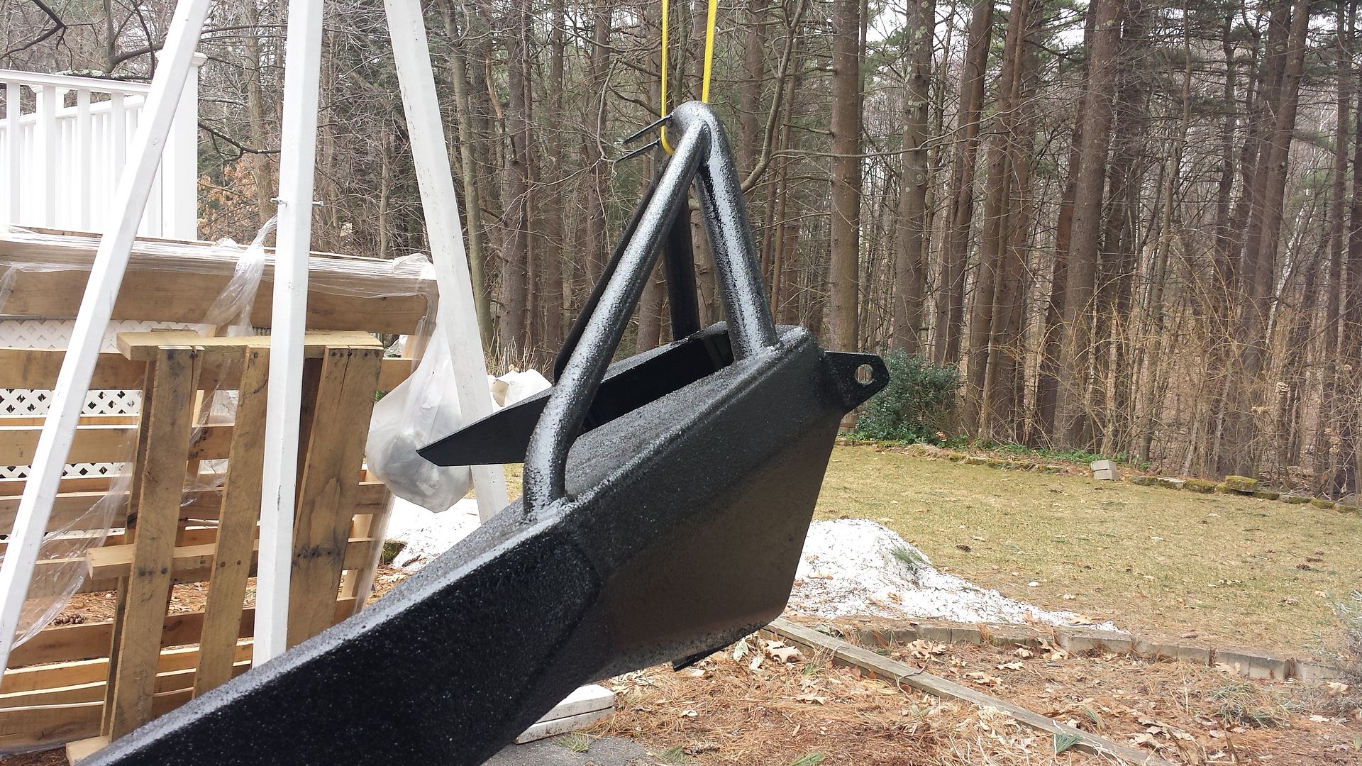

Guess what guys!!!! Guess what!!!
The bumper arrived today!!!!
I spent about 3 hours, prepping and painting ( More like bed lined and chassy saved)
I was very happy with the weld work and overall assembly, everything looks great. Unfortunately I could not mount it today. The bedliner takes a while to dry and its supposed to rain tonight. So I built a tarp fort over it for now. I will need to do some touch ups after I mount it. I sat the bumper down on some cinder blocks so I probably scraped some liner off. I wish I had a garage at my house.
On the pallet
[/URL]
If you wondering what the hell it is hanging from, I posted pictures before but I built this hanger thing to remove the top, it makes it easier and I can park under it for the night. And it came in handy for this.[/URL]
I put chassy saver on the inside, it's a really thin liquid so it runs quite a bit. I may bedline over it.
[/URL]
Here's the outside herculined
[/URL]
Side shot
[/URL]
[/URL]
Beast
[/URL]

Totally worth it. Helps when you're by yourself
I managed to get the bumper on today it was tough because this thing was a perfect fit, fit like a friggen glove over the frame rails. I absolutely love it was totally worth it. I measured from edge of fender to the pavement it was about 38 1/4" with the old bumper. The new one it was at 38". If it drops anymore I can get small 1/2 inch coil spring spacer from JBG that I will add.
I used my hanger thing and while I was removing the old bumper, my 60" Hi-Lift jack arrived which came in handy.
Here's the pics.
The help of the hi - lift jack. I used it to get each corner that kind of wraps around the truck flush and tight up to the fender.
[/URL]
[/URL]
[/URL]
[/URL]
[/URL]
[/URL]
[/URL]
Andy finally, this one is my favorite.
[/URL]
