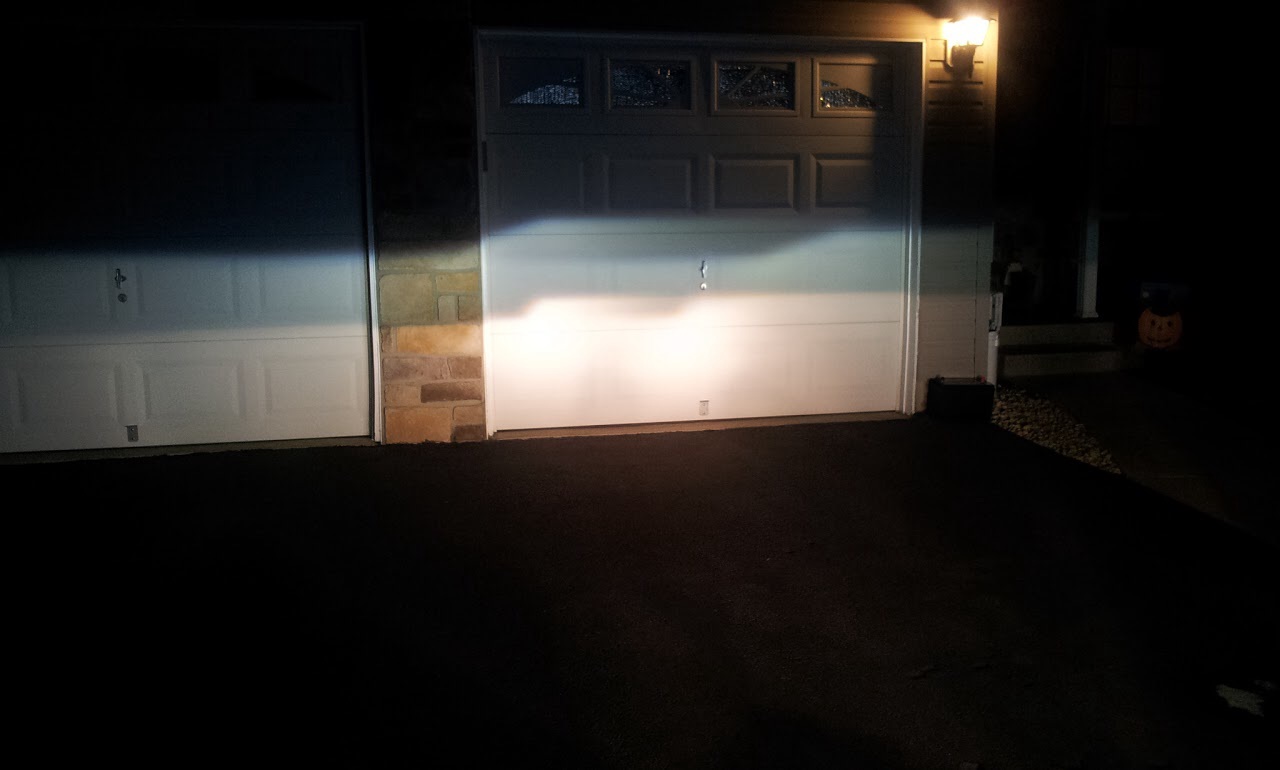

I made a set of headlights from some range rover projectors. The biggest difference of putting retrofit hid's into a halogen reflector housing is the beam cutoff. The reason hid retrofit headlights usually blind oncoming traffic is because there is much more light output with the hid and the halogen reflectors lack of ability to control where the light needs to go.
High beams and custom projector fogs
Old Dec 30, 2013 | 07:35 PM
RACERX7775's Avatar
RACERX7775
Posts: 3,620
From: WARRINGTON, PA
This is low beams and projector fogs
Old Dec 30, 2013 | 07:37 PM
RACERX7775's Avatar
RACERX7775
Posts: 3,620
Just projector fogs.
ALL PICS ARE BEFORE I HAD A CHANCE TO ADJUST BEAM PATTERN EXACTLY. AND ALL PICS TAKEN ABOUT 20' FROM THE GARAGE.

I changed my projector h13 bulbs out for a set of 55w hid h13 bulbs. Still has the cutoff because of the projector but so much mor effective
