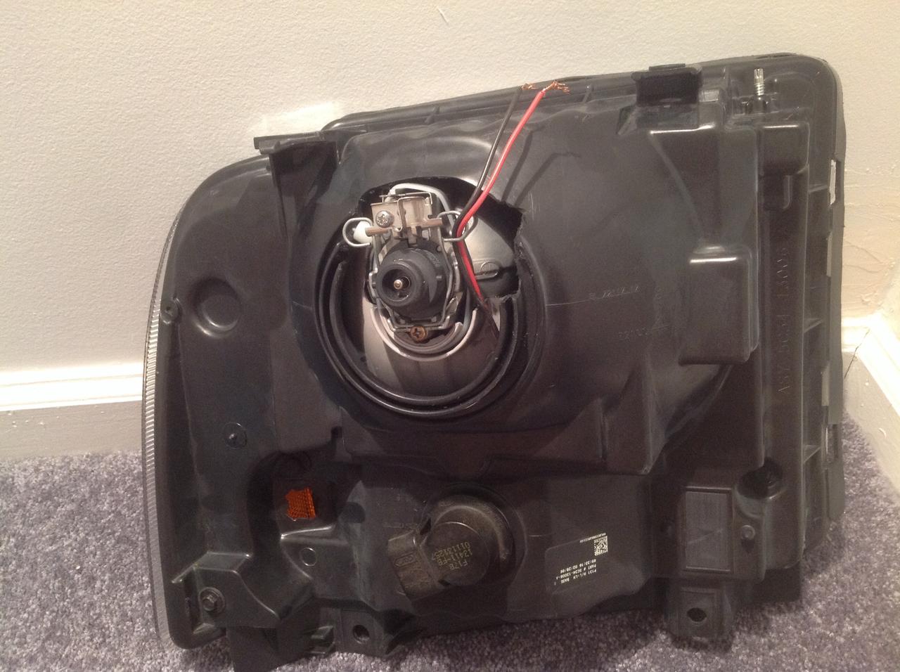

To make this. THESE ARE MY NEWEST WITH THE ACURA TL PROJECTORS
I can't figure out how to get multiple pics in one post from my ipad. Sorry.

The back that MUST be COMPLETELY sealed.
Attachment 87824
where can someone find a set of those projectors? I want to retrofit a set in the X
