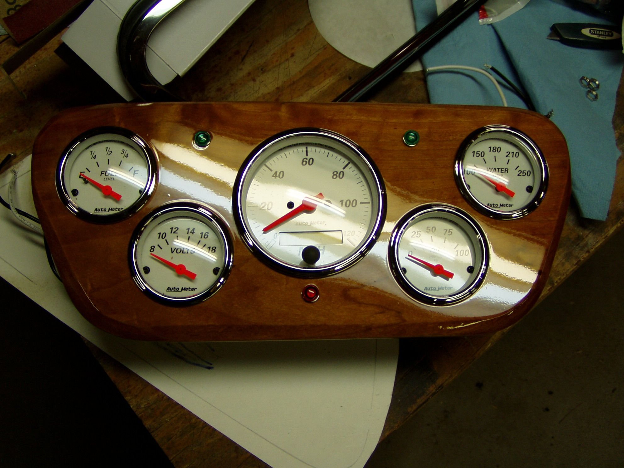

The cloth was just some cheap fleece that was stretched over the wood form and stapled. I hardened the fleece with fiberglass resin and later some 1oz fiberglass mat and resin to give it a little more strength. Not knowing whether I was going to paint the console or cover it with material I went ahead and gave it a wipe with body filler , sanded and primed. The wood inserts are cherry which matched my instrument insert. The small dark piece of wood on the back side of the shifter was walnut and was used to cover up a raised section on the chrysler shifter. I'm probably going to use some more cherry wood in my door panels to break up the upholstery.
