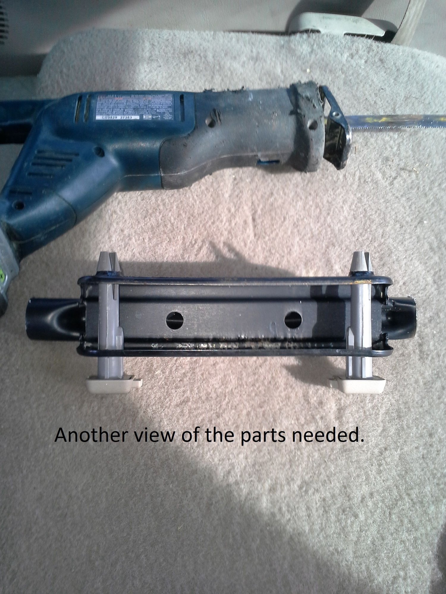

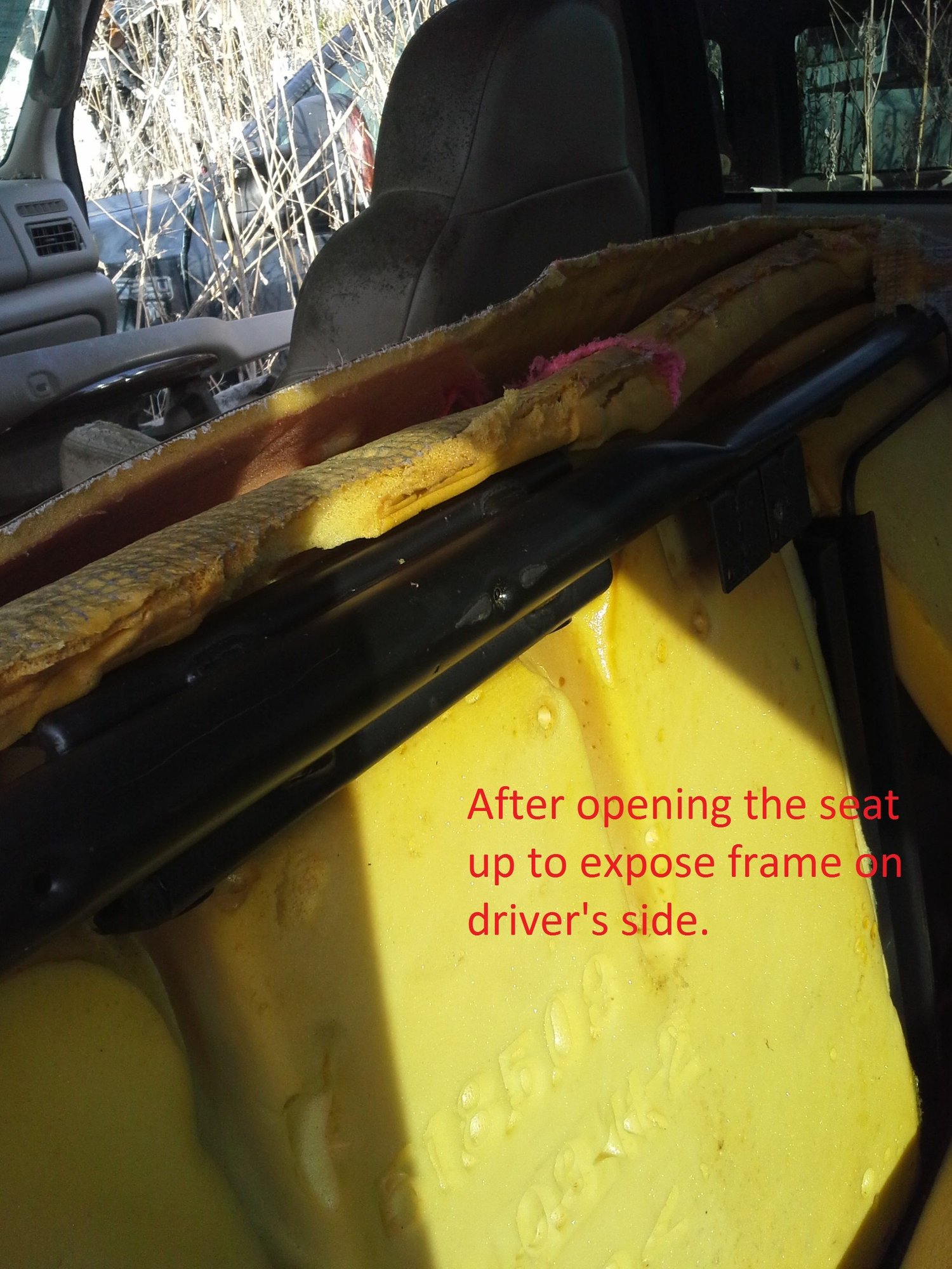

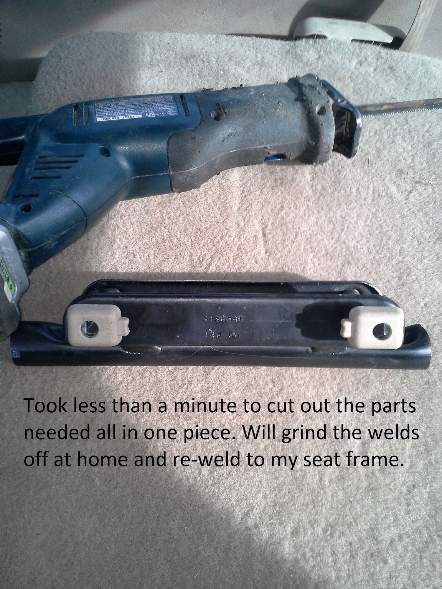

I went to the Gold Mine today to source the parts for my third row headrest install. Great ideas in this thread, and my hat is off to the OP for how he did it.
The pictures will tell the story of how I got the parts out of an 00 Excursion second row seat. I paid for the seat ($50 with lots of weather damage), and I cut it up and left the parts I didn't want behind (99% of it). You could also get the same parts from the second row of an Expy.
Then I moved to the passenger side:
I will install mine in the coming week or two and post some pics of how simple (or hard) this is using these parts. I am expecting very simple. I paid $50 for all the parts, so it is very cheap and my headrests will match my stock interior EXACTLY

When I did my install, I had a full 2nd set of 2nd and 3rd row seats to work with. I had the option to do exactly what you did, cut out the entire bracket, instead of drilling new holes like I did. I didn't do it for this reason:
if you just cut those brackets off of the old seat frame (grind down the welds) and weld it to the 3rd row frame, the headrest retainers seemed like they would be mounted too far forward in the seat.... meaning there would be very little cushion between the steel and the back of someone sitting there.
You could take those pieces, weld them to the 3rd row frame so that the retainers are centred on the frame, then cut away the frame enough to allow the plastic retainers to go "through" the frame.
Either method can work..... when you know how to cut, grind and weld!! I love it! Good luck

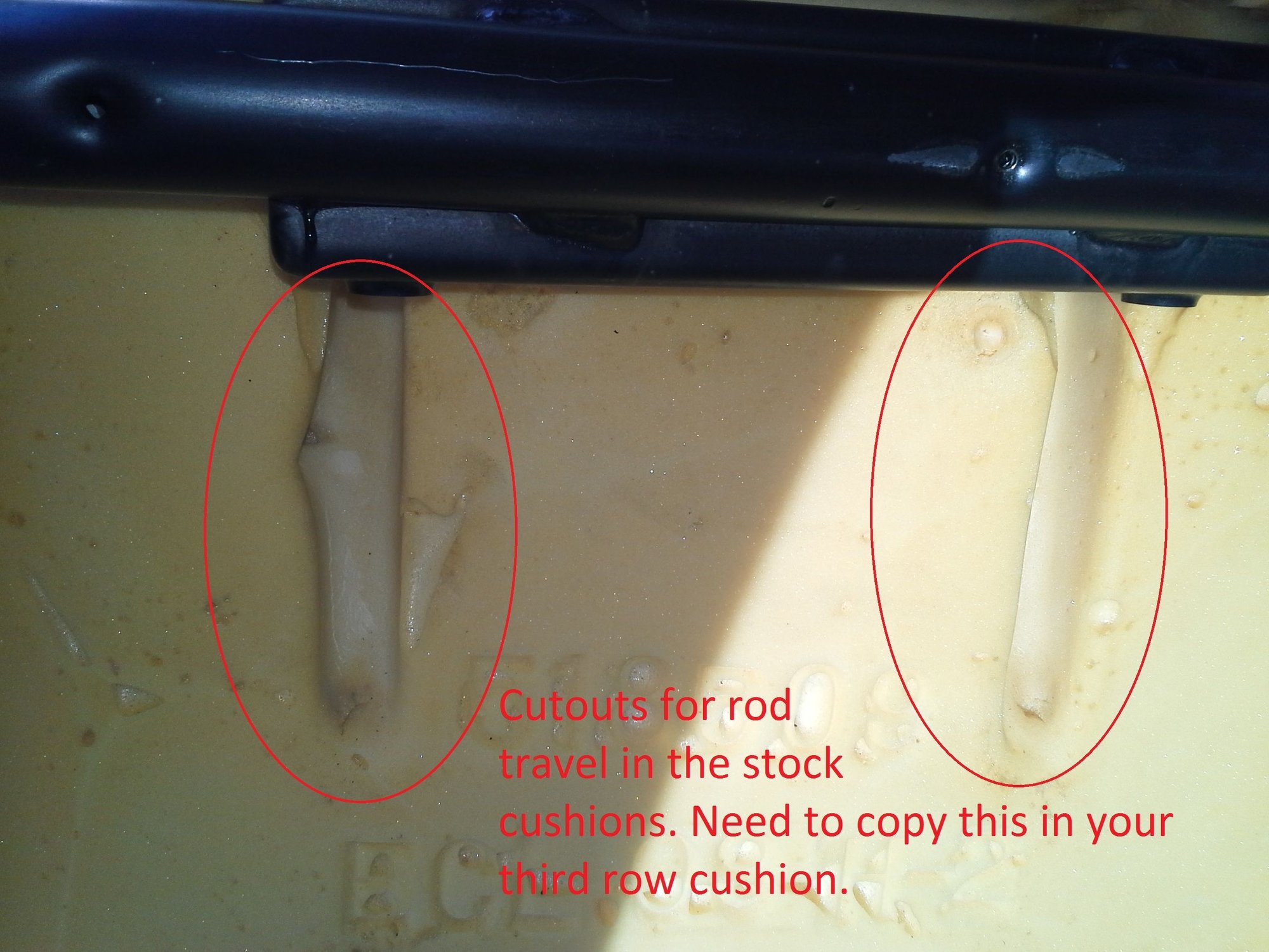

First of all, I liked your write up and pictures so much that it made me want to do this. Again, my hat is off to you, sir. I am not trying to re-invent the wheel, as your method is clearly very sturdy and successful. I just had the opportunity to get these parts super cheap at the Gold Mine (my honey hole for parts here in CenTex), and I am going to try to make it as simple as I can with these parts without buying anything else (if I can!). I think I can do it with a little less drilling/welding than you had to do
I totally hear you on the concerns with the thickness of the seat cushions in the third row, and I have already been considering that. I may very well need to flatten the frame out a bit (like the frame on the second row I got them from was - check pics again) to make the brackets sit correctly in the cushion. The positive side of getting the brackets is, I can angle them if I need to so I can achieve the correct headrest placement in relation to the top of the seat cushion.
Looking forward to giving this a try, and I will post pics to add to this great thread you started.

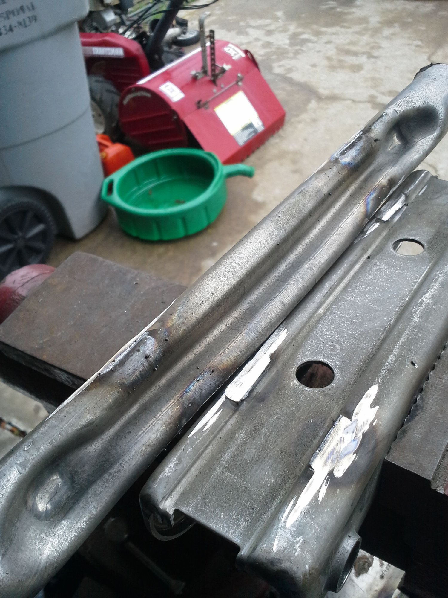

A little ahead of schedule on this (this never happens to me). Got the brackets removed from the pipe I cut out of the seats I borrowed them from. This is looking very promising if I can figure out how to flatten the bar on the third row seat I am going to put them on.
Since the thickness of the 3rd row cushion is an obvious concern, you can now see how the bar this WAS mounted to was made more narrow to accommodate the cushion it used to be mounted in. I might attempt to emulate this flattening effect, or I might not. Need to take some measurements of the seat thickness on both 2nd and 3rd rows.
