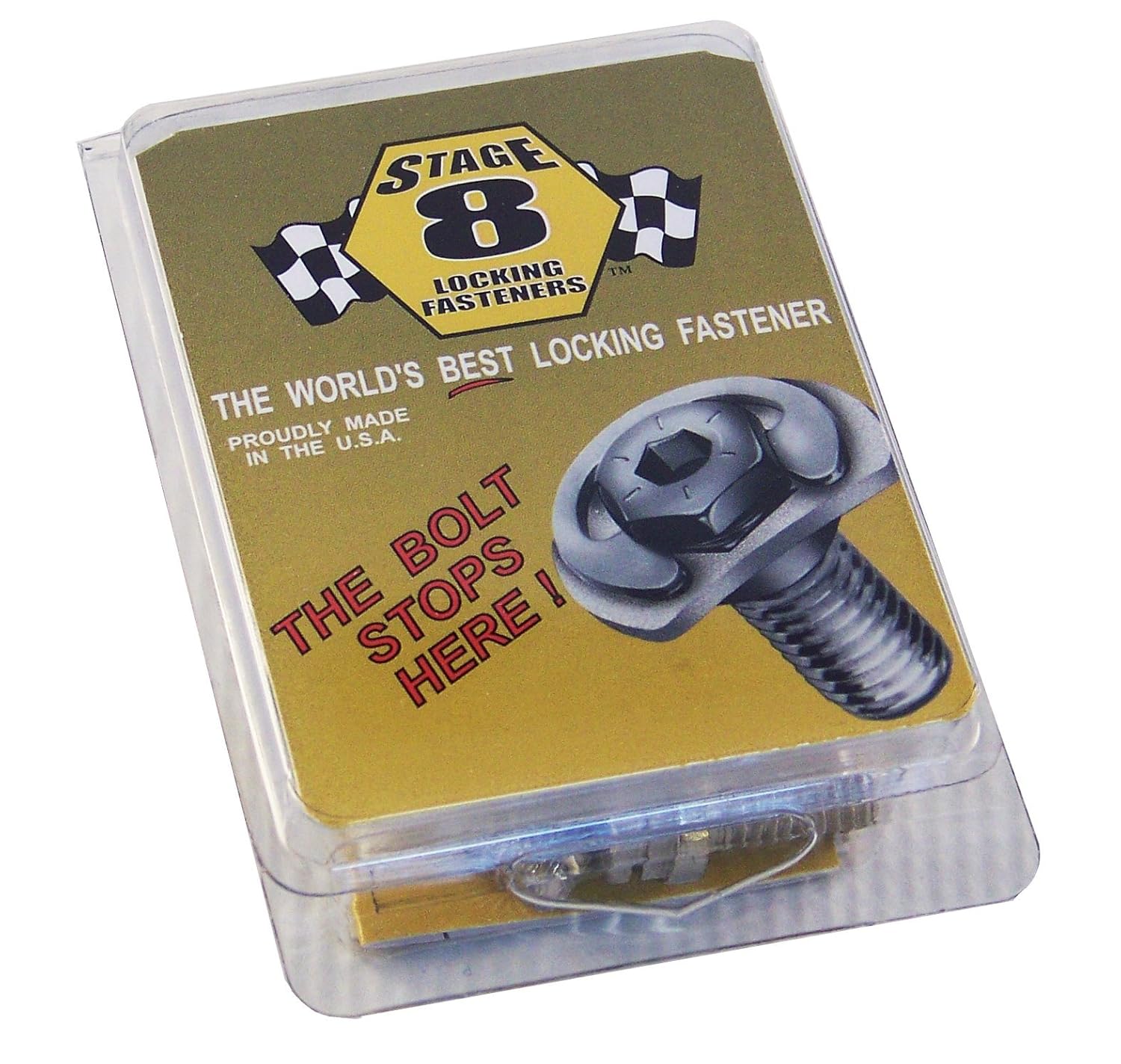

I know people who had this problem and the problem was his Turbo Bolts were loose, loose enough to make the leak. One of the bolts was almost out all the way.
You may want to check all the bolts on the turbo and pedestal.
If you find the bolts are loose, the Stage 8 are good to many guys who race. And some people drill the Ford Kit Bolts and use Stainless Safety Wire.
Ford Turbo Bolt Kit, Part #C3Z-9G486-AA
or the better locking Stage 8 type,
Stage 8 (3900) 8mm Turbo Locking Fastener Bolt for Ford Diesel : Amazon.com : Automotive Stage 8 (3900) 8mm Turbo Locking Fastener Bolt for Ford Diesel : Amazon.com : Automotive
