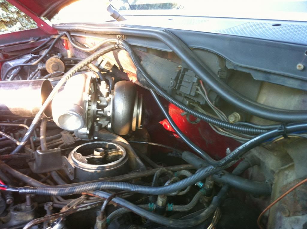

sorry racer is more correct, a longer rod with a different crank makes a stroker. theres many ways, the point is the piston travels further. sorry again that was a quick post was in the middle of mocking up the turbo when i saw it.
everything looks like itll fit well except the intake hat is a little tall, i may have to cut and weld in a section to make it fit with the larger comp wheel

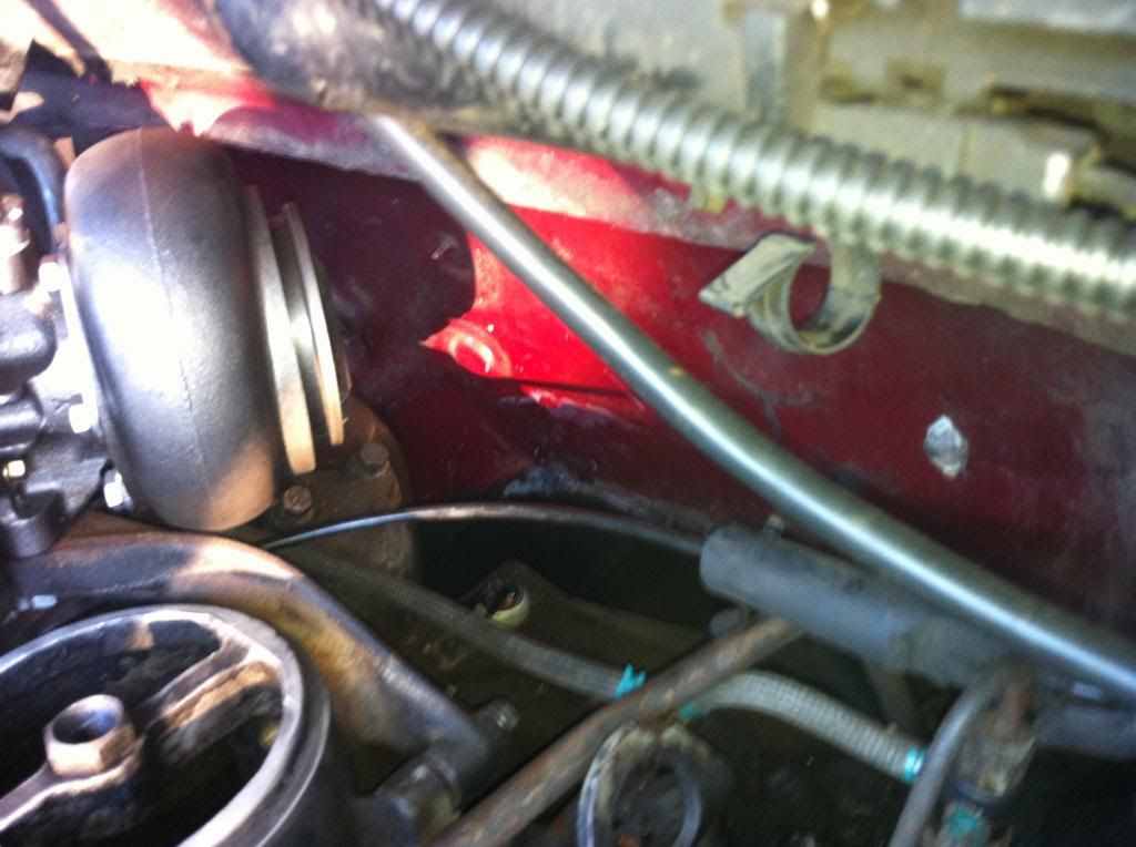

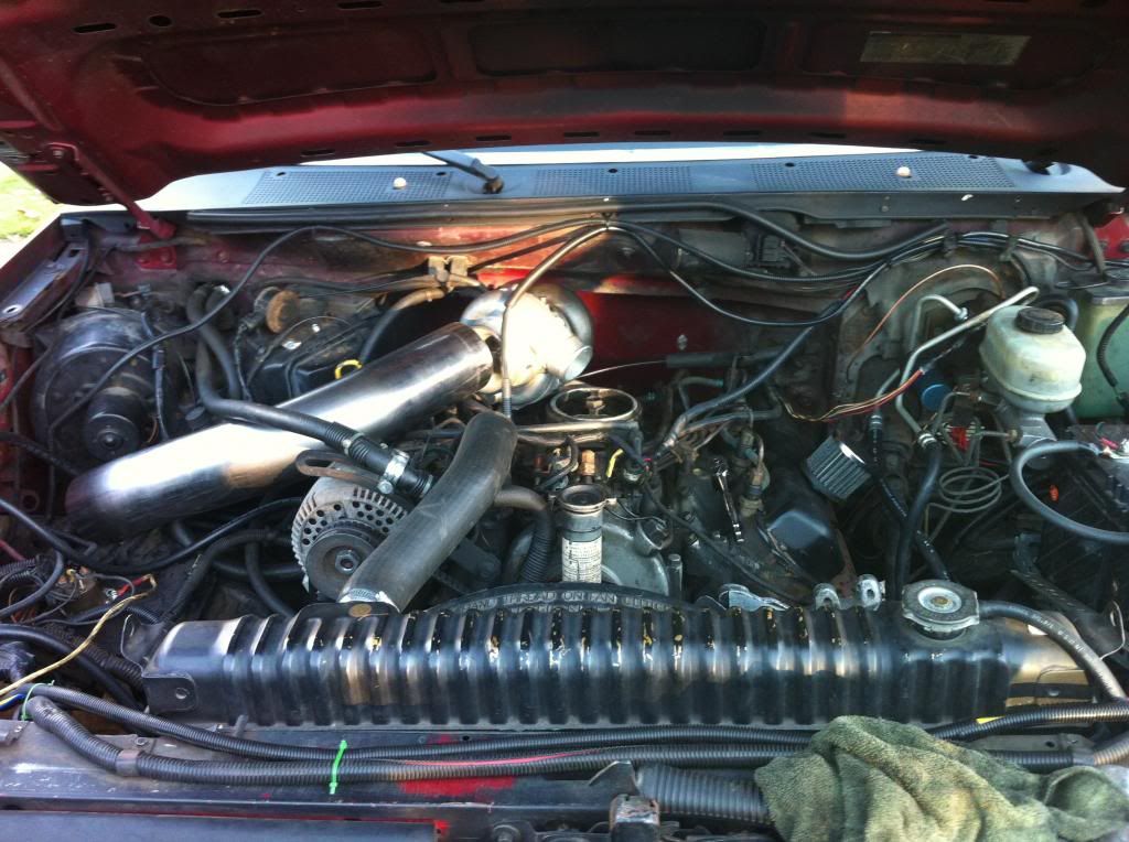

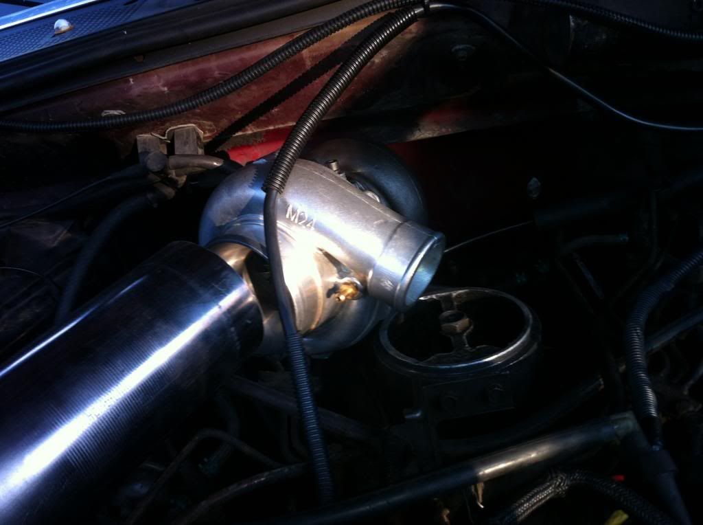

well got the mock up pics loaded to photo bucket
the turbo hat interferes a bit with the turbo and fuel lines. does anyone know where i can get something made to space the turbo up just a bit?
the 4 inch ss pipe is part of a psd down pipe ( too big for the idi) and will become the air intake box.
im making a shopping list on summit right now for the few small things i still need. dp is going to be ordered friday.

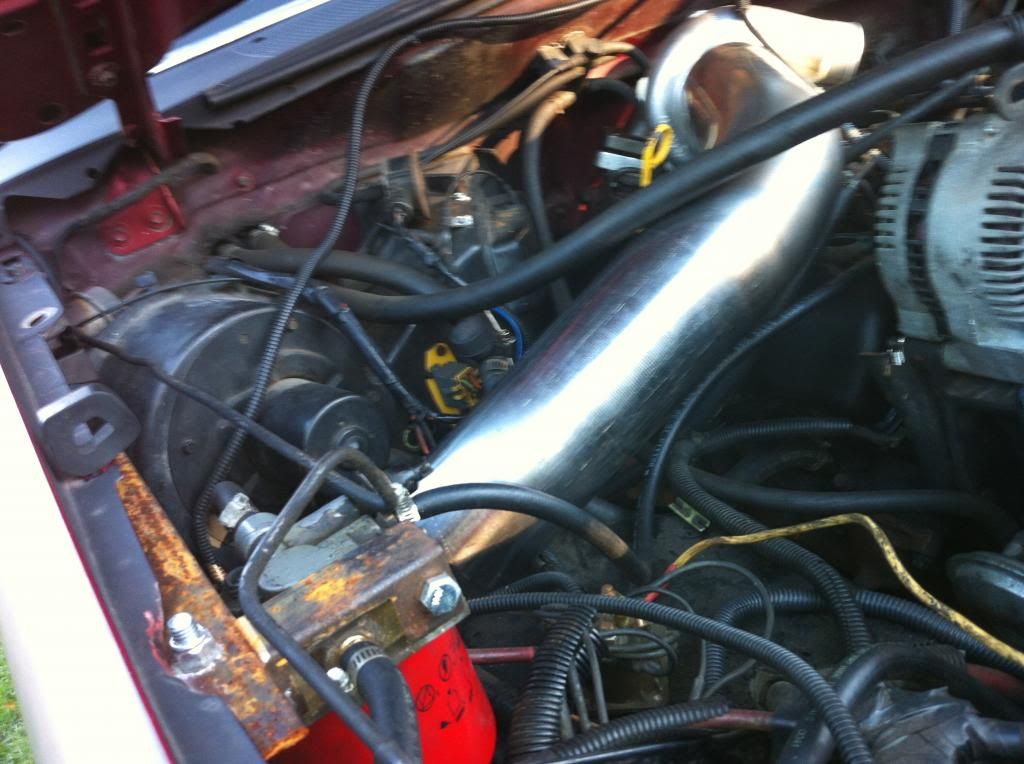

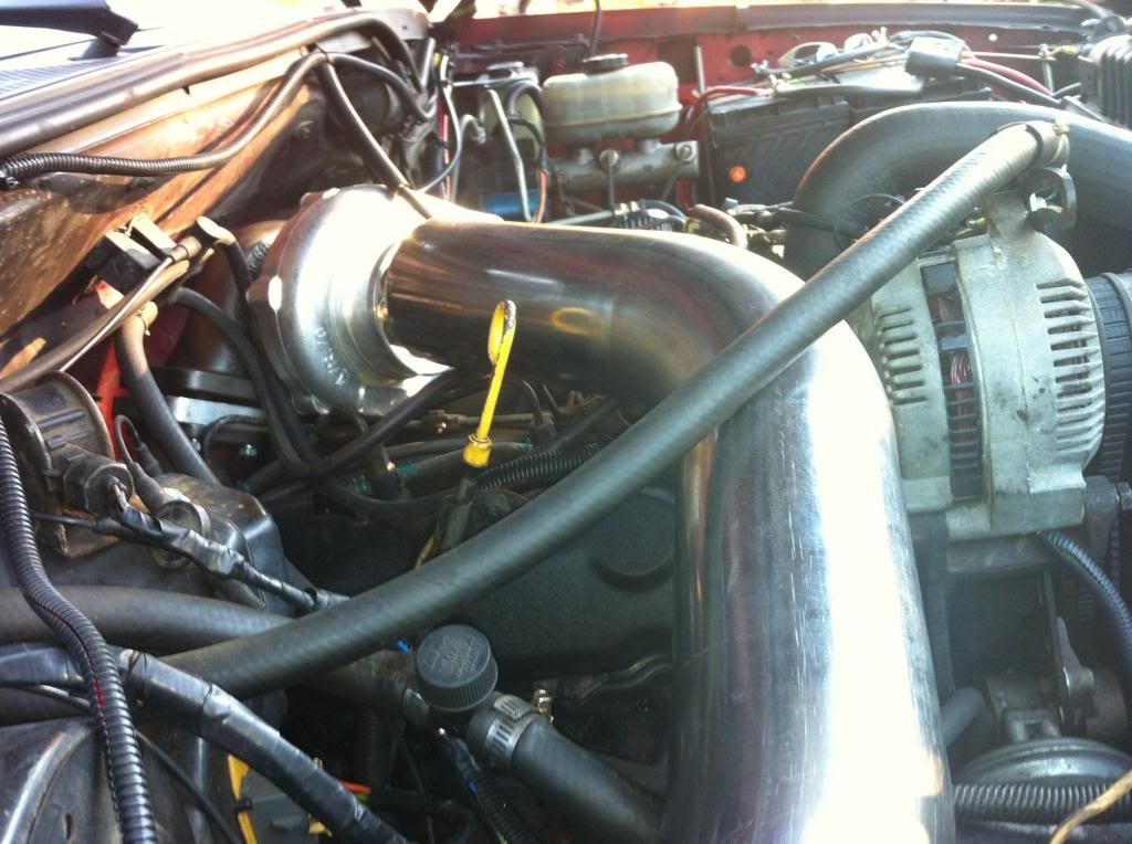

started installing today. got the crossover pipe and the up pipe installed with some stuff moved around. the turbo will sit nicely after a few hours of hunching over in the engine bay theres got to be a better way to do this. anyway more pics sat or sun when everything is done.
