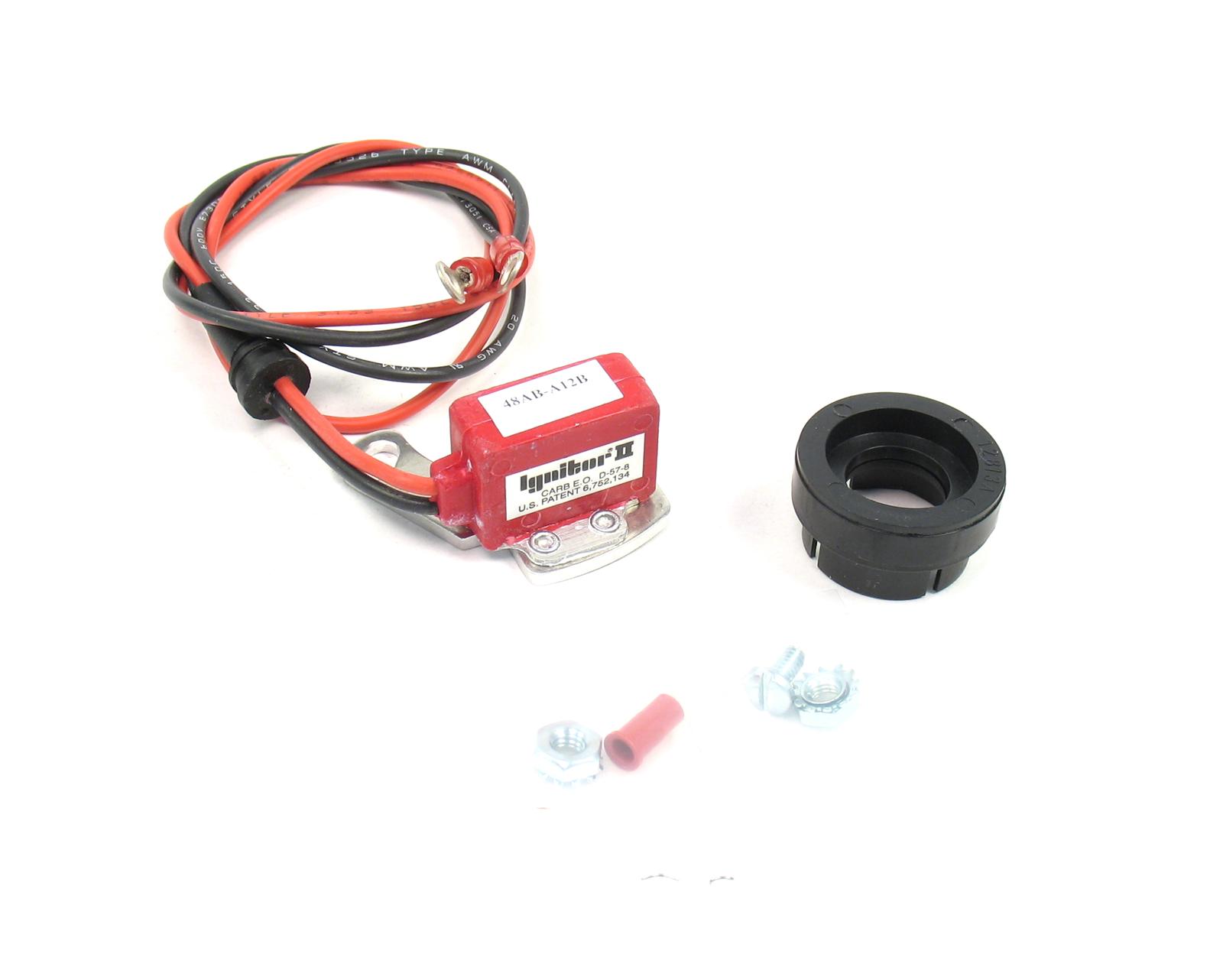

Originally Posted by 68fish
Are you using the stock ford coil or did you use a new coil? The stock coils don't work on 12 volts. They use an external resister circuit. Just throwing it out there.

Don't use that coil with stock points and no ballast resistor. And even then, 0.6 ohms is really low and you'll need a bigger resistor than stock. Only use it with the Pertronix Ignitor II and not even with the Pertronix Ignitor I without talking to tech support. You need a coil with about 3.0 ohms internal resistance to run points with no ballast resistor.
Sounds to me like you'd be better off returning everything to the place you got it and going straight through Pertronix. It doesn't sound like the people you're dealing with know what they're doing.

Sure does. I mean how hard can it be to order a Pertronix II for a Ford V8? It is only one part # that works same with the Pertronix I having just one part number. Anything else is not a kit for a Ford V8 with stock Autolite distributor. With the II you can use that Flamethrower II coil and with a I you can use the stock Ford coil.

Yes he sent me the one in the first link. I have discussed needing the full 91281 kit but he insists all I am missing is the ring which I now have. I'm trying to get a refund seeing as this is all due to their negligence in ordering things properly and holding out on really fixing their mistake. Its not an eBay deal but a deal with a vendor near me.

Don't mean to steal thread but have a question about why you have to have a different coil. I bought the Accel kit and never could get it to fire constantly. Ended up putting the points back on cause I had other things to work on. I grounded the thing straight to the intake manifold with a clean threaded bolt.....I have been looking at the GM style HEI dist. ebay since this didn't work.....

Had the same problem on my 65 F250 with Pertronics Ignitor 3. It won't fire, had to bypass the resistor wire from the ignition switch to get a constant 12v when the engine started, cause if you don't have full 12v when engine is running it won't !! Cause when the engine is running the voltage drops to the coil.

You don't have to use a different coil with electronic ignition. You can use the stock coil. If you use an aftermarket coil with too low of a resistance, it can burn up the points or electronic ignition you are using. The coil has to be designed for what you are using and have the correct resistance.
Your intermittent firing *could* be related to the bypass resistor dropping voltage when running and your ignition module needing 12v at all times, like the post above mentioned.

Pertronix I fine with stock coil and resistor wire. Run 2 of them
Pertronix II work ok with stock coil and resistor wire. I know as I have done it before taking out the resistor wire and putting in a Flamethrower II coil. Maybe overkill for an engine like a 360. Run 3 of them
Pertronix III mandatory with their coil and 12V. For a street car this is pretty much overkill. This Ignitor is at it's best at higher rpm's and even my modified Cougar rarely sees higher than 5000 rpm. Run 0 of them

All I did when I installed the original pertronix 1 on my 2 mustangs (2 and 3 are crap in my opinion) was take out the points and condensor and install the pertronix unit and then run the positive and negative wires to the stock coil. You don't have to change your stock coil. Ive been running my 2 mustangs this way for over 8 years now and I have had zero problems. You don't have to worry about a resistor wire and all that nonsense.

Originally Posted by 68f10059
I believe it may have something to do with the fact I did not receive the magnetic sleeve that is meant to go around the distributor shaft....
Yes, that is the problem......you need the sleeve......but I would still go for the original pertronix over 2 and 3.
