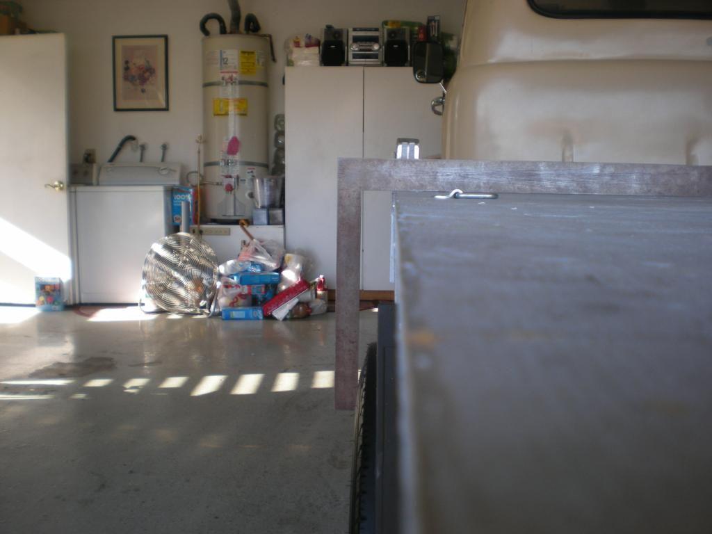

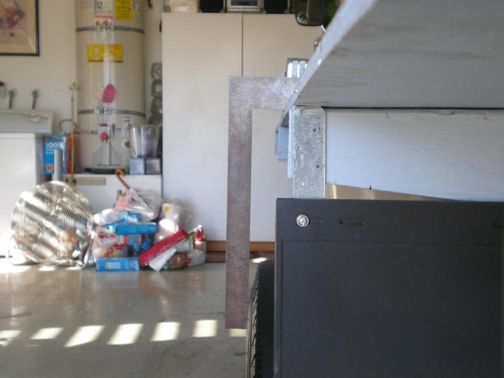

OK, so here's what I did. "Measure twice, cut once", as the saying goes. But make sure your measurement is to the right spec first...
When I built my existing bed, I looked at the drawing above and saw the 82.06" width dimension but not the 87.3" dimension. I made the bed 80.25" wide at this stage of completion. Since I planned on completing this bed out of wood, I figured the 3/4" outside rails would make up the difference making the bed 82" wide. Yep, that's what I figured.
And, by the way, that drawing shows the tires sticking out beyond the width of the bed.
So, just now, after all you guys are telling me the 9' script bed is 87" wide, I measured my truck's width, rear wheel to rear wheel outsides. It is exactly 85" wide with the 225/70R19.5 tires I have. So, that would give 1" overhang on each side with an 87" wide bed.
And, most importantly, it means I would have to lengthen not just the side rails by 16" but also the end rails by 8". I guess I could just cut right down the middle of that script!
No, so that means the rear would have to be widened 4" in two places , missing the script.
I just talked myself out of using this smaller bed and finishing my bed out of wood.
