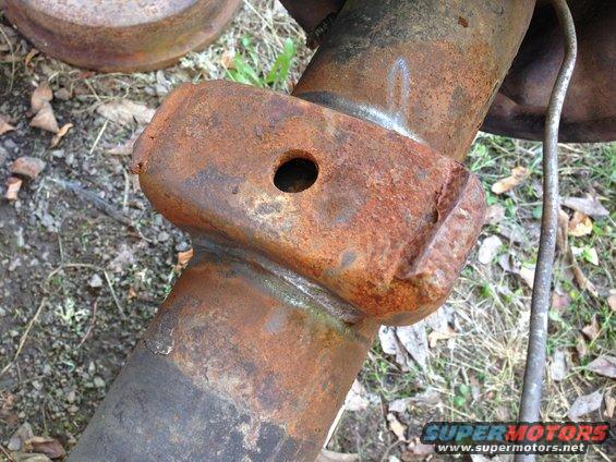

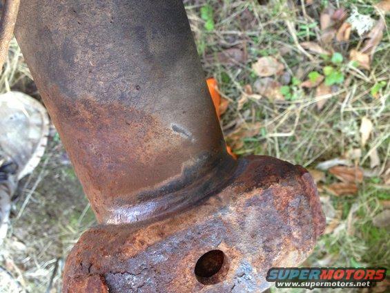

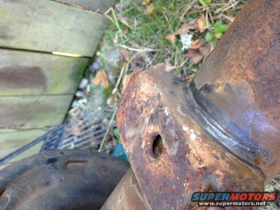

Well I picked up a front third member with the gears I want, and a Ford 8.8" that needs gears and an overhaul. I am a little concerned with some of the rust around the spring perches. There is some decent corrosion, and on the undersides of the perches, big flakes of rust that I can pick off. I am unsure what the best thing to do would be. Sandblast and paint? Remove the perches and possibly replace before rebuilding? I want to do this the right way the first time.
Here is the rust:
I don't know what that extra welded bit is either, but I will grind that off.
I did wire wheel the welds to see if they were cracked under the corrosion and they looked to be good still.
I am all ears on this as I have not done something like this before. Thanks again guys.

Looks like surface rust to me. Wire wheel them good and use some rust conversion and repaint.

Looks just like mine. Wire wheel and some good rust preventing paint. Mine was chipping away too but I hit it with a chipping hammer a few good times and all that's gone and it looks pretty good now. Tonight I'm going to get it up on a table and write wheel it from drum to drum and get it full of fresh fluid and seal it up so I can get paint on it. I'll be posting pics in the what have you done today thread.

What ^ he said. Wire wheel/cup brush until you're rust colored head to toe (that way, you know the axle is clean), wipe down axle with lacquer thinner, good coat of rust converter (on the axle) and topcoat with some decent enamel. Tada!
Those booty-fab booger welds look like the Previous Owner tried to blob-weld his spring perches to the springs. In the IHC circles, that is what we call classic PO Virus.

Having lived in the rust belt my whole life and seeing big metal pieces like this rust right through I have to say that is nothing to be concerned about, clean it up, paint and/or rustproof to your satisfaction and forget about it.

The welds are someone welding lift blocks to the pad to keep them from kicking out.
Like others has said, wire wheel and paint. I personally would sandblast, but I have one.
