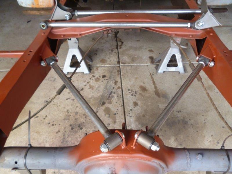

well finially made a start on the old girl will be installing rear end first, 4 bar triangulated set up with coil overs and setting up for a nine inch bit of work to do to the tray but overall not to much rust in her

paint on and seting up the 9 inch
