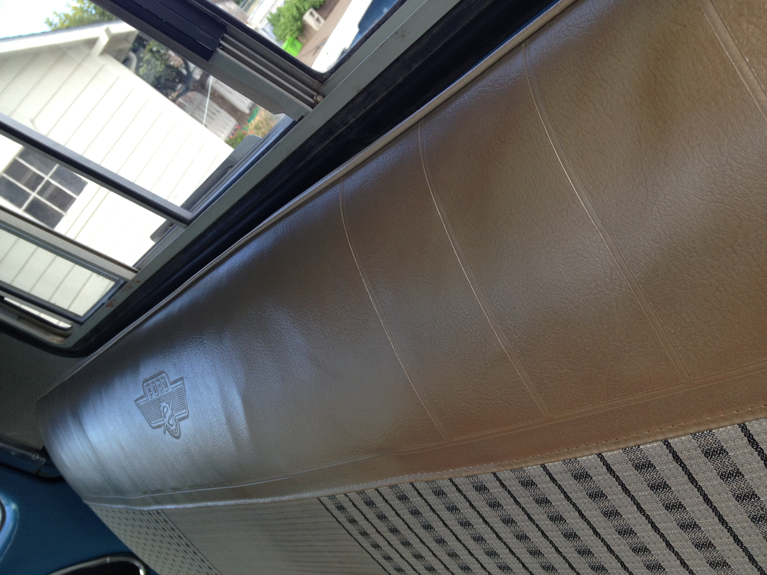

This is a picture of the upholstery in the old blue truck, rumor is that this is original. Can anyone confirm this is "D81: D = Medium Beige Crush Vinyl & Medium Beige Cody Pattern Woven Plastic" ... Is this the original ?

Yep
Looks like it to me. Is the whole thing in good shape? The vertical back usually survives better than the horizontal flat that is sat upon.
