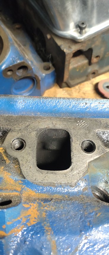

Originally Posted by wwhite
Port the E7 exhaust port, remove the thermactor air bumps, helps it breathe.
Are these what you are referring to?
do the ports need to be plugged?
Yes, back and front of head should have a plug, they are ready available from various sources, like LMR, 1979-95 Mustang Cylinder Head Smog Threaded Inserts 5.0/5.8.
Air bump in exhaust port remove.
It's funny these heads had busted spark plugs in the back, I think I'm going to have to find a different solution.
