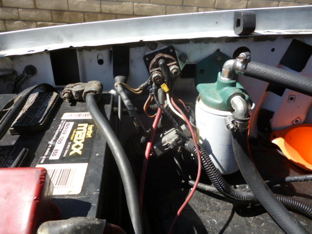

Mine has been here forever. Works well and keeps the hoses out of the way.
Name:  More coolant filter 002.JPG
Just make sure you leave room for the hood hinge.

Did you just drill a hole and bolt it on with a self threading bolt?

For mine I think I used just two #14 self tappers and she is still holding strong.
