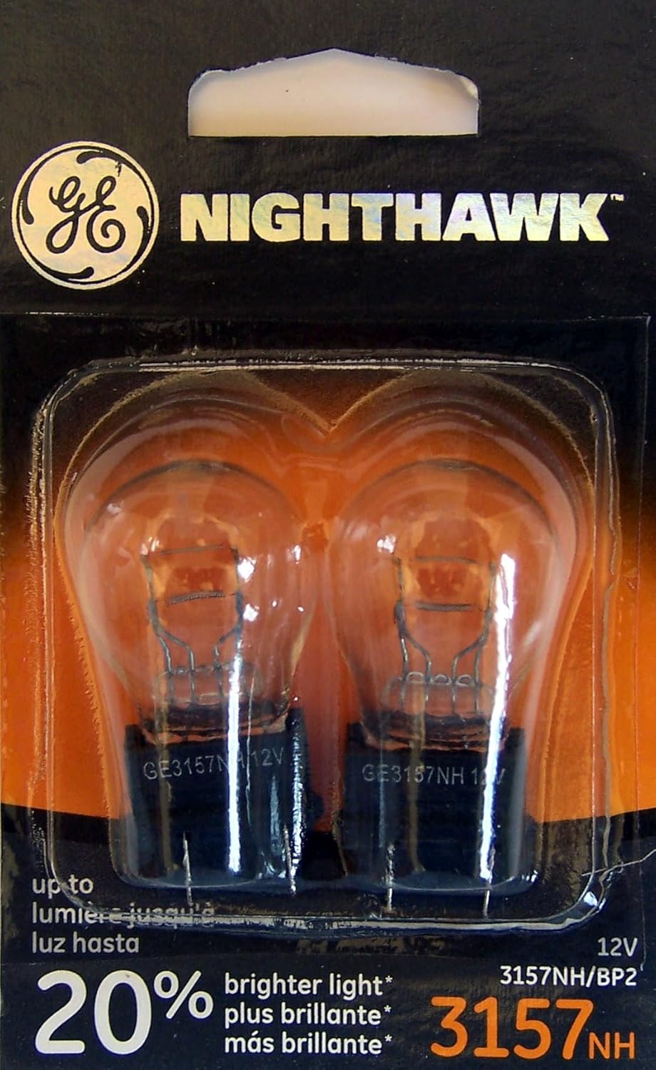

A simple upgrade is GE Nighthawk bulbs. They are available on Amazon in 1157 and 3157. At first glance you may not notice a difference. They aren't much brighter on tail light, but are noticably brighter on brake. I do think you will notice a difference at night when looking in the mirror. A few of my friends commented about that after we swapped the bulbs.
Another thing would be clean shiny lenses. Without that, the lights will always be dim.
Like was already stated, definitely don't use over wattage bulbs.
This is why LED replacement bulbs usually don't work very well in housings designed for incandescent bulbs. It may be brighter at the hot spot in the center, but won't evenly illuminate the housing.

...And a 50%-70% SHORTER life expectancy. GE and other makers of such lamps won't tell you that part. Yes, they are brighter, but since they do not draw any more wattage than the original lamps, the filament is significantly thinner and fails much more readily than the original lamps. Its the physics of the matter. Brighter light from the same wattage sacrifices lamp life exponentially due to the smaller filament. So, yes, you get the increased intensity and you replace them at least twice as often if not more. There is that trade-off to consider.

I was told by GE that the filament was more robust not thinner. We've been using these bulbs in the tail lights of about 10 vehicles for more than a few years with no failures.
It may be true that they do not last quite as long as regular bulbs, but are pretty inexpensive. I've also seen quiet a few premature LED failures.
I use Sylvania long life bulbs for everything else.

That is a blatant lie on GE's part. Its the physics of incandescent lamps we are dealing with here. You cannot get more light from the same wattage lamp without decreasing the resistance through the filament. The only way to achieve that is to thin it out or shorten it. Either practice shortens the lamp life. Hell, GE produces a dial chart for its lamp dealers that actually shows exactly how much lamp life you gain or lose by changing socket voltage, wattage and filament structure.
