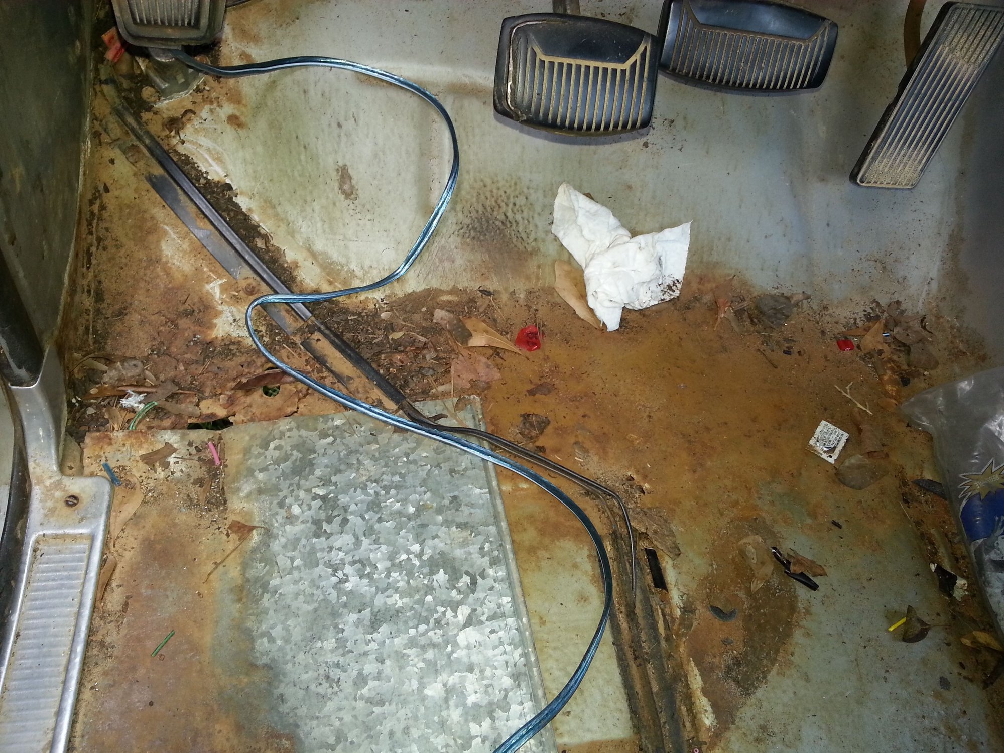

Hey All,
I put new floor pans in my '78 F150 during restoration and failed to measure where the dimmer switch was located at before I tore out the old floor. Would someone be able to give me an estimated measurement down from the firewall seam to the center of the switch (button) and then also distance from the kickplate or cowl to the center of the switch. I want to mount it back on the floor but want to get it close to the original position. Thanks in advance!
Jon

On my 78 F250 4x4 the measurement from the seam down is 8 1/4 inch to 10 inches thats from top bolt to bottom bolt .mines mounted at a angle from the side kick panel 1 1/2 inch to2 3/4 inch .I was out in the garage just measured mine.

Does anyone have measurements that are a little more accurate ? same thing happened here, they replaced floors but didnt mark switch location. i think some new carpet replacements have the hole already
cut (maybe - not sure) but if it is , i need to get the location pretty close.
Thanks

This is the best I can do. Hopefully they get you in the ballpark.
We were able to keep the factory holes for the switch when we replaced our pans. The parking brake is applied in all pictures.
In the last picture, that is the seat belt warning wiring running behind the dimmer switch to the connector.

How about this good enough?

looks like that will get it pretty close.
thanks guys.
