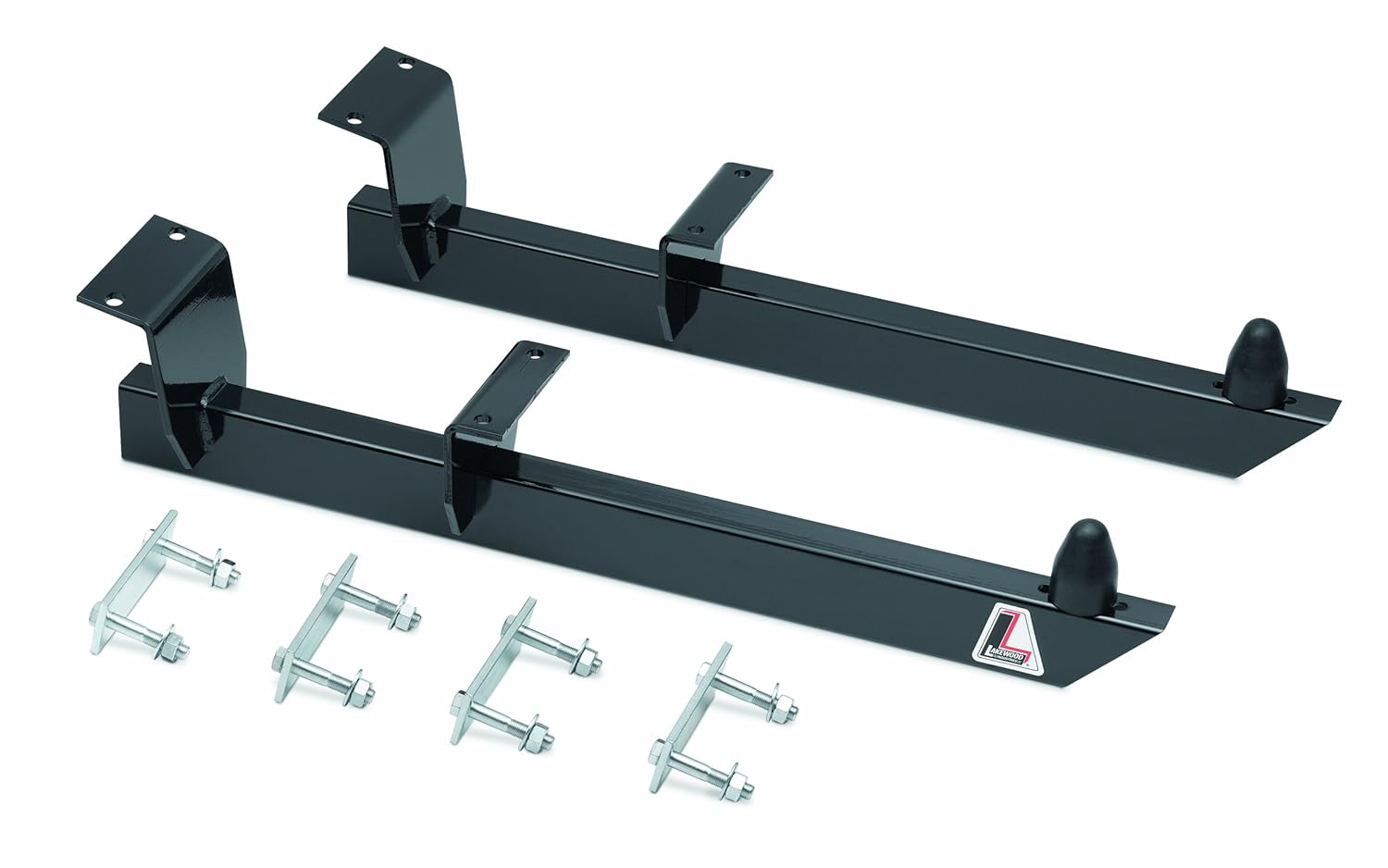

I can tell you what doesn't work.
Lakewood 22026
They are meant for an 80+ truck. The angled brackets are too short to clear the rear axle, so you either need to bolt them to very large spacers so they fit against the leaf springs, orrrrrr cut/weld longer ones.

Torque arm
On a 4x4,, ground clearance is prime so it's the wrong application for traction bars that are shown above. What is happening is axle wrap... the axle is attempting to rotate about its axis due to the applied torque which causes the leaf springs wanting to form an "S"... the leaf springs spring back and the wheel hop begins. A torque arm prevents the axle from rotating.
