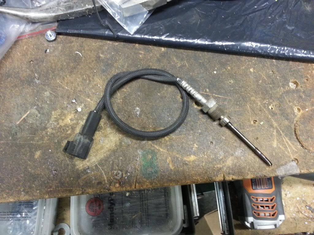

Stop safely
Originally Posted by darren32
Agreed, the stop safely now is usually one of these
Attachment 239661
IWas wondering if by clearing those codes with my CTS2 and replacing all four of these probes should my truck start or am I wasting my money because it currently will not run for more than five seconds?

EGT 14 is the one that shuts it down. What code do you have? There is also a recall for those sensors.
