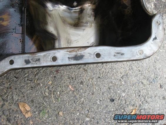

Here's the ridges around my bolt holes ground down flush. The older style oil pan uses those ridges to seal around the holes. The 1 piece 89+ era gasket has its own compression rings built into the gasket, so you don't need the ridges anymore.
Not sure on the o-ring. I don't think my dipstick has one, unless it's up in the handle. Usually, if oil is coming out of the dipstick, it has more to do with a bad PCV valve.
Only torque the oil pan bolts to spec. It won't feel like they're getting nice and tight, so it can be tempting to crush down. All you do is destroy the gasket.

Thanks for the reply and the pics. I was picturing something else when "ridges" were mentioned. That'll be quick work with the grinder. I have an inch-pound torque wrench so overtightening won't be a problem. I think while the pan is off I may change the rear main as well.

Glad the pics helped. That's all the ridges are. They're a cinch with a grinder. Usually about 10 minutes.
