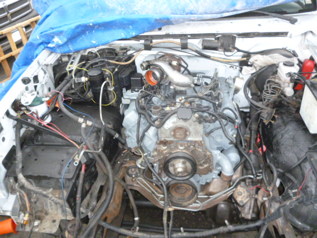

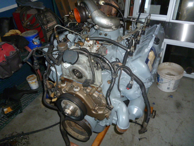

You can get the engine in with the turbo on it. It is about a thousand times easier than putting it on after.
Here is how mine went in. of course I had the core support out so it was about One hundred thousand times easier!!! I swapped my 93 motor with the sidewinder on it and the e40d still bolted in, with the core support in place. It just takes a lot of wiggling!

4x4,
My 94 was a factory turbo, and it went in with a slight tilt back and some effort, but that was with just the turbo, no piping at all. I put that on afterwards.
