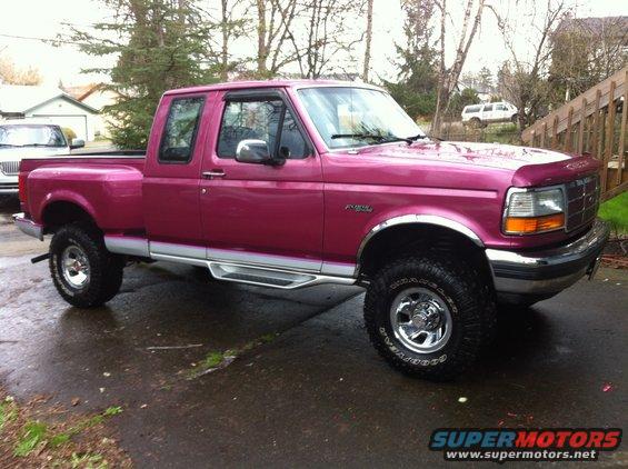

I used this stuff called Gord's Polish about a year and a half ago. My rims were covered with corrosion and brake dust. You apply it using #0000 steel wool. Works amazingly. I haven't applied another coat since the first time I used it and my rims still look as good as they did when I first applied it.
This is before the polish:
Right after:
And as of yesterdays washing:
All I do to clean them is hose them off. That's how well the stuff works against brake dust.
And to top it all off, here's a video of the stuff being used on a wheel like ours:
And yes, it does work that good.
