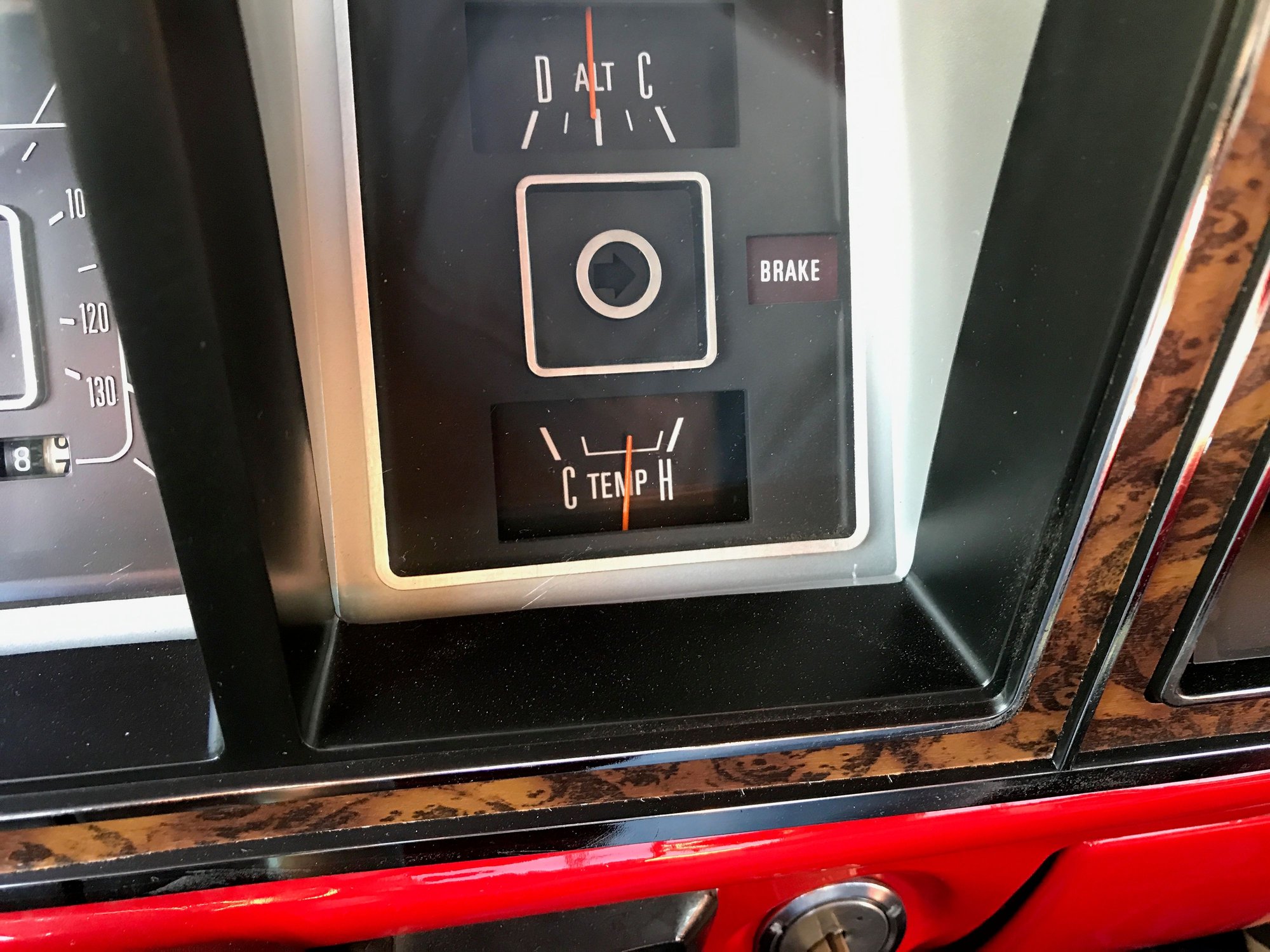

Drove the CC yesterday all day in the nasty Bay Area traffic and my engine temp never went above this (Picture) which translates to around 180 degrees (According to my radiator thermometer) and has been rock solid no matter what my driving conditions have been. Before I would have fluctuating engine temperatures. This has been a dramatic improvement so far.

Awesome work for sure!! I love my efan upgrade as well. Best mod so far, imo. It's crazy how much noise a mechanical fan actually makes. If that is where your temp gauge sits for 180*, I must have a 160* tstat. My needle never goes further than the "E" in TEMP. It also never steps up in the 2nd speed.

My gauge stays right here. Btw, it was 80° today here in CT.
