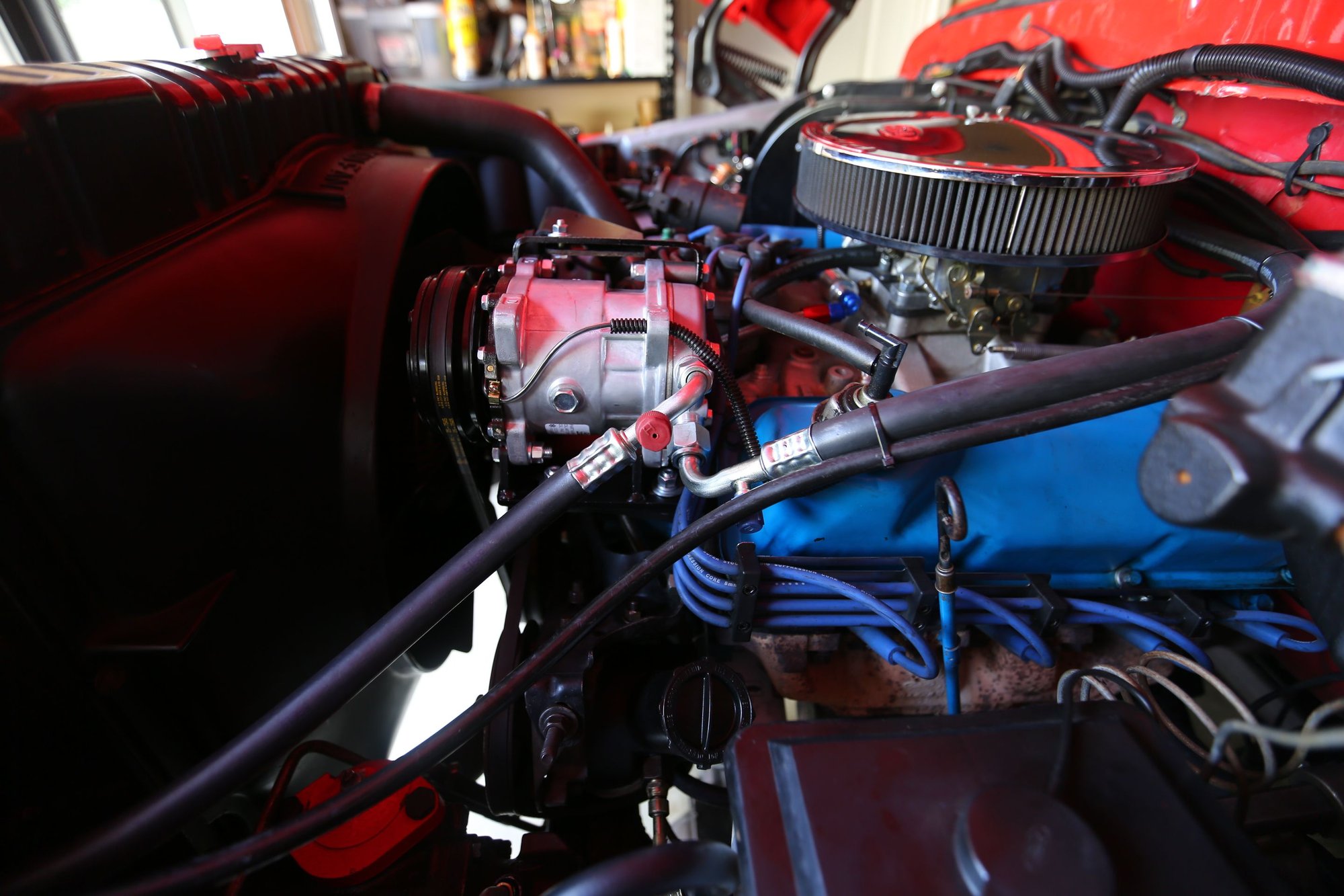

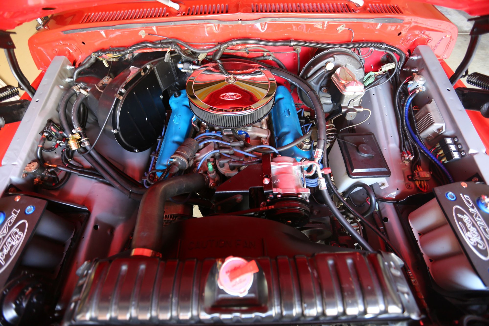

Finished up the HVAC rebuild project and now I will have to get it charged to see if it blows out ice cubes. The heater works great and the new fan is nice and quiet. I used Back to Black to bring the plastic plenum back to its original luster. I still have a few little things to do like make a better top bracket that supports the idler gear bracket to the top of the compressor and find out why 2 of the 4 bolts that bolt the bottom compressor bracket to the heads don't thread easily.
I had some clearance issues with the fan so I moved the compressor back slightly until I install a spacer for the fan -Or- maybe go electric fans. I'll have to ponder that one.

Looks good! Hopefully it cools as good as it looks and you'll be in business this summer.

Looks good, very nice setup for a very nice truck. I have to order my A/C components, I have the dealer installed a/c but no compressor under the hood. This is a good thread to follow for options. I will make sure to do a thread when I do mine.
Good lord that's close. Too close for my pucker factor. I would definitely look for a Mark VIII fan to swap in. It's very easy to do and a lot more bang for your buck compared to other aftermarket e-fans, plus it will give you at least two more inches away from your compressor.
Yes defiantly going to be looking into the swap. One thing is going to be how its going to look, its gotta look really nice so I'll be looking at other threads and getting some ideas. Also I don't want to have a switch to go into high speed. I want the system to be totally automated and transparent.
The close proximity of the fan was very high on my pucker factor as well. I was able to pluck the seat buttons off. After I shot that photo I did move it back a little more but it miss aligned the belt slightly. More to come on this subject....
